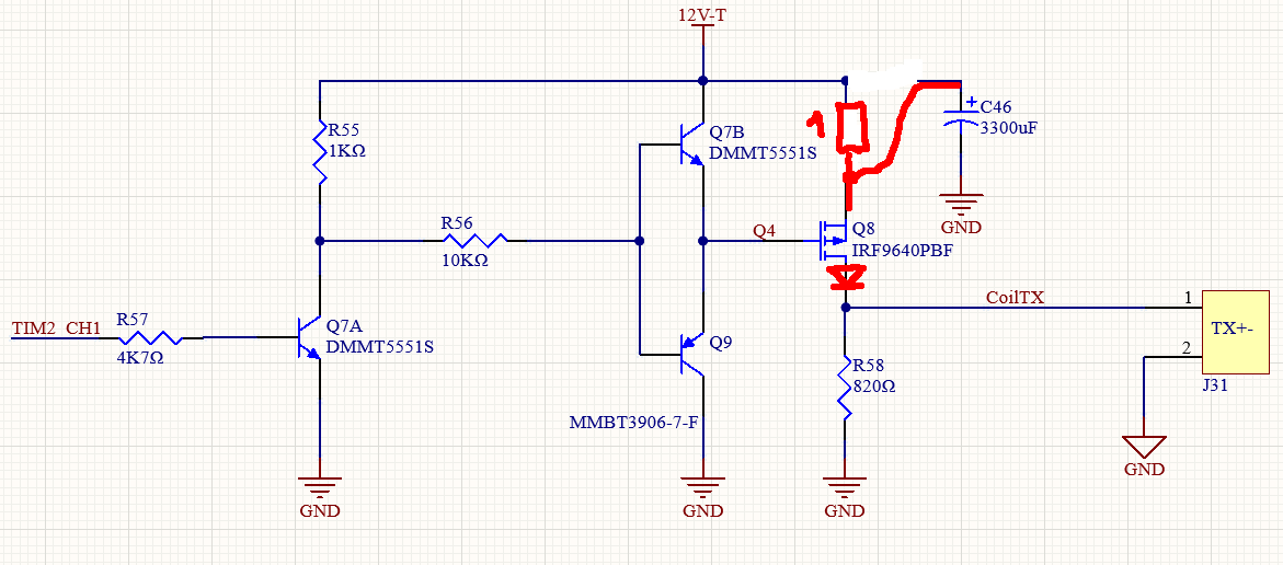

Is IRF9640 the best choice for a high-side switching topology?
    i just transfer part from N-channel in P-channel view. nothing new here. but if you do not see... i draw
      What's the purpose of the 1 Ohm? Just for current limiting?
              The diode will not help at all with the avalanche issue. Remember that on a P-drive TX the flyback is negative. This application of the diode is normally used to reduce the effect of MOSFET capacitance, which is not the issue here.
              You normally use a super-low ESR cap with ~1Ω to the supply. This helps guarantee that the cap, not the supply, provides the turn-on current. During the off time the cap recharges.
                  Hmm, the original design had this but I removed it because the resistor was a constant point of failure. 1Ohm and 3300uF also forms a 50Hz low pass filter so I assumed it was for filtering purposes. I think that my only option is to just source a P-Channel FET with higher breakdown, although the flyback voltage seems to be much higher than what's possible with a P-Channel FET i.e. following the angle of the flyback, it looks like it would settle at around 800V. The best option seems to be the IXTX32P60P with -600V but it's crazy expensive compared to most other FETs!

                      It's hard to extrapolate the peak because the flyback rounds over (it's an RLC response). The mathematical peak of the flyback is
                      Where I0 is the peak current at turn-off and RD is the damping resistor value for exact critical damping. This comes to about 600V/amp for RD = 820Ω. If you use, say, a 600V PMOS and the flyback still clips then that is still better (less heat) than clipping at 400V.

                            Adding a series 5Ω resistor reduces the coil current, which is the opposite of what you want. Then, you have to increase the pulse width just to get back to where you were, at which point the FET will be just as hot.
                            The only practical way to deal with this is to use a higher breakdown FET to avoid avalanche. However, the flyback energy still has to go somewhere, and what you will find is that R58 (damping) and the input clamping resistor will get hotter.
                            The IRF9630 will not help you here, it has the same breakdown. If that was not the issue, then it would help reduce the FET capacitance and make recovery a little faster. I don't know where KT is suggesting to add a diode.
                            I agree that doesn't it makes sense to introduce a series resistance that reduces the back EMF to a value closer to what the FET can handle i.e. 600V -> 200V, as theoretically with a fixed coil design, one could reduce the pulse width and therefore reduce the energy in the coil (or reduce the FET turn-off i.e. decrease the slew rate). So I can't understand why the original designer of this PI transmit circuit would included a series (R27, R2 resistance between the switching element and the coil. Why not just reduce the pulse width? The coil connects to points (5) and (6)

                              Have you tried a MTP2P50EG? This PNP MOS-Fet has 500V and a RdsOn of 6 Ohms.
                                I believe that's an obsolete part now. I'd need something that has some kind of support from the manufacturer. Also, with an RdsOn of 6 Ohms, that would greatly affect the energy that could be put through the coil and I'd likely need to increase the pulse width substantially (like 5 or 6x longer).
