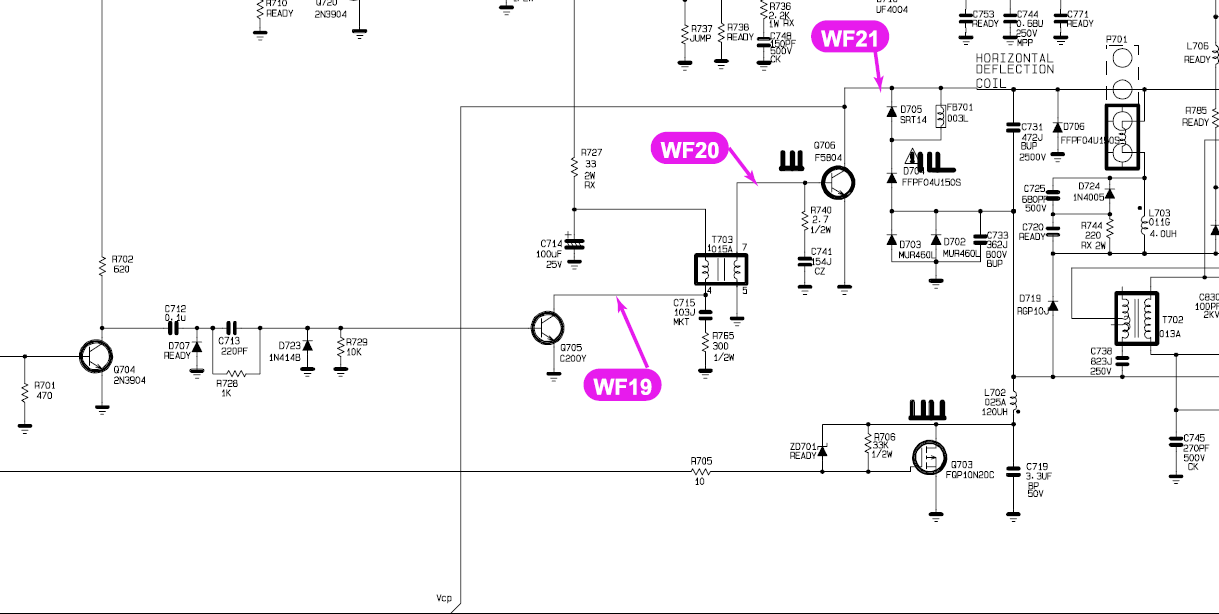

      3.Change TX circuitry
      use isolated power source for gate driver via transformer, replace IRF9640 with IRF740 and use optocoupler to drive it
      OR (not a good option)
      with little adaptation for MOSFET, drive it directly true transformer like all flyback transistor drivers do in old CRTs
      BUT maximum pulse width will be limited by your transformer

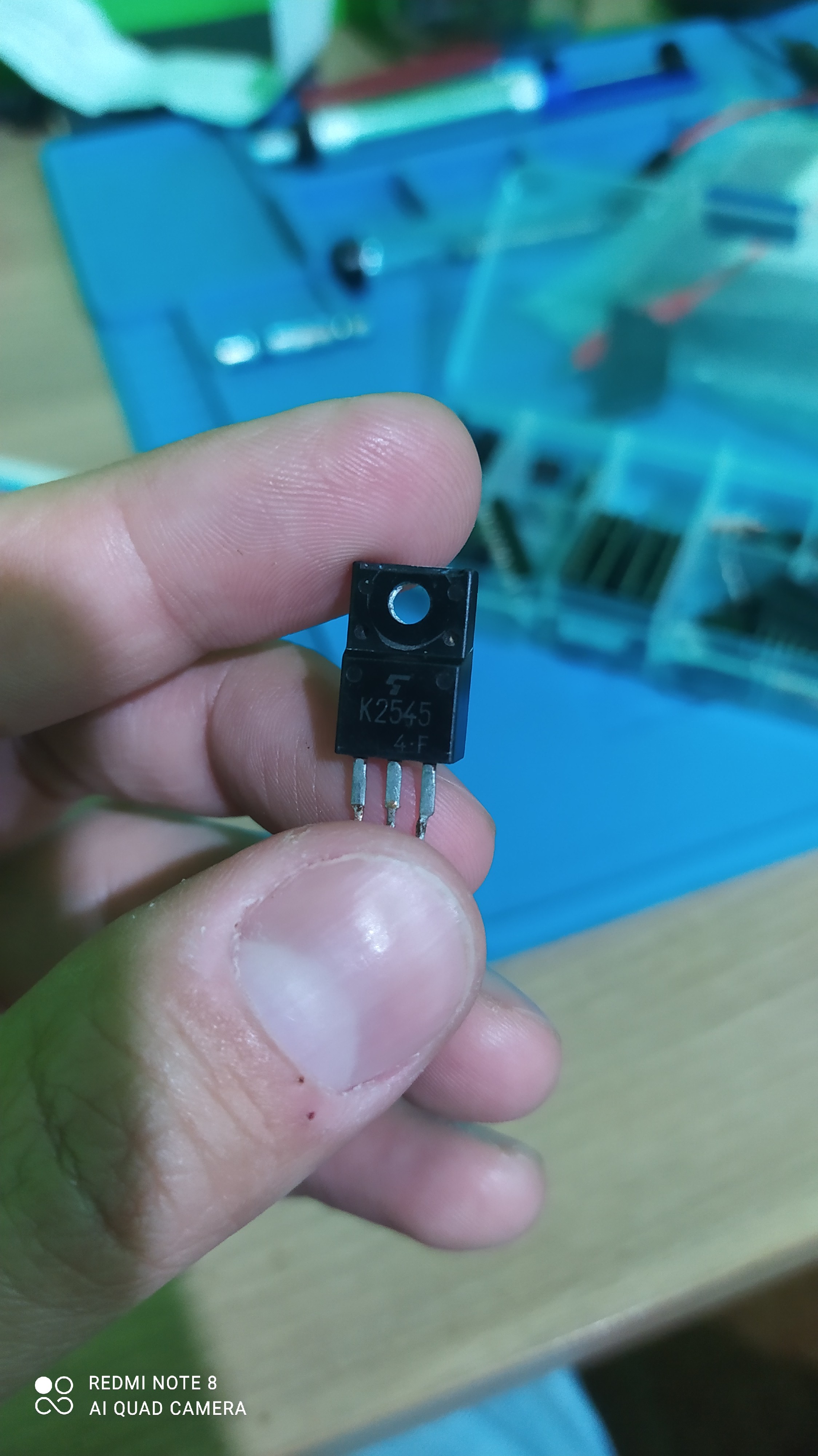

ID:	414351 I'm using Toshiba's K2545 in all my RDSon 0.9ohms 600V projects

          1. This MOSFET looks like a good option. Better VDS but slightly lower avalanche energy ratings and double the RDSon (No idea how much an ohm or two would affect the thermals)
          2. Googling the part number gave https://www.infineon.com/dgdl/Infine...5356110a7d1d95 which doesn't match what you're stating at all?
          3. I intend to do this for the next revision in the distant future. The current version is powered from a 24VDC SMPS and the recovery curve is digitised by an ADC of 0V -> +3.3V so everything was kept with positive voltages. Next version I'll create some negative voltage rails and go from there for op amps and the transmit voltage. Presently though, I'm stuck with the design I have. My only option is to change the part.
            This appears to be an N type? Not sure how suitable it would be for a high-side configuration without a lot of extra work. Plus, it doesn't look all too common either.

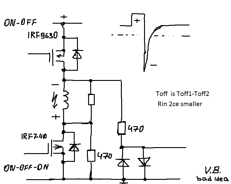

                          l may be wrong, but my idea to use IRF740 as aditional switch at the ground side
                          Click image for larger version  Name:	TwoTransistorTX.png Views:	0 Size:	24.3 KB ID:	414380
                          I guess this TX will switch-off faster but IRF740 output capacitance must be lower than 9630 better twice time lower
                          MOSFET at low side will get half off flyback voltage if it output capacitance be equal with 9630 ​
