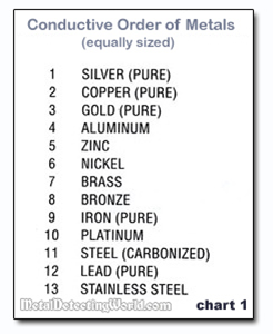

      I been using the 5mm and 10mm squares cut from a aluminum beer can. But aluminum thickness and grade will vary from can to can. I had an idea for standardize targets. We could make them using a pcb. Draw up board with multiple geometries and sizes. These could then be cut into separate targets and glued to wands. This would create a standard gerber file that everyone could use. Assuming say 1 oz. copper, people around the world could test and compare results
      I forgot to mention that most of the pcb makers offer aluminum now. This may be a better choice over copper for pi work. Not sure on the pricing? I would probably order a set of each.

        I admire your idea for easy preparing of standard targets! This is chart of conductivity order of the metals
        The aluminium and the copper are closest to the gold but maybe PCBs from copper will be more cheap.
        • After looking a little closer JLC offers an aluminum substrate with a copper surface. So the aluminum does not get etched only the copper. These boards are meant for heat dissipation.So this idea of using aluminum pcbs is out.
          @Detectorist, copper is not a good test replacement for gold, but copper could be used as a sensitivity gauge by different sizes. For conductivity you can make a few turns of fine magnet wire about 30mm dia. and connect in series a low value resistor. TC = L/R
          • Any metal -- aluminum, copper, silver, lead -- can be used to create just about any tau you like. You only need to get the right dimensions. With extremely thin metal (aluminum foil or PCB copper foil) low taus are really easy, high taus become harder due to the thin metal. I stack aluminum foil in thickness for higher taus. Otherwise, you have to make the target bigger & bigger to achieve a higher tau and it's a diminishing return.
