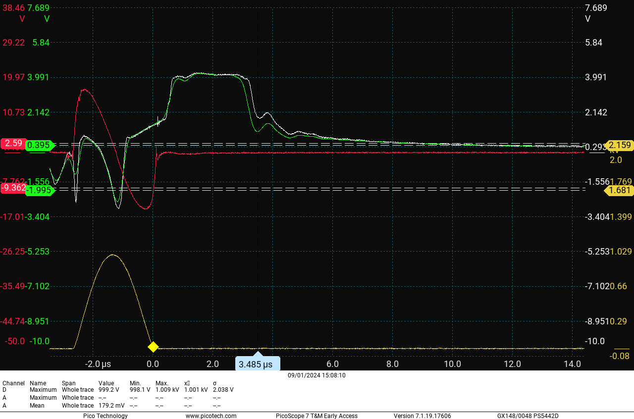

    To be able to detect a target with a TC of 1us (one microsecond time constant), with a PI detector, we need to take a very early first sample.
    A TC of 1us means that after 5us the eddy currents are gone.
    With a delay of 3us we should have a chance to still detect the 1us target.
    Click image for larger version  Name:	Clipboard_01-09-2024_01_foil.png Views:	0 Size:	84.2 KB ID:	418898
    This picture shows the response of a square of kitchen aluminium foil of 25x25mm on the coil.
    The yellow trace is the Flyback.
    The green and white traces are the output of the preamp, no target and with the target.
    The cursor does not show on this picture, but we can see from the indicator at the bottom, 3.485us, that we could start the sample at this time.
    This is done on a bread board and with a half finished DD coil with a sweep diameter of about 37cm. Please take that into considerations when you see the noise.
    I would much appreciate your input for trying to improve the setup. The idea is to start a discussion and to try all good ideas to improve the results.

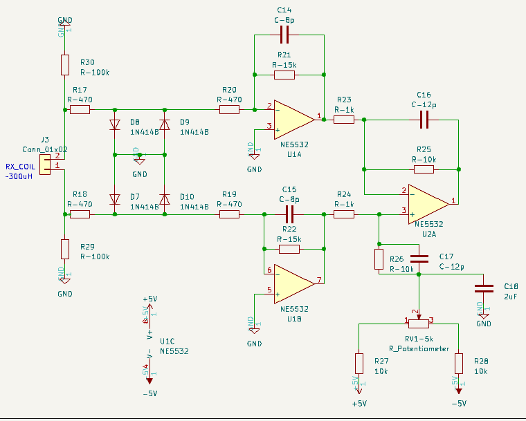

    This is the preamp used for the scope shot above. Click image for larger version
        Good experiment!
        When sampling at low delays, some of these things come into question, that would not at the longer or normal delays.
        1. Eddy currents being seen in parts of the coil wire.
        2. Solder joints in the coil housing that connect the coil or coils to the coax wire going to the control box.
        3. The damping resistor value is determined by the total amount of the coil seen capacitance much or which is parasitic capacitance.
        The oscillations that occur after the TX pulse turns off are due to the total coil seen capacitance which needs to be fully damped before the RX circuit can be turned on. Lower damping resistor values are required for higher coil seen capacitance coil designs. Now comes the real design challenge, lowering as much coil seen capacitance as possible to get a higher damping resistor value and a fast coil. A fast coil will approach your design goal to sample very near 3us to detect your small low TC target.
        Here are the places in coil design to look at first. Having a good signal generator and scope setup in necessary to measure the coil resonance which reveals the coil seen capacitance. Here are the design places to start considering. Also, the dielectric constant of anything near the coil wire will affect the coil seen capacitance so look for stuff with lower dielectric constant values. Based on my experiments done to do my fast mono coil paper, the coax wire capacitance places about 100 pf of capacitance on the coil. I have played and designed guitars and found that the 10 foot cable between the guitar and amplifier adds about 300pf to the coil inductance to change the resonant frequency in a very audible way. I came across a web site “till.com” where Tillman designed a FET buffer-amplifier that fits in the guitar end of the coax cable plug that puts a multi meg ohm load on the guitar pickups without them seeing the cable capacitance since the FET output is a low impedance. Then I thought how his concept may help a metal detector coil to not see the 100 pf cable capacitance. This means that a creative way to place the minimal amount of active and passive electronic components in or near the coil can eliminate or deeply reduce coil seen cable capacitance and allow a higher damping resistor value.
        Here are some ways to lower coil seen capacitance.
        1. Teflon insulated wire to make the coils.
        1a.Use either fine stranded wire or AWG 30 single strand wire coil wire.
        2. Low dielectric constant spacer from coil to shield.
        3. Reducing the area of the shield by using Scotch24 wire mesh for a shield.
        4. Reducing MOSFET seen capacitance by adding a series diode to drive the coil.
        5. Placing active electronics either inside the coil housing or very close outside the coil housing to reduce coil seen cable capacitance.
        I hope this post stimulates others to jump in and share more information to sample low TC targets better.

          Sounds like a job for a charge coupled amplifier to eliminate cable capacitance.
            Detecting a 1us target with an IB coil is not nearly as difficult as with a mono coil, and the things you do to get there might be quite different. For example, fighting for every scrap on the TX side is not as beneficial.
            In both cases, the clamp diode recovery time can be a significant contributor to the overall preamp recovery; in an IB system it depends on the high frequency null. I would place all of the resistance in front of the diodes, and probably increase it to, say, 3k or so. Leave the first stage gain at 5, it will help recovery time. The NE5532 might need to be replaced by a faster recovery opamp.
            You might find that adding some capacitance in parallel with the RX coil (along with a damping R) will slow down the turn-off transient and spread it out in time. The goal is to prevent the preamp from saturating in the first place. This will also spread out the target response, making it easier to see with a later delay than you would expect. Another option is to increase the feedback cap on the preamps with the same effect. I've done this in PI designs to effectively see faster targets than the sample delay should allow.

                ZP damping easily does 1 us detection. As I have said in other threads you have to move away from the damping resistor.
                The red trace is coil damped with ZP.
                The blue trace is damping resistor ( old school ).
                The green trace is the preamp on ZP.
                The coil with the old school damping resistor is still sitting a 50ma residual whilst the ZP is sampling happily at 2 us after turn off.

                    A two-stage differential RX is a good approach. Small gain too. The smallest possible offset or the possibility of additional offset adjustment.
                    We want the best possible S/N ratio and very fast RX with a wider range until the saturation.
                    LV/LP type opamp is preferred here.
                    I think (need to check) that both NE5534 and OP37 also exist in LV/LP variants.
                    If not, then surely there are adequate substitutes.

                      Carl has given very good advice. Actually, I will use Carls AMX schematic for the next frontend test. There I can show on a real circuit, on the scope, How the various experiments with damping behave and what the results are.

                        any questions you might have about = can you increase gain of U2 and remove U1 a/b ?
                          Hi Carl,
                          Please, comment this text from the book for engineers:
                          So, Schottky diodes do not have reverse recovery time because they do not have anything to recover from. However, the vacuum is effectively acting as a dielectric in one direction, so there is some small amount of parasitic capacitance. The reverse current seen in Schottky diodes is not actually reverse conduction, but merely a capacitive discharge. This is why Schottky's are said to have 'soft' recovery, as the curve is really just a capacitor discharge curve, and that takes time. But it is not 'on' and allowing reverse current flow. All the current flowing in reverse is due to energy stored capacitively from the diode itself.
                            This is the reason I use low signal BAT48RL Schottky diode with 7A peek current in my PI projects
