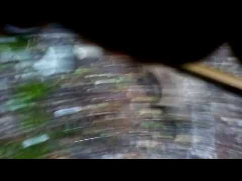

      And this is the typical response of a VLF I/B detector on about 85% of such surfaces.
      In the video is XP Deus with HF22.5cm coil. (New coil, so I wouldn't scratch it; I wrapped it in nylon).

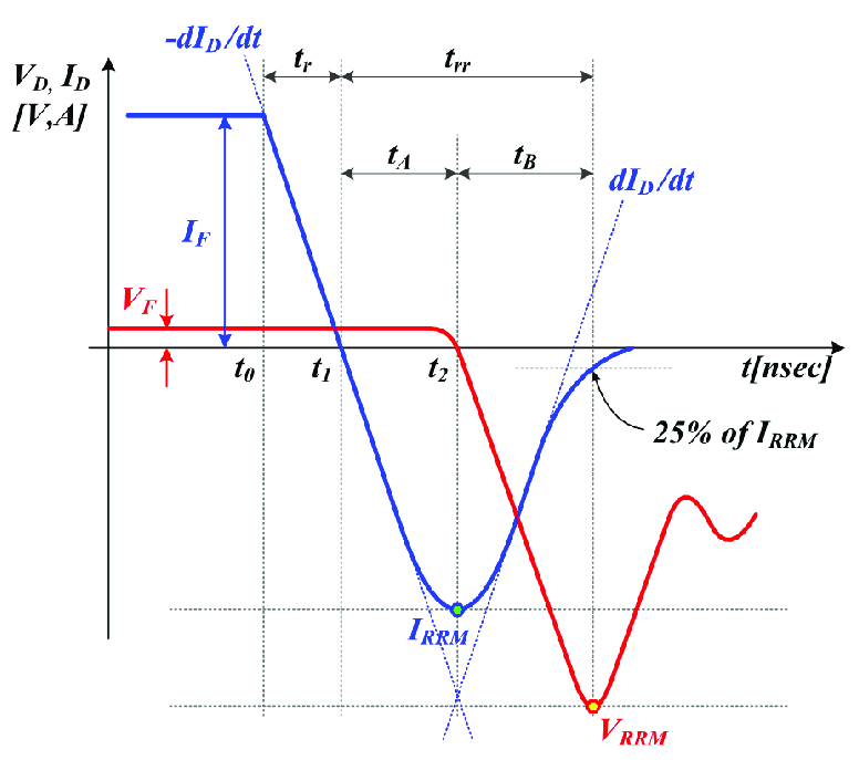

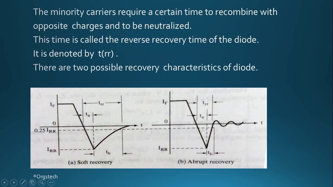

                              Hi Tinkerer,
                              These diagrams can be found in every popular book for diodes.
                              But, in PI MD, the situation is different - clamp diode at input haves not reverse voltage at the end of the TX pulse.
                              In this case, for discharge of diffused capacitance helps only safety resistor and timing diagrams are totally different!
                              See post #27
                                Hi Tinkerer,
                                See post #27
                                Indeed, the diode reverse recovery graphs and explanations can be found everywhere on the net. What matters for the PI, is what we are interested in.
                                The way I understand it is: the clamping diodes at the input of the opamp discharge a part of the current in the coil. It is the
                                IF, the forward current that matters. The higher the forward current, the stronger is the reverse recovery when the current stops.
                                We use the input resistor to the opamp as part of the damping. This input resistor also limits the current that discharges through the clamping diode.
                                A soft recovery, like the Schottky diode, takes longer but is softer. It does not matter what the actual physical process is.
                                A very fast recovery often causes oscillations until the final settling.
                                Some datasheets give the recovery time.
                                In the end, there so many variables involved, that only actual real components defined by testing will show which is the best frontend for a specific purpose.
                                That is the way I see it. wrong? or right? I am always willing to learn.
