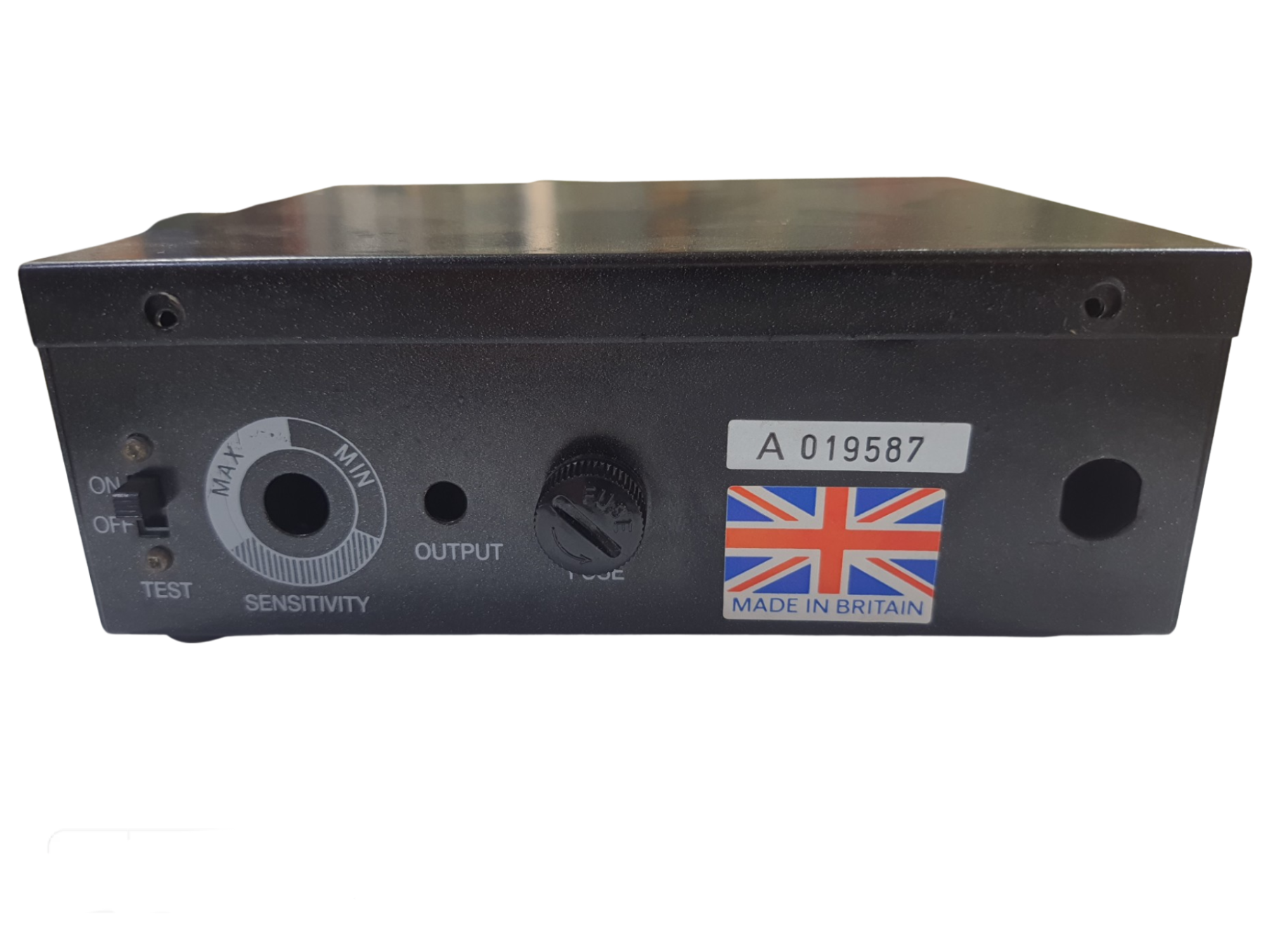

    if i can use a metal enclosure for my pcb and battery like the picture or the intererence effect detecting

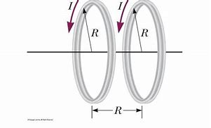

    for animal (caw) = you need these transformations.
    Metal box is ok.​
    Click image for larger version  Name:	image.png Views:	4 Size:	141.8 KB ID:	420595Click image for larger version  Name:	image.png Views:	3 Size:	10.5 KB ID:	420598Click image for larger version  Name:	image.png Views:	3 Size:	30.2 KB ID:	420596 Click image for larger version  Name:	image.png Views:	3 Size:	10.5 KB ID:	420599Click image for larger version  Name:	image.png Views:	3 Size:	15.0 KB ID:	420597​​

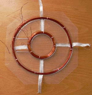

            Somewhere on the forum I wrote an extensive post with the story.
            Ah, now I think I remembered, on the PS2 topic.
            In short; our country imports these detectors for the Ministry of Agriculture from Germany.
            I tested one... total failure, despair, misery... very bad and "shallow"!
            A professional veterinarian approached me for help.
            He brought with him a bunch of various metals extracted from animals (mostly cows) during operations.
            That was at the very beginning of the "lockdown" at the beginning of the Covid crisis.
            At that time, due to circumstances, I had a bunch of different detectors in the house.
            We tested all the detectors for those pieces of metal. NONE met the criteria.
            And then I tested the Pulse Star 2 with the 18cm coil.
            Pulse Star 2 delighted, it showed results 30% better than the set criteria.
            So the vet bought from me that Pulse Star 2 with an 18cm coil. He still uses it to this day.
            I keep 6 cats in the house, from time to time the same vet visits me to vaccinate the cats.
            And I always ask him about his experiences with that detector.
            He is very pleased.
            There is no need to develop various dubious theories about such a detector.
            Any slightly better PI detector with a small coil will do the job.
            FelezJoo is more than good for such a task. BUT it should be done well, especially the coil.
              I have found it on my channel, this one was the first PS2 I made, the vet bought this one from me:
              (but he painted it with spray paint in green color!!!) hahahahahahahaha!
                This is the very first test with random micro coil, without discrimination board:
                (Of course, with proper 18cm coil it works like a charm! Extreme "depths", twice deeper than lame Germany detector)

                          about the metal box do i have to change it or it ok to put the pcb and the battery inside beceause i couldn't find any plasti enclosure and i dont have 3d printer
                          thank you for your time
                            I don't see any problem with that.
                              Metal box is fine.
