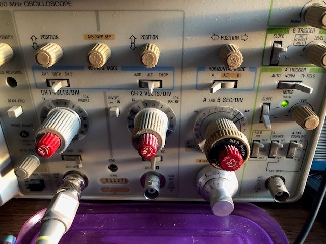

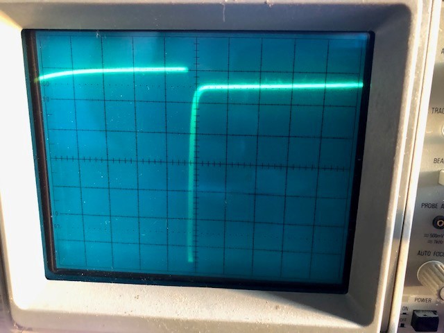

      I also tried to set the damping resistor; according to the original drawing it is 2.2k. I checked it with my tektronic 2215 and found out that the thing starts "clipping" at approx. 1.6k, the damping resistor is now set to 1.8k.
      The scope is set somewhere betweem 20 and 50uSec.
      the lower base before the rise is not traceable with my scope - as far as i can say; i can not strech it further. But when using smaller resistors than 1.8k, there was a peak after the slope.
      Measurement on pin 10 of U2 CD4538BE is between 20 and 50uSec

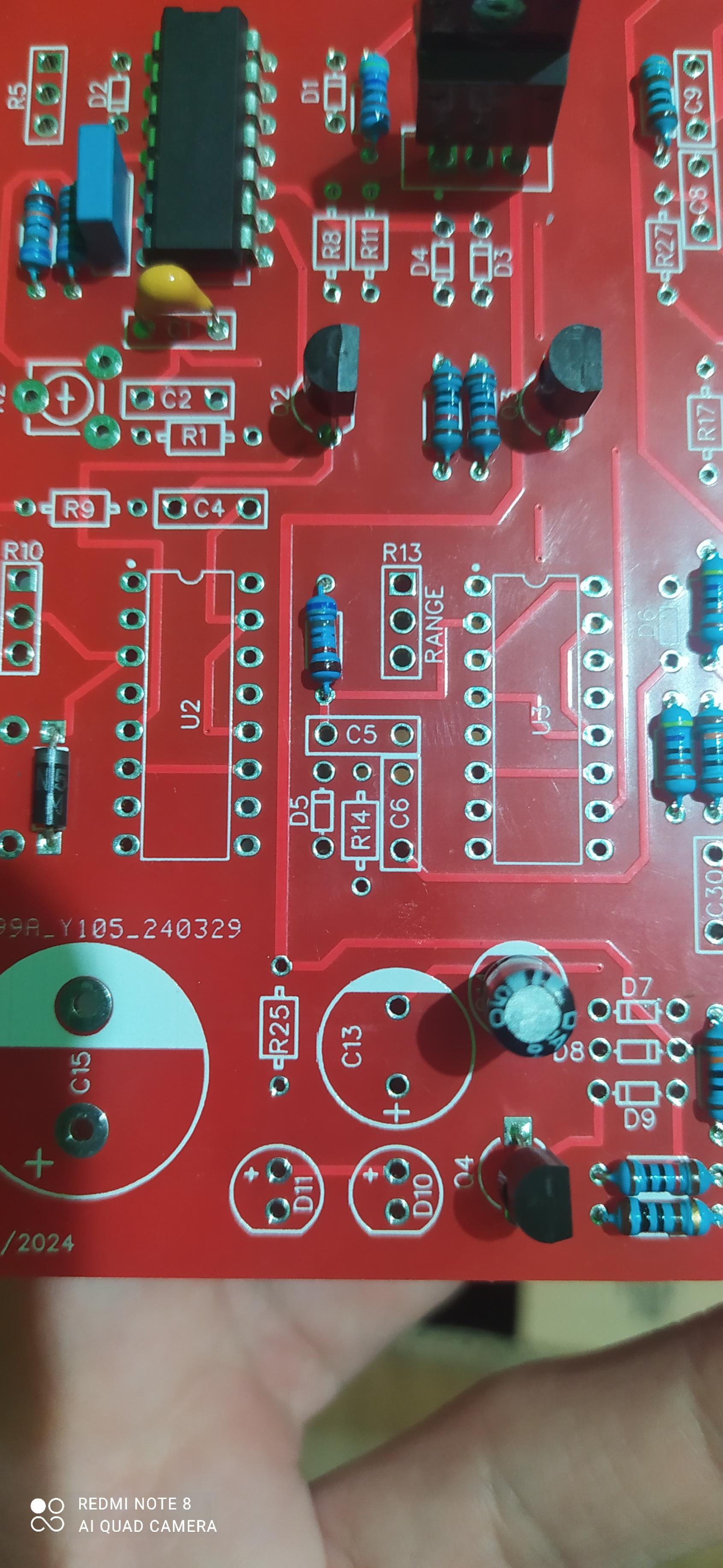

            I will have to check if i find 4.7nF (i think this is what you are suggesting) in my tube amplifier component collection; most probably not polyester but maybe PTFE, PP ore something else (of course no standard capacitor).
            Can you please identify C6 on the pcb for me; by drawing is not goof enough to read it and on the pcb it is no possible ti identify the cap is not (there are several 1.5nF)
            What will the improvement and effect be like when I replace C6 (according to schematic 1.5nF) with 4.7nF?
            • #51
ID:	427095 between U2 and U3 next to R14 is C6
                  thanks a lot Emerson, i really appreciate your help

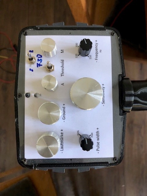

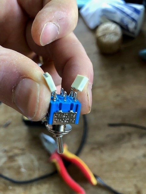

                    I replaced C6 1.5nF with 4.7nF as proposed by Emerson.
                    The 2 caps are fixed on a toggle switch, so that it is possible to choose between the 2 first sample delays.
                    it is remarcable; the longer delay also leads to some better detection distance in the air tests.
                    Sorry for the flimsy detector cover; i had to use material that was available in my office and laminated some printer paper. For the FSD switch I havent found the time to adapt the cover.

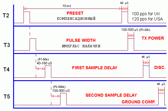

                    • #55
                      ok. you just move SECOND STROBE at right side on axis X. representing axis X and axis Y on flatness, also here is DELTA PULSE pattern curved line inflicted.
                      delta is a symbol of Greek alfabet, so present it yourself. THE FORM like the symbol. we say DELTA impulse pulse signal.
                      we say also reverse pulse.
                      you move SECOND STROBE in a range with low amplitude of the DELTA.
                      Carl will say more be cause english is not my native. anyway, you may read all info in ITMD.
