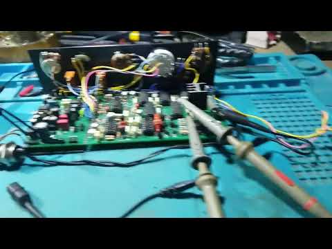

            thanks a lot for all your feedbacks, i will put the detector on the bench in the next days and check it with the oscilloscope, change the resistors discussed above, tune it accordingly and then redo the airtest.
            Feedbacks to improve the layout are always welcome.

                Hello Ivconic and Kt315
                thanks a lot for clarifying how the oscillogram of the pulse should look like; changing damping resistance until no spike in the plane after the drop before the rise, the rise as far left as possible before a spike appears
                Thanks a lot for your help

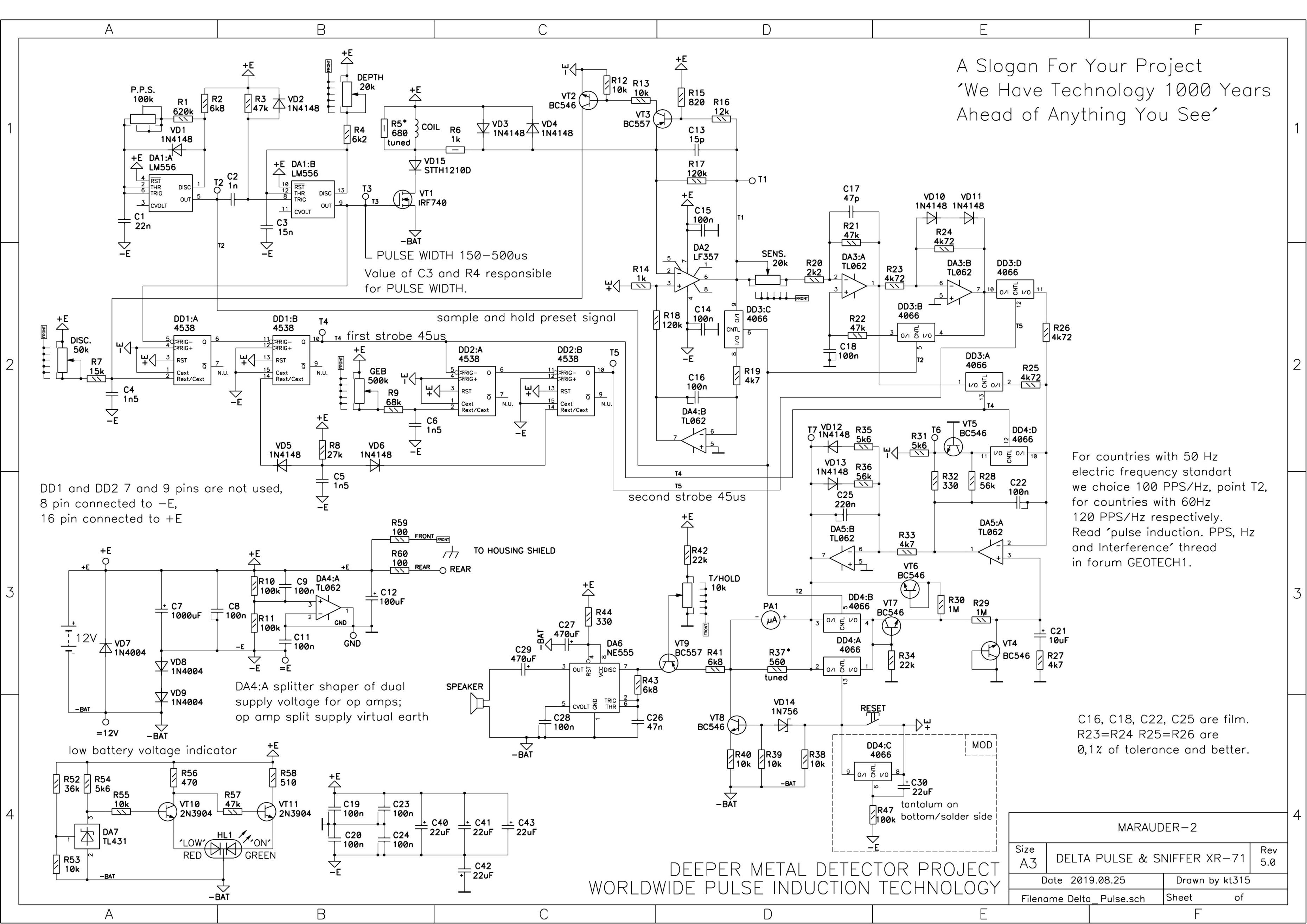

                        PULSE WIDTH pot. in sch it is 20k, but what he does i do not understand.
                        • #42
                          The trimmer for the "power" according to the NH-173 schematic is a 20k trimmer (R2), and for the frequency it is a 200k trimmer (R5) and a fixed 680k (R4) resistor (880k in total if both replaced by one poti).
                          I used a 1M Stereo-Poti to replace them both on one poti with resistors in parallel (to come close to the original resistance) and one in series to have a minimum resistance.
                          Therefore I asked (some posts ago) if higher frequency should come with lower current ("power according to schematic naming), or vice versa.
                          Carl informed that high current with high frequency could be hard on the components.
                          This was the reason to think about the following:
                          increase of frequency should come with a certain decrease in current ("power") to no overload the components. And since this is not assured when using a separate current (Power) and frequency pot, i thought about using a stereo-pot to ensure that frequency and current are controlled by one single potentiometer.
                          I will read the Delta Pulse thread (eventough i have not yet understood the direct link to the NH-173). If it is exactly the same schematic, why should one rename a product... well, I will see as soon as i read all of the tread. -> thanks for the hint.
                          • #43
                            frequency is fixed. 100 PPS for DP and 300 PPS for Sniffer XR-71. if you increase the freq in 3 times you get increase in current in 3 times.
                            you can read at sch why frequency fixed.

                                So R2 on the NH-173 schematic correlates to pulse width (called power by the schematics creator). I agree, as long as a trimmer is used a s R2, pulse width is fixes, the same goes for frequency (R4+R5).
                                But when you use a Pot instead of the trimmers, you get variable pulse width and variable frequency in a certain range (linited/defined bay the resistance range - agree?
                                I also registered the increase in the uA as you write, you are right.
