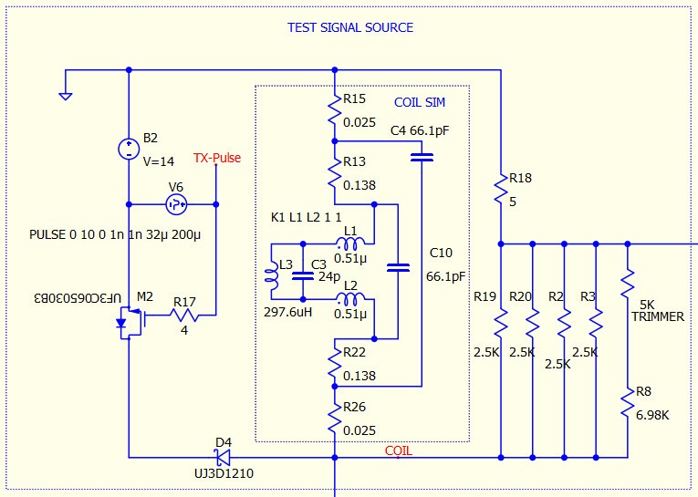

    The test signal source that I use in the simulations should be fairly close to a CoilTek Elite nine-inch flat wound mono coil. Most values were measured after disassembly of one of my coils, some are estimated and the carbon covered paper shield was ignored. The schematics may have some comments that I felt were important to remember while running the simulations. The plan is to progress to the demodulated output signals.

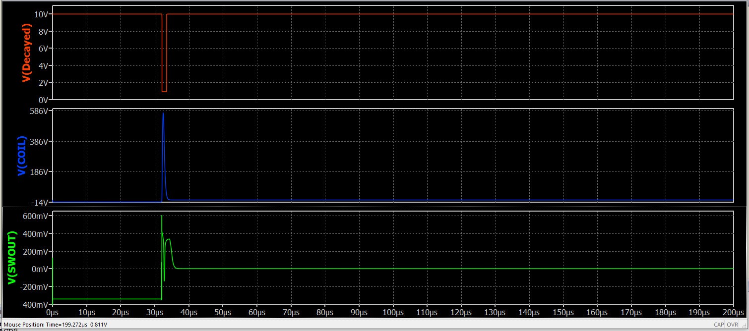

    ​Here is a picture of the outputs of the part 1 signal source using a 100% diode based transmit - receive switch. It will be the circuit that I plan to use. I will post schematic shortly.
    Click image for larger version  Name:	SignalSourceOutputsDiodeSwitch.jpg Views:	0 Size:	202.2 KB ID:	428430

    Here is an additional picture of the circuit with a 100 % diode transmit - receive switch that I plan to use but at the micro-volt level to show the DC offset of the output of the switch. It contains my sine wave test signal as shown.
    Click image for larger version  Name:	SWOUT-DC-OFFSET--8.59uV.jpg Views:	0 Size:	181.6 KB ID:	428432

                              Temperature changes can cause a greater damping shift than 1 ohm of damping resistor change. For lowest flicker noise, use metal film instead of wirewound. Be careful using pots in the damping resistor, prolonged exposure to high flybacks can burn the sliding contact.
                              I agree that trimmer pots in high voltage circuits can have problems as you describe, but In the AGD25.1 detector they only have a adjustment range of about 27 ohms of the approximately 580 ohms required for damping. The simulation circuit is below my CoilTek 9 inch mono elite coils.
                              Click image for larger version  Name:	Coil-Sim.jpg Views:	0 Size:	85.6 KB ID:	431260
                              The voltage across the trimmer has been minimized. The four 2.5K resistors are all wire wound none inductive with a ppm/DegreeC of +/-20 and inductance of less than 1nH at 1Mhz. They could be replaced easily with Metal Film ones, and I have both types on hand. However none inductive wire wound are know to have the least amount of noise. I have used them in many tubed audio circuits for years and see no reason not to use them in this application. And in thinking in about the RF world, they provide a good out of band termination for the coil well past what is required frequency wise for a metal detector. Termination being a RF term for a proper load, damping in detector speak. Out of band meaning at frequencies outside its normal operating range.
                              If I were not to use the 5K trimmer that I specify I would replace it with my active circuit that can do the same thing but uses feedback and is also easy to adjust. I described and posted a diagram of how to do that in the past. Such a circuit can also use a simulated inductor using a OpAmp as a feedback element to accomplish the same thing. I think I also used a simulated capacitor as feedback in some testing.
                              For the AGD25.1 I decided to use trimmer resistors for the making coil damping fine adjustments. This is the adjustment that effects the ability to detect very fine gold by preventing over load (flat topping) at the final gain stage caused by peaking of the decay voltage. I have shown this type of peaking in a number of prior posted pictures.
                              I decided to use: DigiKey Part Number 987-1177-ND for the two trimmers. One 'selected' for mono coil and one for 'selected' DD coil.
