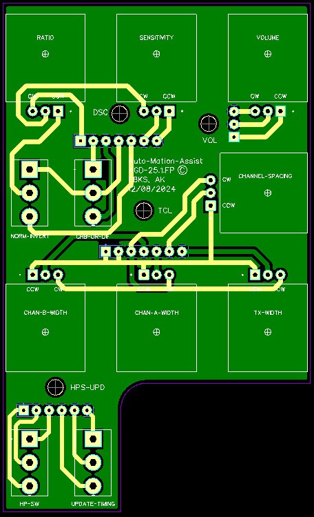

        Today I finalized the new circuit boards for mounting the parts that will be on the front and rear panels.
        The power connector and its associated on/off switch are separate and do not connect to the front panel circuit board. Wires are soldered to the in row holes from the front and routed through the black colored holes to the back side of the board shown. These wires will have pugs that route to various locations on the TX or RX boards. I usually use 24 AWG started wires from salvaged stripped 10 conductor cable which supplies 10 standard wire colors. The size of the front panel circuit board is 4 by 2.42 inches. Using this circuit board provides a reasonable attractive was of handing the wires and provides good flexibility to route the wires to the required sockets on the two main circuit boards.
        The front panel circuit board:
        Click image for larger version  Name:	AGD25.1-FP-PCB-BACK.jpg Views:	0 Size:	97.6 KB ID:	431330

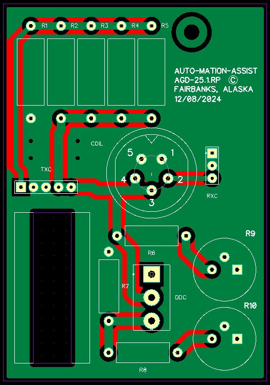

        The rear panel circuit board solders to the standard older five pin GX series connector. And contains all damping resistors and related switch for adding additional damping for a DD coil. This board has several 1 watt trimmers to handle the final damping adjustments. These trimmers are mounted on the other side of the circuit board so that they can be adjusted easily though holes in the back panel. These holes will normally be plugged by properly sized screws. A test point will be available to make adjustments without requiring removing the enclosure. The trimmers are 0.250 inch tall and 0.505 inch round. I decided to eliminate the TX/RX diode I mentioned in a prior post on this circuit board.
        The resistors I have chosen to use are quite large due to having higher wattage ratings than those typically used, and are none inductive wire wound types. It is not required to use these types and metal film types can be used as well. Some board space could be saved by using lower wattage resistors like the metal film types that handle part of the final adjustment damping towards the bottom right of the circuit board.There is a slot to hold the ferrite core in the TX path in place so it does not move around once a bit of adhesive is applied.
        The TXC solder points handle the TX signal, and the voltage sample for determining a the desired decay point of the coils decay wave form. The RXC connection point has one ground wire and two connections for the receive signal. These all route to the RX board. The rear panel circuit board is 3 X 2.1 inches.
        Click image for larger version  Name:	AGD25.1-RP-PCB-BACK.jpg Views:	0 Size:	101.5 KB ID:	431331
        I placed the order for these two simple boards with PcbWay today.

          Picture to the new rear panel circuit board.
          The 5 pin coil connector will be machined to allow the complete rear panel board to be removed from the actual metal rear panel. I have ordered a 16mm x1 tap and die set for this work and will use our lathe to do the required machining.
          Click image for larger version  Name:	NEW-AGD25.1-RP-PCB.png Views:	0 Size:	160.4 KB ID:	432586
          Here is a picture of the TX and RX boards plugged together back to back and the normal position that the rear panel circuit board will be in.
          Click image for larger version  Name:	RP-ProtoPcb-Test.png Views:	0 Size:	713.9 KB ID:	432587
          As you can see the TX wiring is heading it the wrong direction with the prop type rear panel circuit board.
          The switch on the rear panel board selects Mono or DD coil loading. DD has more coil loading based on my tests that show that my DD TX coils have less inductance than my Mono coils. However I'm not sure if that is always the case. I have Carl's Third Edition "Inside the Metal Detector" book but have not looked to see it it mentions the typical inductance differences between the two types of coils and how that affects damping adjustments.
          Also if you look at the 5 pin coil connector you can see the stop ring that is normally on the outside its mounted panel that need to be machined down to allow for threading the area underneath it. I added a ground wire to the outer shell of the connector for my prototype testing since there is no actual rear metal panel to provide the ground for the connectors shell.
          The new rear panel circuit board has the correct spacing for the connectors pins so that the circuit board mounts more closely to the connector. This will provide a better adjustment range for the switch and connector to the actual rear panel.

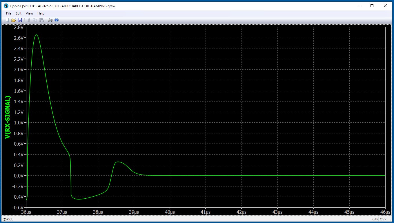

            The AGD25 detector underdevelopment has coil voltages very close to simulation voltage shown below.
            The 36us location on the bottom left is the point where the TX pulse ends. In order to detect very small gold the high voltage needs to decay as smooth as possible to zero volts no later that 3.8us from the 36us TX pulse end. By small gold I mean 0.015 grams at more than one inch or more during air testing, one inch means that it is good but not great. If we look at the flat line just before the 40us marker it looks real good but then the vertical scale on the left is not to good for looking at mV or uV levels so lets expand it to something useful.

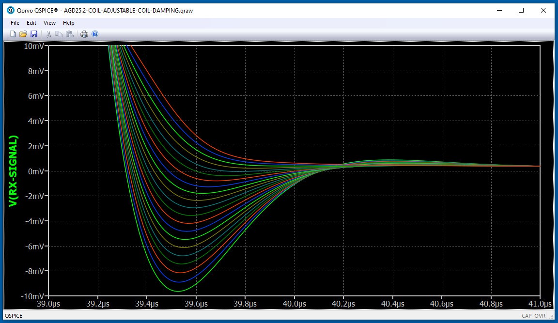

            This picture is the the same as the expanded parts of the prior picture between 39 and 41 microseconds. The picture also shows the adjustment range of the new active circuitry in five present steps. The goal here is to make the waveform flat near zero volts without moving the crossover point too far to the right with this polarity of coil decay voltage. In the picture above this occurs at about 39.6us after the TX pulse ends. Lets expand this a bit more to see the actual time frame available for the desired sampling period.
            I think that the best place to start sampling the waveform would likely be at 39.6us and ending at 40.2us. This is a short sampling period and analog gates following the RX pre-amp may have a slow turn on and thus not be able to pass the initial true voltage present for the first 100 or 200 microseconds. This can be avoided by starting sampling earlier but that may lead to circuit overloading due to the fact that the signal voltages rise sharply when moving start of sampling more to the left. If coil damping is not near perfect as possible circuit overloading can almost be guaranteed if your goal is to find small gold.

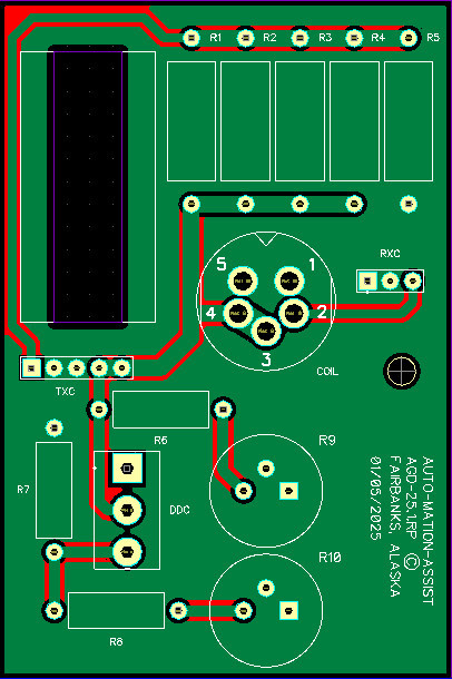

                And my proposed AGD25.2.ACTIVE.RP printed circuit board. Measures 2 X 3 inches
                  As you can see that many of my posts have to do with TX coil damping since it is very important to get this as perfect as possible, which in turn requires ways to make adjustments easily. The circuit board layout that I posted in my last post hopes to accomplish my desires. On this circuit board only the surface mounted parts are accessible once assembled because everything else is mounted on the back side including the ferrite core and the connections that directly connect to the GX16 coil connector. The circuit board thus provides some shielding from those parts that handle the high coil decay voltage. There will be 0.500 spacers between this board and the back panel. This is fine but not so good for the GX16 connector which needs to be modified for a rear mount to allow the circuit board to be removed.
                  To do that the pin assembly itself will be removed from a standard GX16 connector and placed in a new surround. For my application I have machined several of the required mounting surrounds for the coil connector to allow it to ave its lock washer an nut on the outside of the front panel from material I had on hand. I made some drawings to work with that show the dimensions that I used to make these and posted these here since they could be helpful to some one else who need a rear mounted connector instead of the usual front mount. I could not locate a true rear mount GX16 connector.
                  The dimensions I used are these. Not by any standard but they worked fine for me while machining.

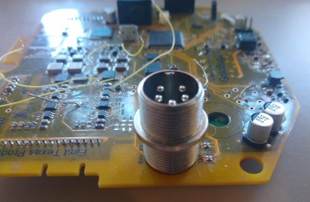

                      Interesting...

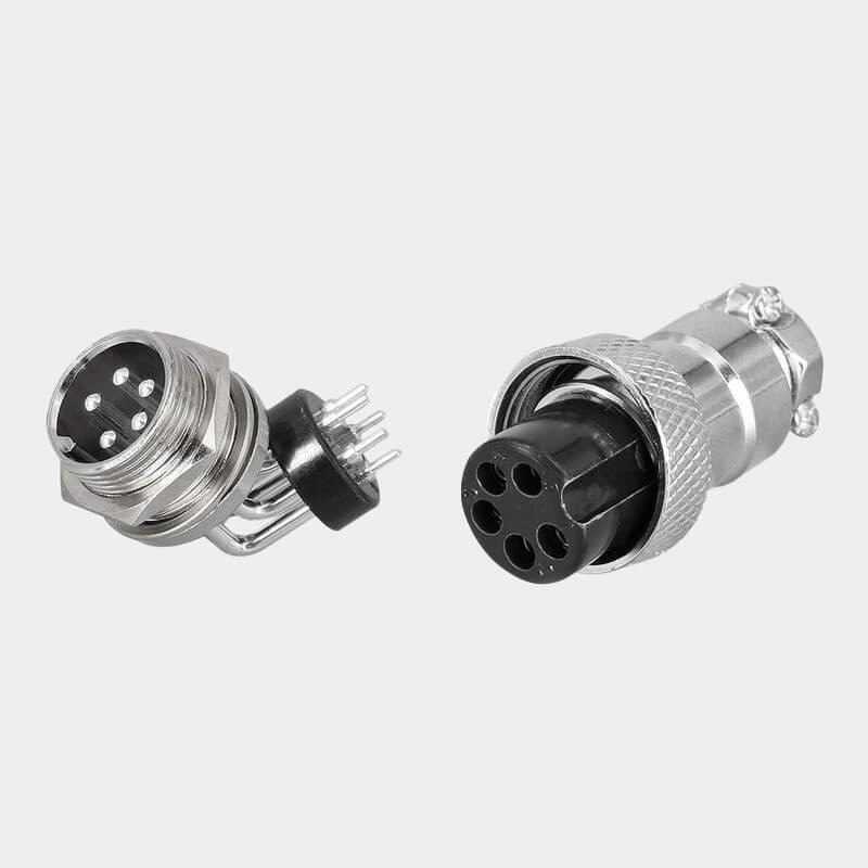

                      But why not make a small circuit board, insert an original GS16 connector into the housing, and then solder the GX16 connector onto the small board? The small board has a different standard connector type that fits into the actual backplane. That would also work well and would be significantly cheaper to manufacture. The only disadvantage is if you want to replace the GX16 connector it self. Then you have to desolder the small board.​
                      By the way, the angled GX16 connector is also available for soldering circuit boards. See the image below. Perhaps that would be an option for you as well.
Name:	gx16-connector-5pin-straight-female-pulg-to-right-angled-male-socket-front-mount-solder-type-for-pcb-49119.jpg
                        You should have a closer look at the angled GX16 connector. If you would cut the connector pins right before the 90 degree angle you can solder them right onto the PCB. The rear PCB you can mount with the connector the same way like you wanted.
                          Not quite sure of what you are doing, but there are GX16 connectors that mount directly on the PCB:
                            Click image for larger version  Name:	image.png Views:	42 Size:	403.9 KB ID:	436742
                            Thanks Carl. I'm just working around a problem of mounting this connector in a suitable way because none of my normal parts sources have had a connector like your picture listed which was surprising since PCB mounting is rather common. My solution will work perfectly but does take considerable machining time. I will try to find the part number for the connector you have shown and get some in stock for future work.
                            GeoMax, It also looks like that your suggested solution may may also work if the distance between the panel the connector is mounted to to allow 0.5 inch distance to the PCB circuit board after cutting the pins.
