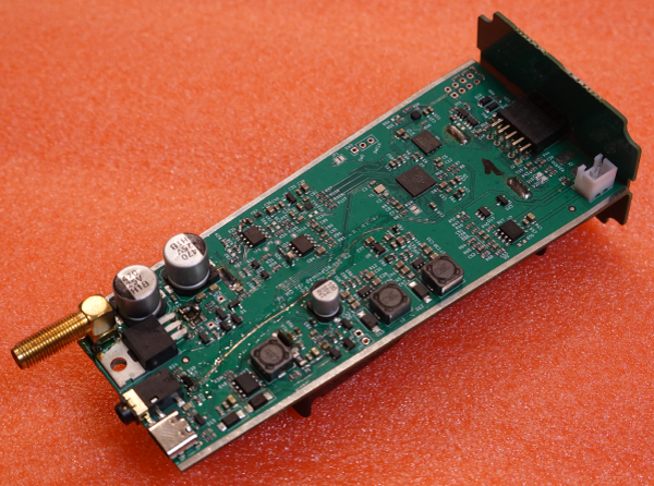

    Here is a rough outline of the metal detector design:
    • Unipolar, high-side FET-based, fixed damping.
    • ADS7052 14-bit, 1MSPS ADC controlled by an RP2040 PIO state machine. MCP6022 (Chinese clone) op-amps with controllable gain. (Schematic provided.)
    • Various compute-intensive statistics implemented, but currently using a relatively simple amplitude-difference algorithm for target detection.
    • "Dynamic" and "Static" modes somewhat implemented.

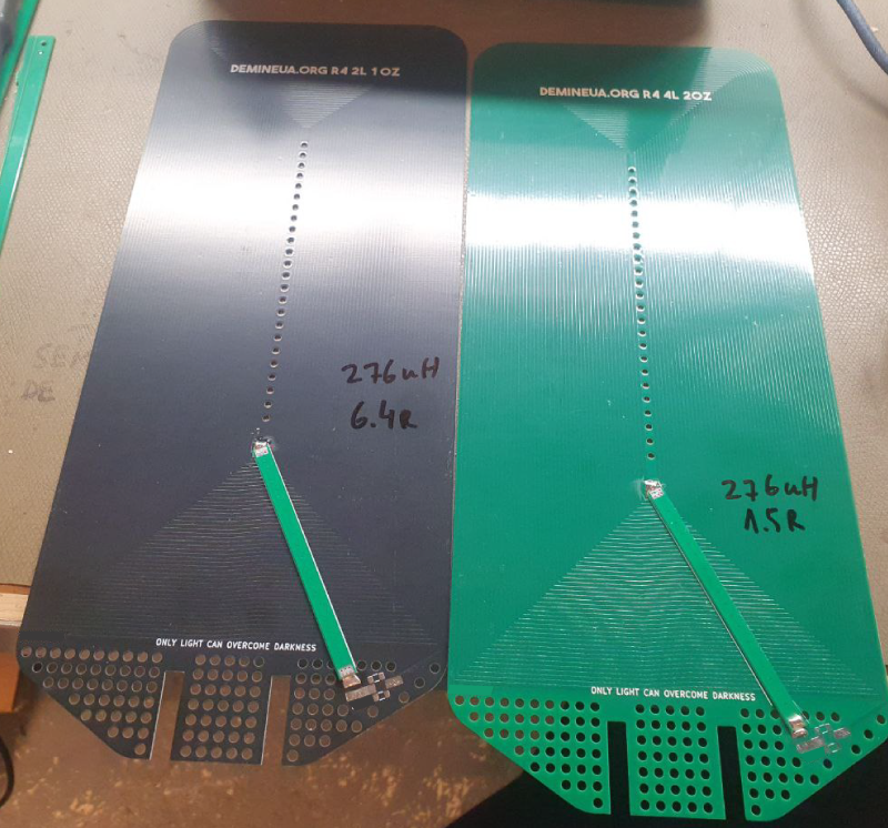

    • PCB-based, small-size search coil: 4 layers, 2 Oz copper, 276 µH @ 1.7 Ω at the coil connector. Not shielded. Size rationale for cluttered soil use.

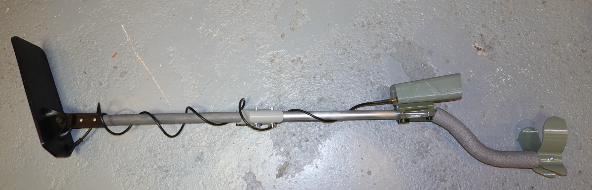

    • Mostly 3D-printed construction for ease of replication. Rod made from a wooden rake and bent aluminum tube.

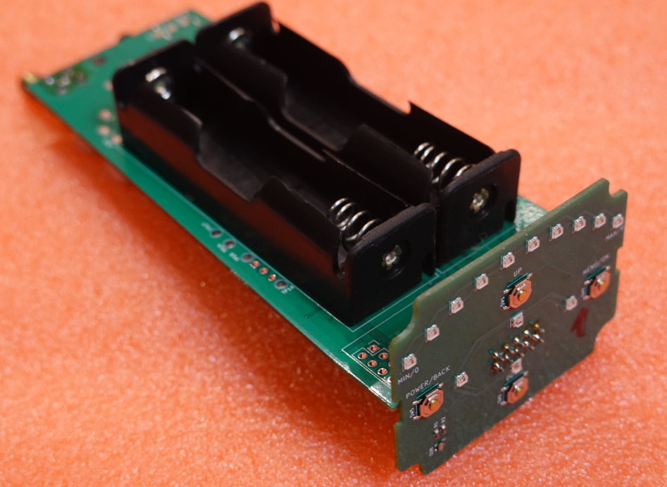

    • 2A onboard battery charger with 2x18650 battery holders.
    • USB-C port for flashing firmware, communication, and charging.

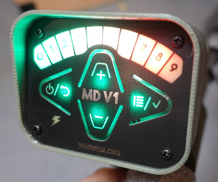

    • RGB WS2812B LED front panel with 4 buttons for parameter/mode configuration menu.
    • Speech-based menu structure, vibration motor, and headphone socket.
    • Onboard low-cost accelerometer for potential future signal filtering use.
    • Python-based GUI tool for debugging and parameter configuration. The tool can be used with a USB-C connection or over Wi-Fi via a connector on the PCB for an ESP-01 (ESP8266 module).

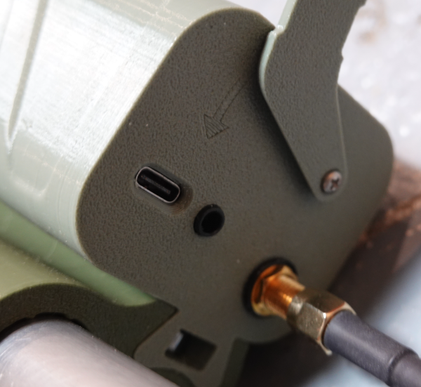

      • RG58 cable is too stiff for field use in low temperatures. SMA may be not rugged enough and almost exceeds the rated voltage.
      • Overall build should be more ruggedized for better durability in challenging environments.

    • Temperature Instability: General temperature instability caused by MCU/frontend temperature fluctuations.
    • PCB Coil Construction: The PCB coil design's effectiveness remains unconvincing, raising concerns about its performance.
    • Firmware Update Risk: There is a risk of "bricking" the device during the firmware update process. The user must manually hold the power-on soft switch while pressing and holding the power button instead of relying on the MCU.
    ​Here are some more photos:
ID:	432008 Click image for larger version
ID:	432010 Click image for larger version

    2) Any thoughts on using wire coil instead a pcb coil?

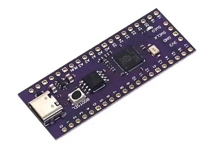

      is there any serious argument against prototyping an experimental set using this module
      (besides the S/N problem that can occur to a significant extent):

        You have a nice start on this project. I would re-evaluate the coil as Ivconic pointed out. The pcb coils tend to have a higher resistance. I am not sure it's the best idea to have the windings enclose the center. A center void is a better geometry . This has been discussed here. I think under spiral or flat wound coils.

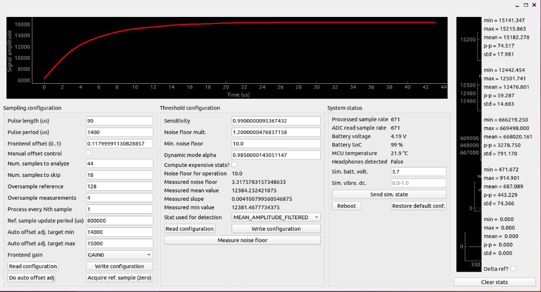

          1) What is the sampling delay now? Adjustable? Range?
          Delay is adjustable via config tool, with the limitation that only 64us are sampled after the end of pulse (but first N us can be ignored)
          We assumed, that with the dumping level prices on low cost PCB production - a time and labor intensive step (winding a coil) can be avoided by compromising some of the performance to get a "ready made" coil is well worth it.
          Our first prototypes had a more of a donut shaped 2 layer coil designed around to fit on a ender3 style 3d printer, which, suprisingly performed similarly to a more expensive 4 layer 2Oz copper, but with center section filled up. Most certainly the coil needs a redesign, but after spending close to 1k€ on coil PCB prototypes we decided to ship the latest version we had in tens of units, instead a couple of previously made prototype coils.

          Before deciding to make a PCB according to your project
          (JLPcb makes a PCB but also has a soldering service for all components, which makes life much easier for someone like me,
          who has poor eyesight, restless hands and a chronic lack of materials... but JLPcb conditions the production at least 5 sets,
          which is sometimes not cheap, depending on the BOM)
          is there any serious argument against prototyping an experimental set using this module​​
          We designed this MD to be "mass produced", even using a low cost pick and place machine to assemble a few prototypes was very painful and led to a lot of QC errors, consuming a lot of time to diagnose and rework.
          The price becomes very friendly once you order at least a few tens or hundred PCBs assembled. It may go against the spirit of this community, but we conciously decided for this not really to be hand assembled in single quantities.
          Ordering minimum component multiplier quantities (say you need one flash memory, but they are sold in qty5), makes this financially unreasonable as well.
          We made the first few revision prototypes by hand on a JLC PCB. We made the last revision PCBs by ordering them in qty of multiple tens already assembled.
          It is hard not to risk with possible design issues, as doubling the order quantity reduces the price almost logarithmically. Assembling them with JLC at qty 100+ gets not much more expensive than just the price of buying full reels of components required and acquiring the stimulants needed to endure a week long assembly process in house, and instead of reworking each board you get pretty much flawless and assembled boards.

          Thank you for the kind words! Yes, as we also noticed in electromagnetic simulations of different coil designs - a central donut shape should be left open for larger electromagnetic field propogation. Our first prototypes did this, but had much higher resistance made in 2 layers and it was a spiral in-spiral out design. The one posted above uses a PCB jumper to return the center to the outside and parallel running traces in each layer to minimize cross capacitance. The resistance aspect and parasitic capacitance here is good, unlike the previous designs we tried.
          Current design has a flaw, where it requires a larger print bed size for the coil enclosure, where most printers are limited to 220x220 or 225x225 mm, whereas this design requires a bigger bed.
          For future production runs we will definitely redesign the coil.

            "...Delay is adjustable via config tool, with the limitation that only 64us are sampled after the end of pulse (but first N us can be ignored)..."
            I'm trying to figure out the "Configuration Tool" options. Does "...N us can be ignored..." refer to the "Num. samples to skip" field?
            In that case "Num. samples to analyze" are within the "only 64uS" that are sampled, right?
            So... as I understand so far (probably wrong), according to screenshot you posted: first 18 samples are skiped (ignored) and next 44 samplest are taken, right?
            18+44=62, "only 64" - 62 = 2. What happens with those 2?
            In order words; does "Configuration tool" allow "out of limit" input of parameters and what happens then?
            Sorry if the question is stupid, I'm just trying to understand some of the parameters in the "Configuration tool".
              Max 64 samples are taken, each sample being 1 uS. "Samples to analyze" can be also be 10 or 20, as long as the the sum of "samples to skip" and "samples to analyze" doesn't exceed 64. If we can get delay down to 10 uS - you can theorethically analyze all of the remaining 54 samples in the statistics.
              Realistically, given our limited experience or "gut feeling" on choosing the best parameters - a robotic arm or a "sweeper" should be made to "fuzz" the parameters looking for the best performance at target response optimization.
              At the moment they are something we have deemed as "kind of good enough", but certainly there is room for improvements in filtering, statistics used as well as pulse rate, pulse time and most of the other "knobs" there are to turn.
              Our current methodology to evaluate turning each "knob" may be deemed highly unscientific for the lack of a beter description.

                  Thank you for sharing. It looks like you've done a pretty good job with this. I'm surprised at the 35€ cost considering the PMOS alone is about 10% of your budget. But I applaud you for coming up with exactly what humanitarian demining needs: something easy to use, and dirt cheap. We discussed a solution for a close parallel to this market a while back, that of third world artisinal mining, where targets can be similar in size and conductivity and "dirt cheap" is a bonus. See the AMX project section. I think we even discussed its potential utility for humanitarian demining.
                  It would help to better understand what you are looking for and the ground conditions. Minimum metal mines were banned in 1996 but I suspect the ban means little, so if these are included you need a really aggressive detector. Anti-tank mines are designed to trigger on a change in ambient magnetic field so for these you really need to use bipolar pulsing. I would assume Ukraine is also littered with steel shrapnel and lead bullets, making false positives a real problem. Finally, does your design use any ground balance method, and is it needed?
                  Personally, I think for the goals of this project the PCB coil is the right choice, and 4 parallel spirals is probably also the best approach. The resistance will still be a bit higher that what you could get with wire but that should not be a big deal. Capacitance will be about as low as you can get. If you want a more aggressive sample delay, consider changing to a low-side switch. Everything else equal, PMOS has 2.5X the capacitance of NMOS and tends to be more expensive. Yes, it means flipping the supply domains which is a pain in the arse but it's the easiest way to pick up speed. Your RX input clamp resistor is 1.2k, increasing this (try 3k-5k) will speed up the diode clamp recovery at the expense of thermal noise, but usually the extra speed is worth the extra noise. For the TX timing, depending on the range of targets you need to find, a 90us pulse may be overkill and a 1400us period may be underkill. Do you have any target standards that you are using in development?
                  Finally, yes, the RG58 is not a good choice, and I would not use an SMA connector either. Problem is, other options get more expensive. Do you really need a coil connector?

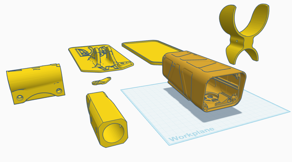

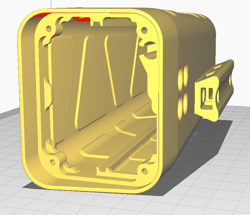

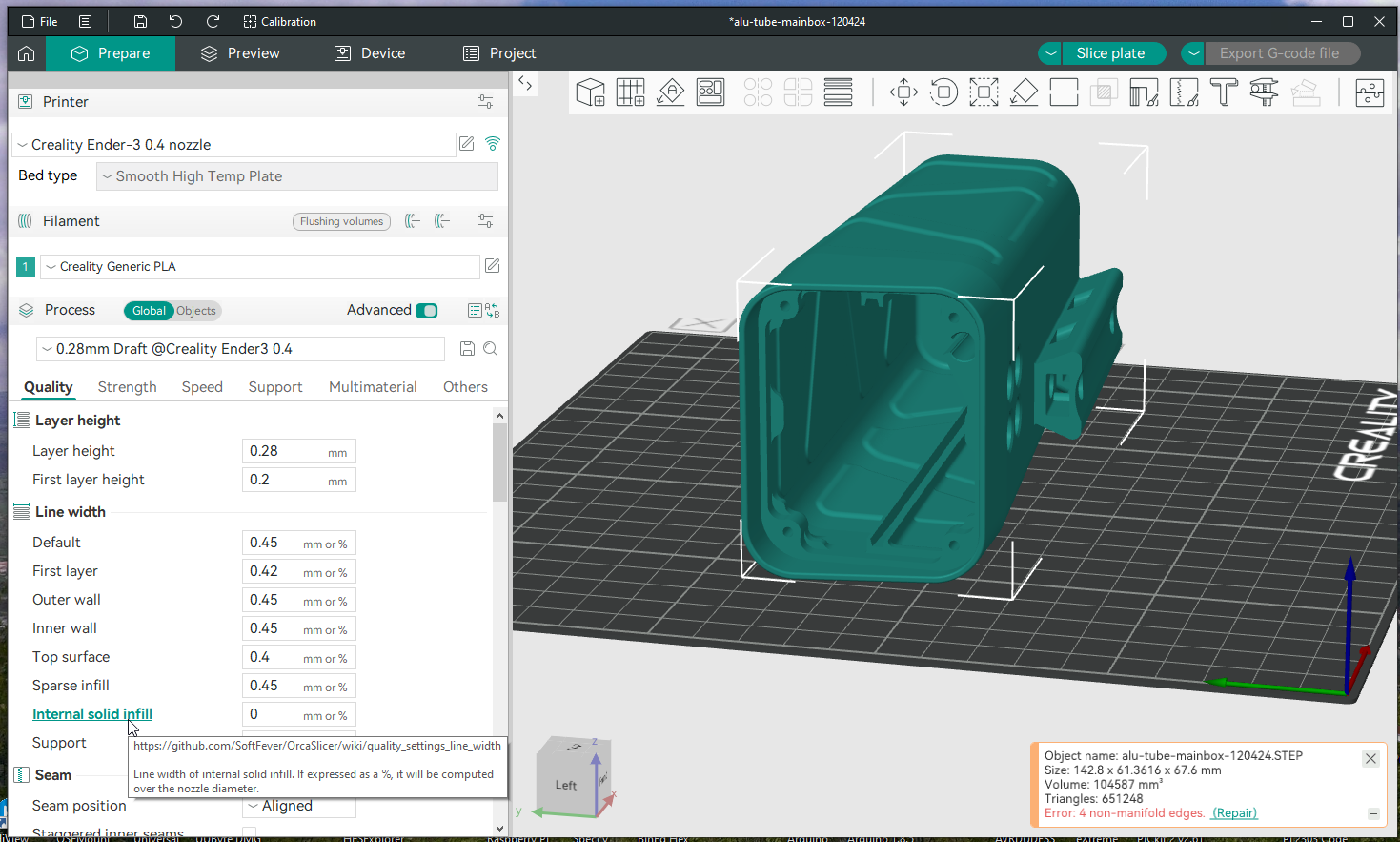

                    I converted the .STEP files to .STL and imported them into Tinkercad so I could check the details.
                    The main box is well done and quite rigid, I wouldn't change anything about it. It is up to its purpose and task.

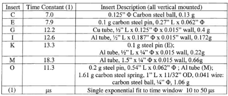

                      Click image for larger version  Name:	low-metal-surrogates.png Views:	0 Size:	205.0 KB ID:	432073​
                      For internal testing we tried to evaluate "low metal" mine surrogates published in scientific literature.
                      The most challenging soviet mine is TM62 type in bakelite and vacuum bellow fuze (UVMP) containing very little metal.

                      Our current mechanical design allows for discarding of the aluminum part of the rod in favor of one short wooden stick with the control box zip-tied to the rod. This produces a metal detector in form of a large "pin pointer" for ease of operation while kneeling, if clearance requires grid sectioned mine probing.
                      The ideal coil should be somewhat of a "deep seeking sniper", allowing for precise pinpointing, but not small enough to be a drawback when a large area needs to be surveyed.
                      We did contemplate "multi coil" arrangement, but this added complexity and producing high enough inductance with low resistance gets challenging in small sizes.​
                      This is a quick realization we made somewhat early on, while trying to find a PMOS with high enough avalanching rating. NMOS world seems a lot more forgiving.
                      Your RX input clamp resistor is 1.2k, increasing this (try 3k-5k) will speed up the diode clamp recovery at the expense of thermal noise, but usually the extra speed is worth the extra noise. For the TX timing, depending on the range of targets you need to find, and 90us pulse may be overkill and a 1400us period may be underkill. Do you have any target standards that you are using in development?
                      RG58 was chosen because of low capacitance per meter and cost. Do you have any suggestions for a better low cost cable, with low enough capacitance and flexibility? We initially chose to add a connector to aid in "hobby use" or "field coil replacement", however, this question is very much valid, and, most likely, we do not really need a connector. Thank you for the simple idea we definitely overlooked!
                      Thank you for the feedback!

                            "... What I have noticed in the past few years- most 3d printing software (apart from Cura) is now able to accept STEP files, producing much nicer final results. We should probably release STL files for usability, but STEP allows for customization in 3D CAD software, that is why it was chosen as the primary format for mechanical release..."
                            In any case; the box is pretty good, I didn't feel the need to make any changes.
                            Directly importing the original box file into Tinkercad was not possible, I had to reduce the number of polygons in Meshlab.
                            After that, Tinekrcad agreed to import the file.
                            Yes, I'm using Cura but I imported the files into Tinkercad and they really look lacking in detail.
                            But it is only an illusion. After it was imported into Cura looks very well and does not look "broken":
                            Click image for larger version  Name:	image.png Views:	0 Size:	238.5 KB ID:	432083
                              I just found that the new Orca slicer directly opens the original .STEP file without any problems.
                              If you look at the bottom right, it has a warning about 4 manifolds and even offers an option to correct them!
                              Wow!
                              I have Orca slicer installed since yesterday and I'm discovering a lot of good options!
                              Click image for larger version  Name:	image.png Views:	0 Size:	275.2 KB ID:	432085​
