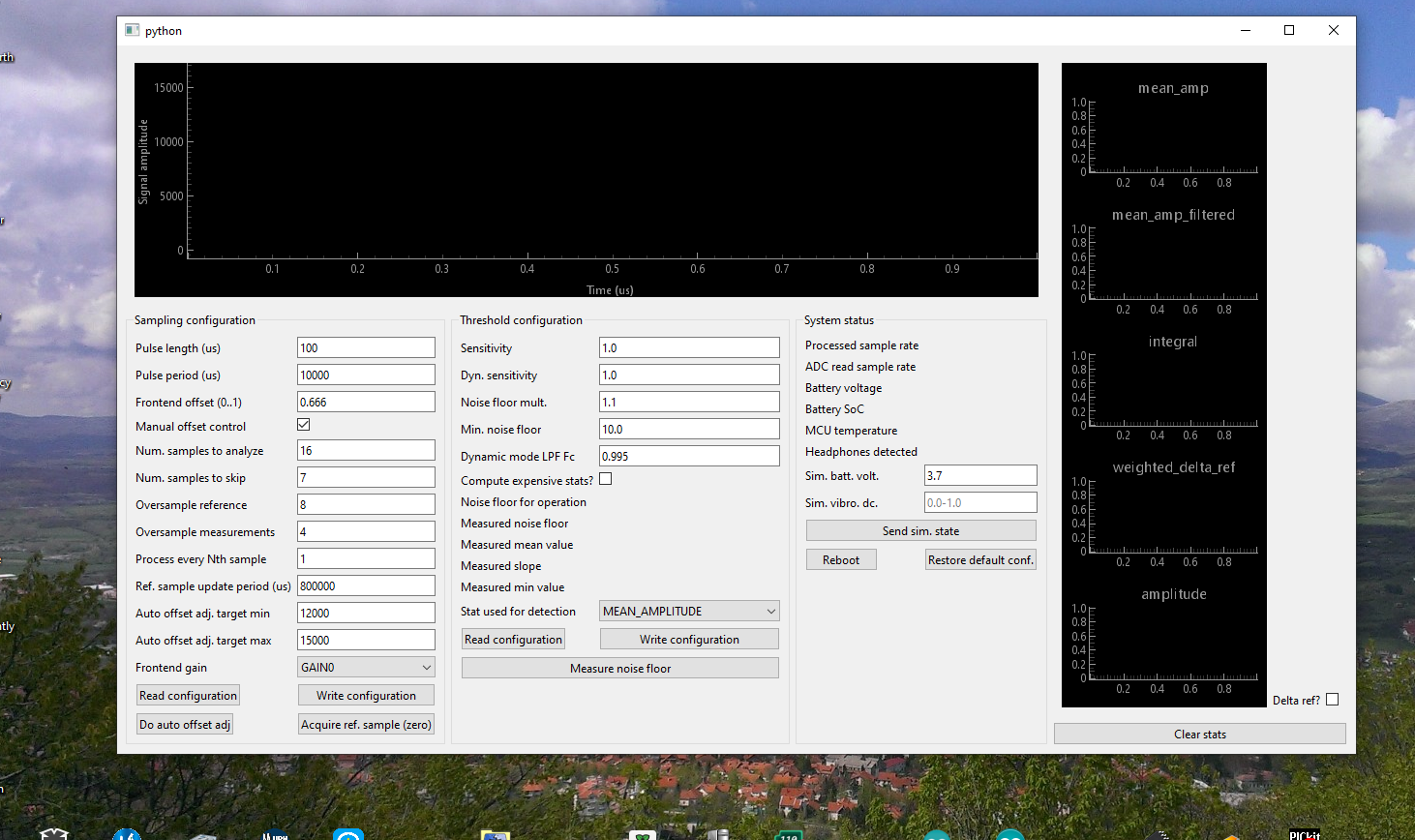

            I managed to make it run:

                  I successfully installed everything, it's actually very easy and simple... I'll write a method for "dummies"...
                  a) Check if your computer has Python installed and what version it is.
                  My computer had Python installed but the wrong and old version.
                  b) If there is, uninstall both Python and Python Luncher (in Add or Remove programs in Windows).
                  In the first attempt, I didn't uninstall the Python Launcher as well, so I had problems because of that.
                  Therefore, it is necessary to remove the Launcher as well.
                  c) Find on the Internet and install "python-3.11.0-amd64.exe"
                  d) Open current folder 'pigui' in CMD.
                  e) Type (Copy&Paste from here) venv\Scripts\activate
                  f) When the command is done, type (Copy&Paste from here) pip install -r requirements.txt
                  g) Wait for the libraries to be installed, may take some time.
                  h) After installation, close the CMD window.
                  i) In Notepad Copy&Paste the following text (edit the port number to the USB port where your RP2040 is atttached)
                  and save it as "Start.bat" in the same 'pigui' folder:
                  python main.py COM3
                  pause
                  j) The GUI will not start if you do not have an RP2040 connected to a USB port.
                  I don't currently have an RP2040 with me, but I tried to "cheat and lie" it by attaching an Arduino UNO to the port.
                  And it worked, the GUI started!
