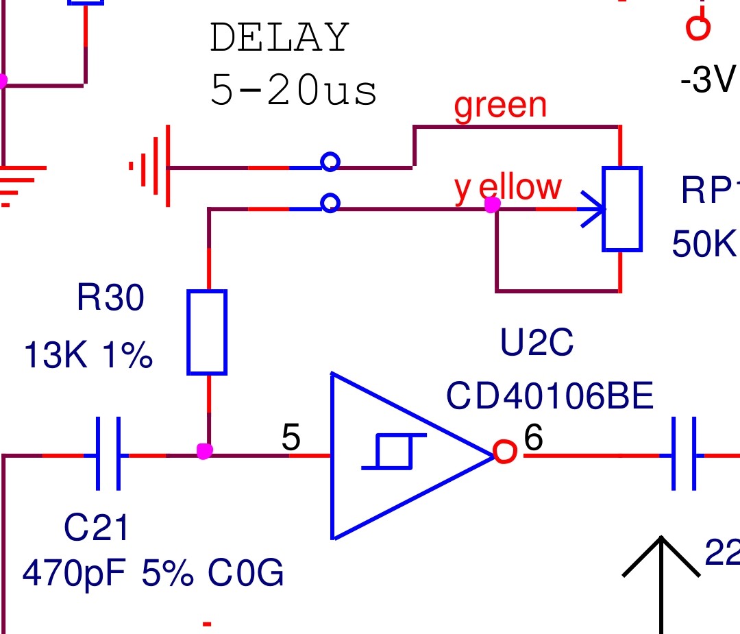

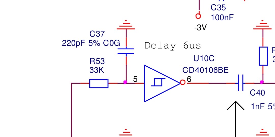

    The transistor Q16 is controlled from ALL channel. When some target is detected, this transistor enables the work of the final stage of the DISCRIMINATION channel to show the type of the target - Fe/non-Fe. For Fe target, The "Fe" LED lights up first and after that "non-Fe" LED lights. For non-Fe target this order is reverse.
    Why does discrimination use a later signal? Is the discrimination block swapped with the right channel?

                          • Hi algan,
                            I know for this relatively old patent. It is not so difficult to made PI MD with simple mono or DD coil with 3-5us delay. I have some experience with adding of MOSFET transistors as switches connected to RX coils. The influence of parasitic capacitances in switching transistors add of noise pulses in RX signals and the final result is not good. Well designed fast coil with good low capacitance cable are sufficient to reaching of 3-5us delay. But in practice, for these so short delays, the influence of the ground is very strong and the real benefit is doubtful.
