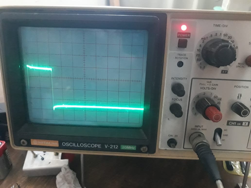

                              Now, developing the other parts of the detector, I have the TX and Preamp circuit that is the same of the Arduino Nano PI. The coil flyback waveform is good, but the preamp output (TP6 in the Arduino Nano) is as you can see in the image:
                              Someone has an ideia of what could be causing this wrong waveform at the preamp output?
