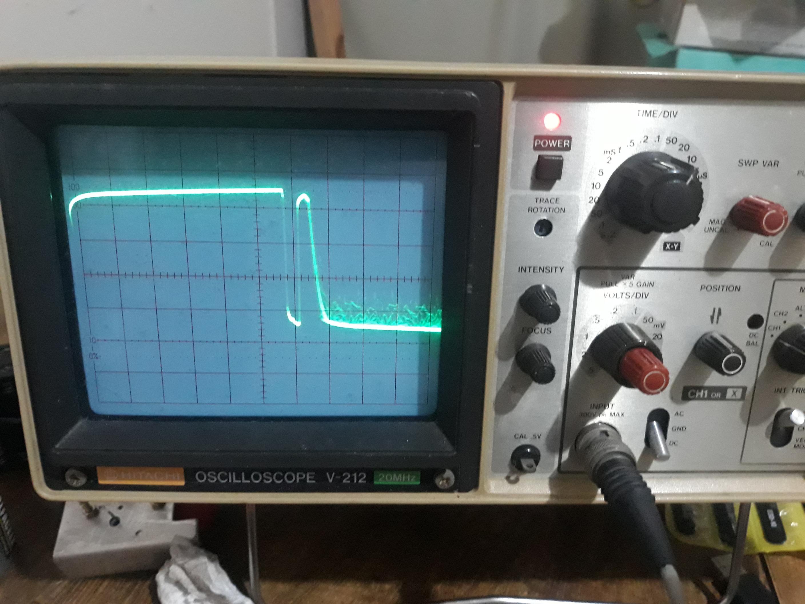

    The Preamp output waveform:

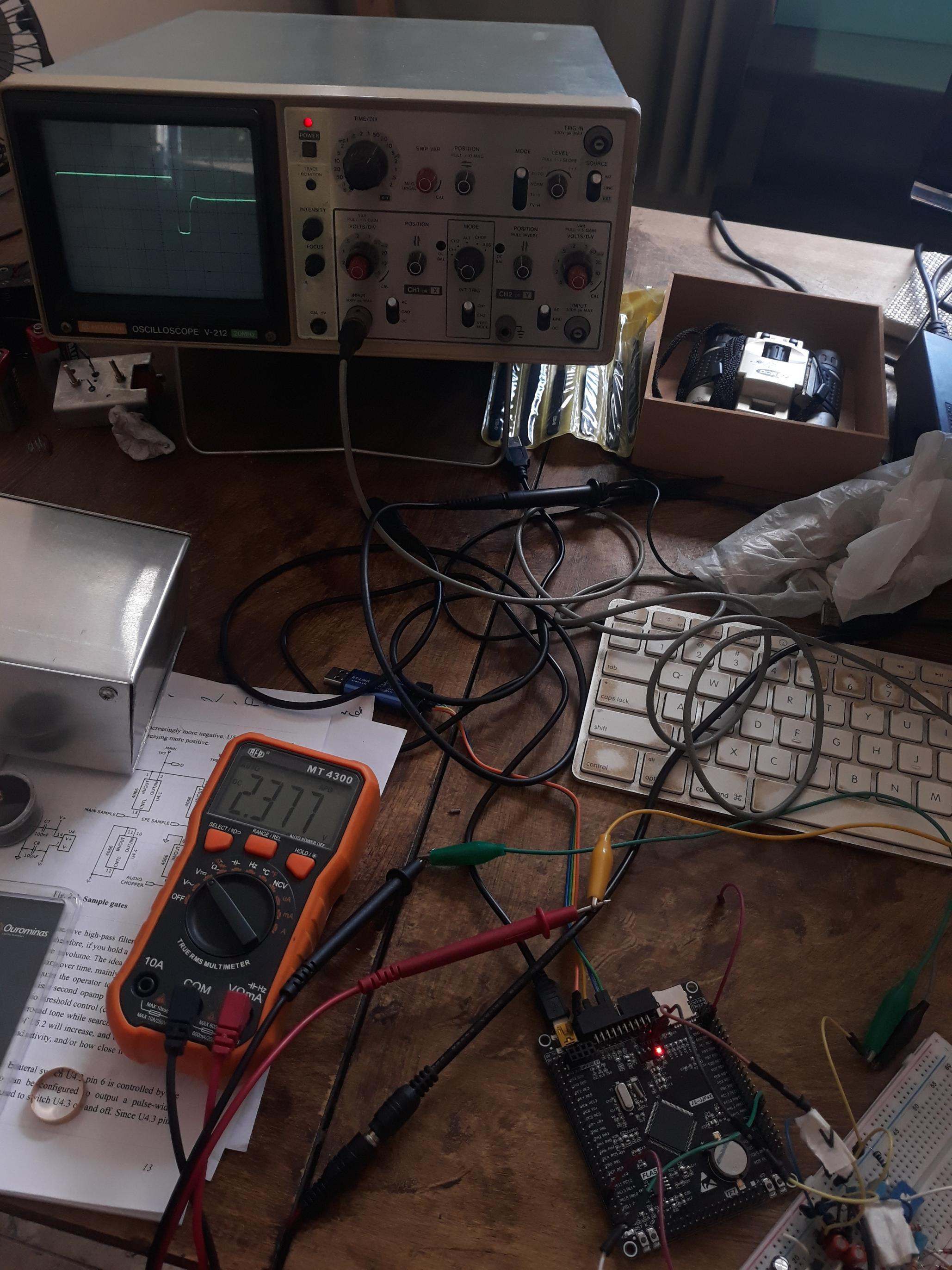

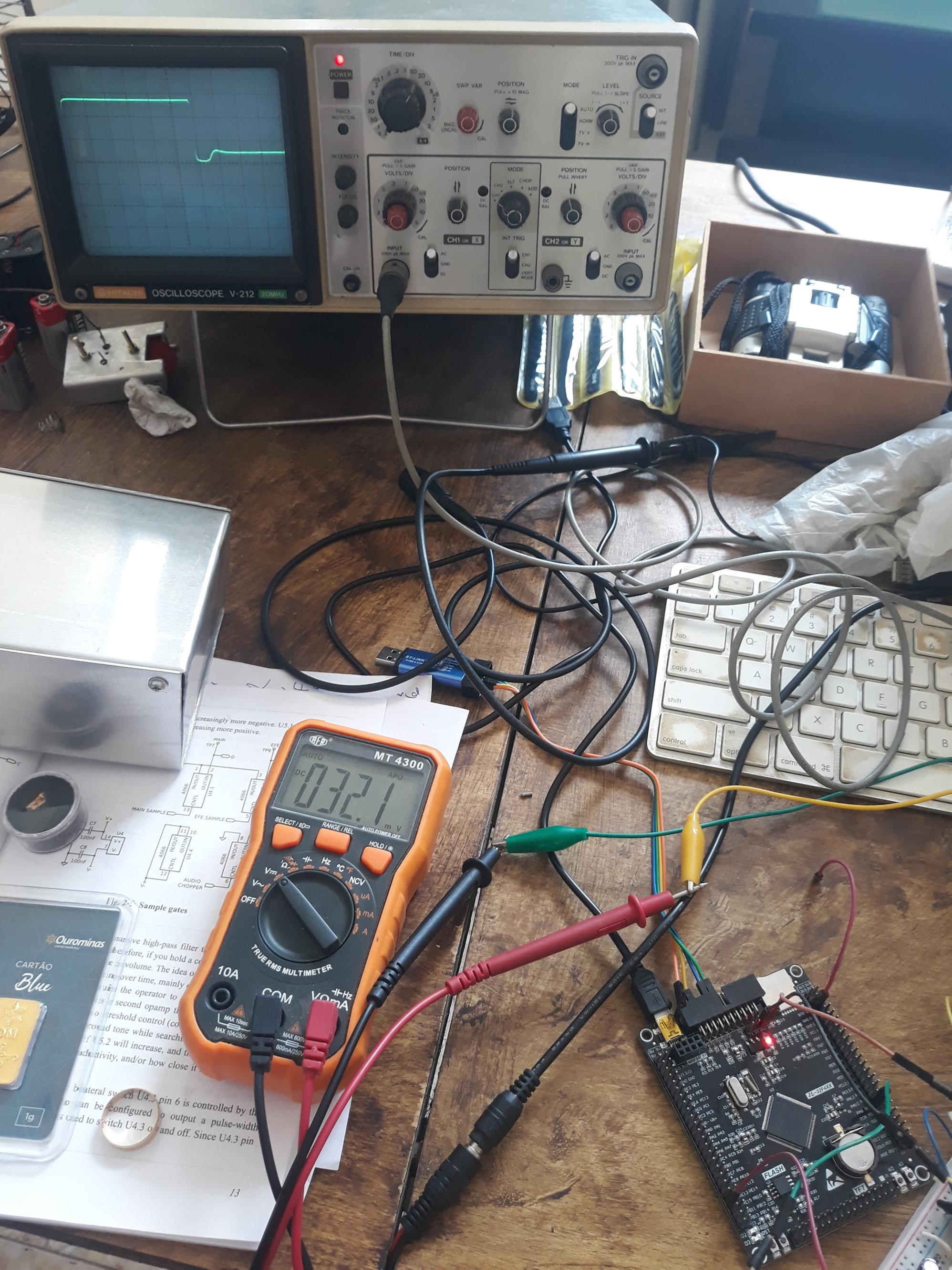

      Now I have another doubt, in the attached 2 images, the best preamp null should be when the DVM measures the most near possible around 0v?
      Preamp null at 2.3v
      My doubt is just because in the first image, the wave form looks better than in the second case, in which the preamp null is near 0v.
      Thanks.
        Here is a small vĂ­deo of it detecting for the first time, no my plan is to improve the code and use a better ADC than the 12 bits infernal one
        Testing homemade pulse induction metal detector based on Stm32 MCU.#shorts #metaldetecting #stm32 #treasurehunt

              I watched your video. The receiver's output signal was visible on the oscilloscope screen. The signal from the test coil isn't as it should be. The test coil needs more attenuation.
