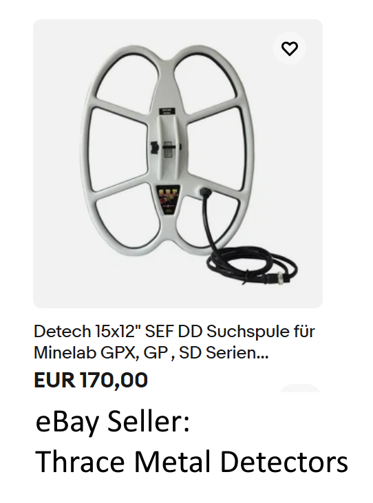

                      • Hello,
                        if anyone is interested in a Detech 15x12-inch SEF DD coil for this project and doesn't know where to get one: take a look here at eBay. The price of €170 is reasonable, the quality is really sollid and good. Shipping from Bulgaria was also fast, though it may depend on your location.
Name:	Detech 15x12 Inch SEF DD Coil.png
