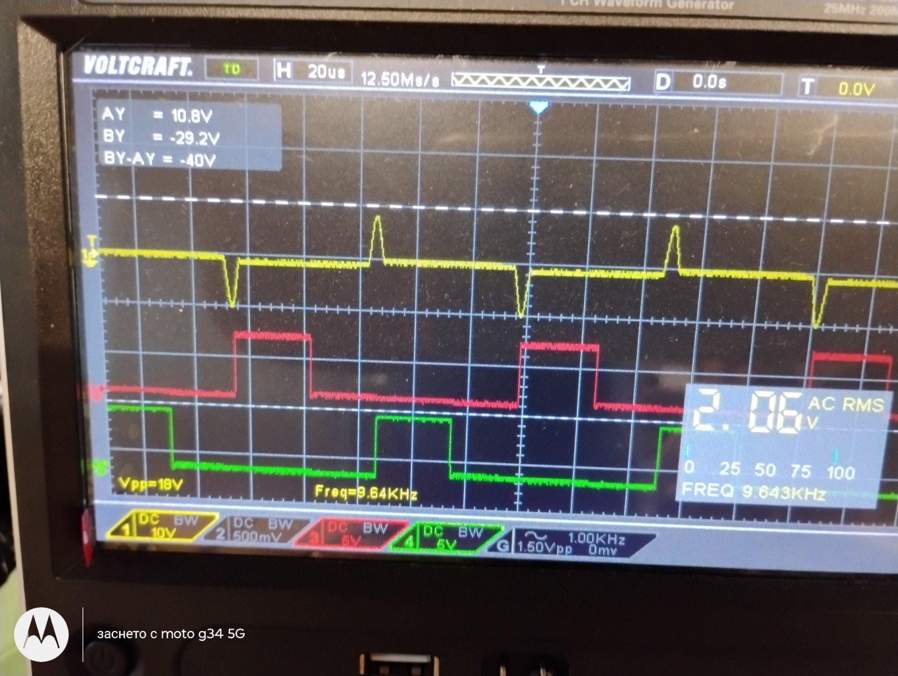

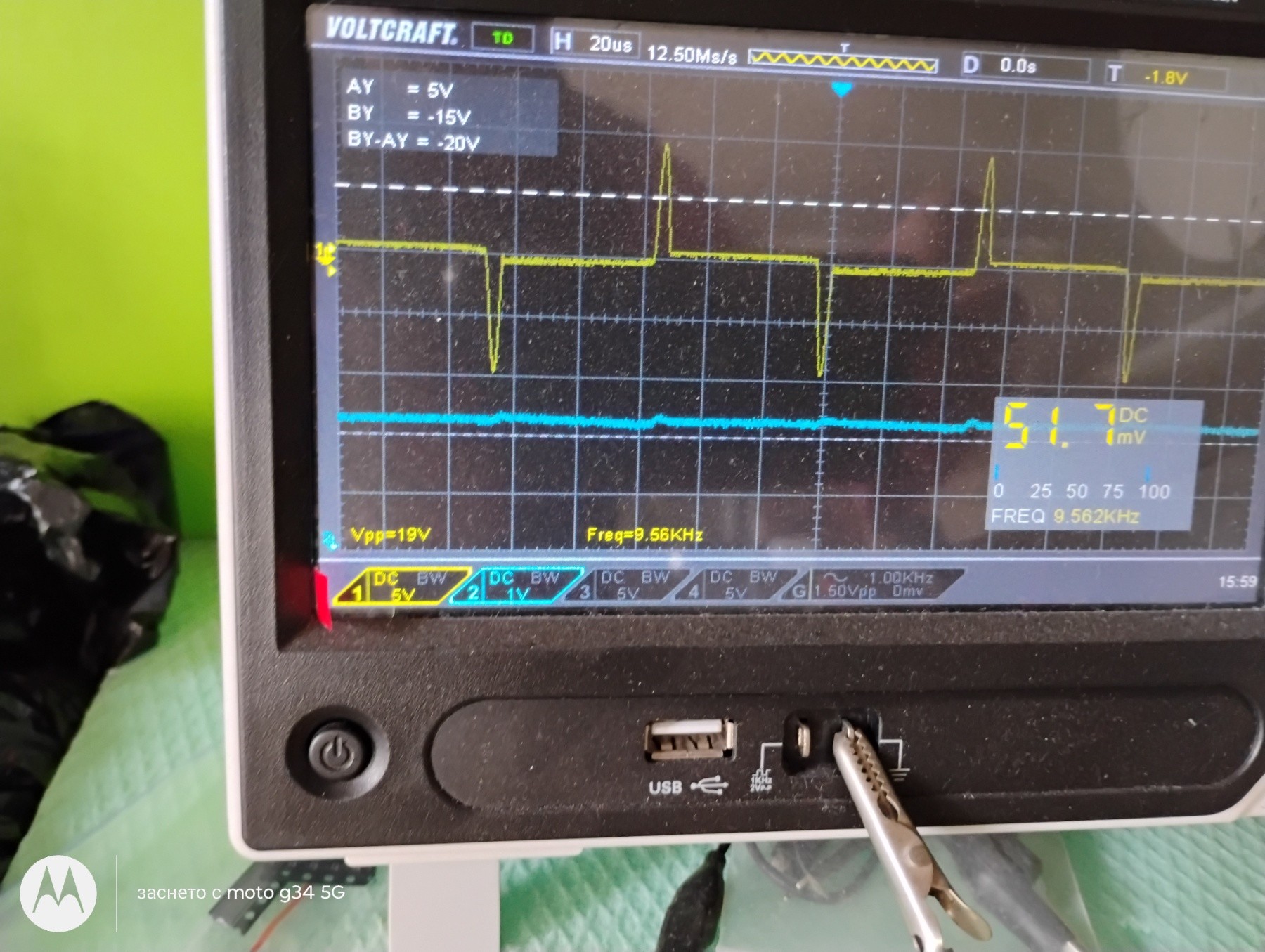

    Hi algan,
    Attached is the picture with all timings of this project.
    Can you add timing for TC4482 outputs A and B ?
    • #77
      Hi pito,
      Attached is the picture of timings with added signals: A for gate of P-ch MOSFET and B for gate of N-ch MOSFET.
      • #78
        P-ch MOSFET
        Yellow probe has a range of - x10
        The blue probe is a receiver with a cover - x1
        • #79
          Originally posted by pechkata View Post
          P-ch MOSFET
          Click image for larger version  Name:	viber_изображение_2025-09-06_09-43-03-995.jpg Views:	0 Size:	445.4 KB ID:	440543
          P-ch MOSFET = yellow
          N-ch MOSFET = - blue

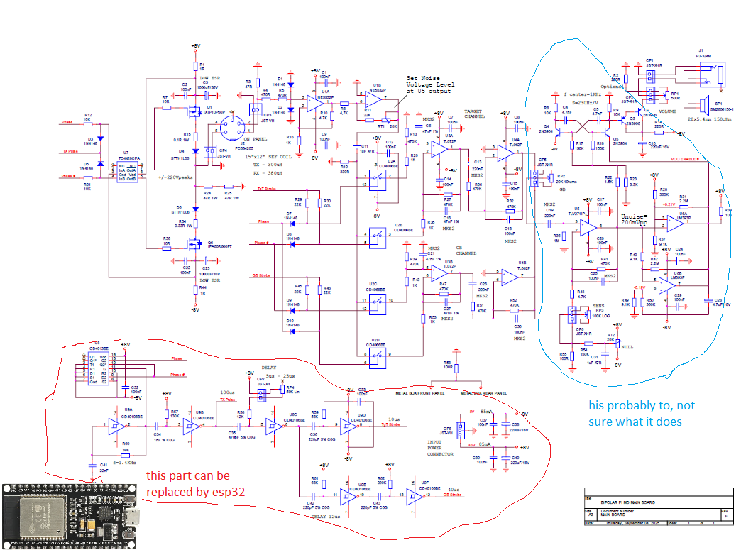

          • #80
            • #81
              Hi pechkata,
              Why you add spam in this discussion?

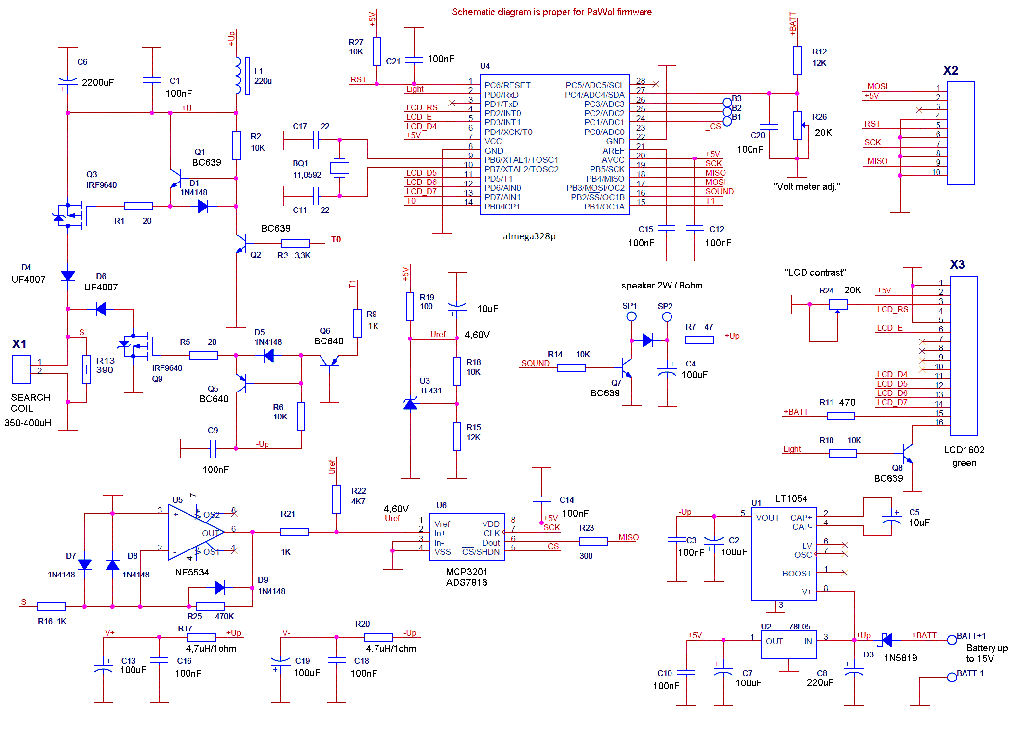

                      • #86
                        so it is not bipolar ?
                        If it's not bipolar - what is it?
                        • #87
                          which schematic is that ?
                          what is red and green ?​
                            Completely different circuit. Please start another thread if you want to discuss this, it just adds confusion here. Pito, ignore the last few posts.
                            • #89
                              it just adds confusion here. .
                              agree, I was thinking that here we discuss circuit with 2 mosfet
                              • #90
                                I just wonder what is the advantage of using 2 MOSFETs
                                Click image for larger version  Name:	image.png Views:	0 Size:	238.0 KB ID:	440564​
