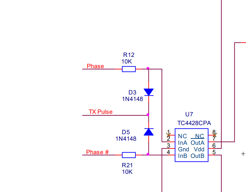

                        Hi all,
                        After many optimizations, I'm ready with new version of "Bipolar PI MD with GB and DD coil". Replacing of many transistors in the control of two power MOSFETs with TC4428CPA eliminates the need of complex setting of the gates control, despite of very different capacitances of the N-ch and P-ch MOS transistors. Using of DD coil really reduce the min delay and allows recovery of a smaller targets in comparison with bipolar project in ITMD3 book. Different connecting of the filters with U4 ensures more good rejecting of the noise after differential integrators. Using of 150 oHm sound sender instead of 32 oHm, eliminates influence of the sound on the work on the rest schematic. The scheme of power board uses two 18650 accus and very popular TP4056 charging module. It is very convenient to use any home USB charger for mobile phones for charging especially if "USB-C only power" connector is used on the box. Attached are the new schemes of the "Main Board" and "Power Bard"

                            Hi, Detectorist#1, can you write exactly what pulses are coming into the inputs and if possible upload a picture of what the generated bipolar signal looks like with an oscilloscope. Thanks. Click image for larger version

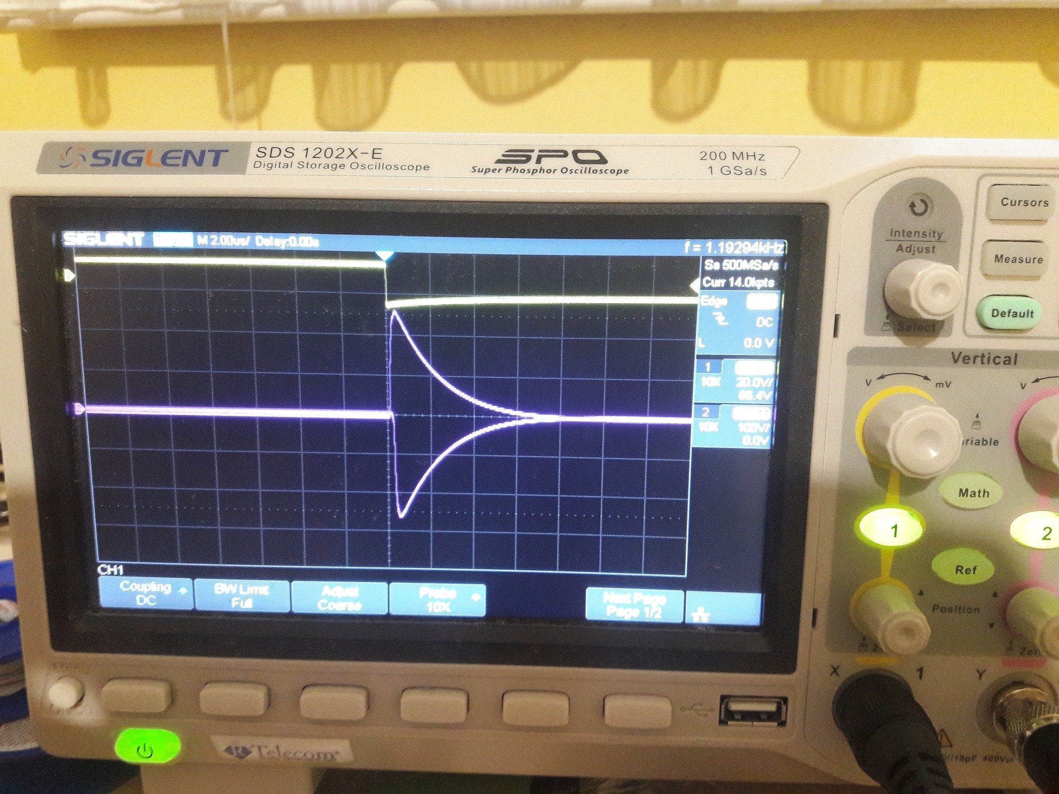

                            • #74
                              Hi algan,
                              Attached is the picture from oscope with end of TX pulse and voltage on the coil. Have in mind that two pulses on the coil are sequential - not simultaneously!
