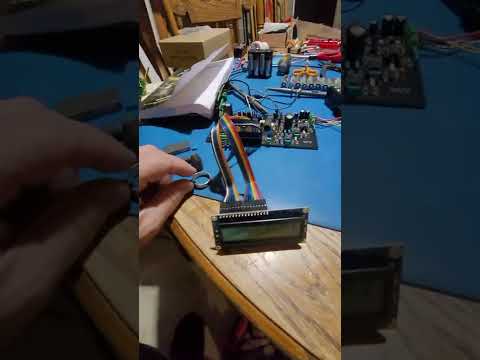

                    While you are here having empty talk, I have finished building Delta Pulse and am very pleased with the result. I will go to the field soon.:dance
