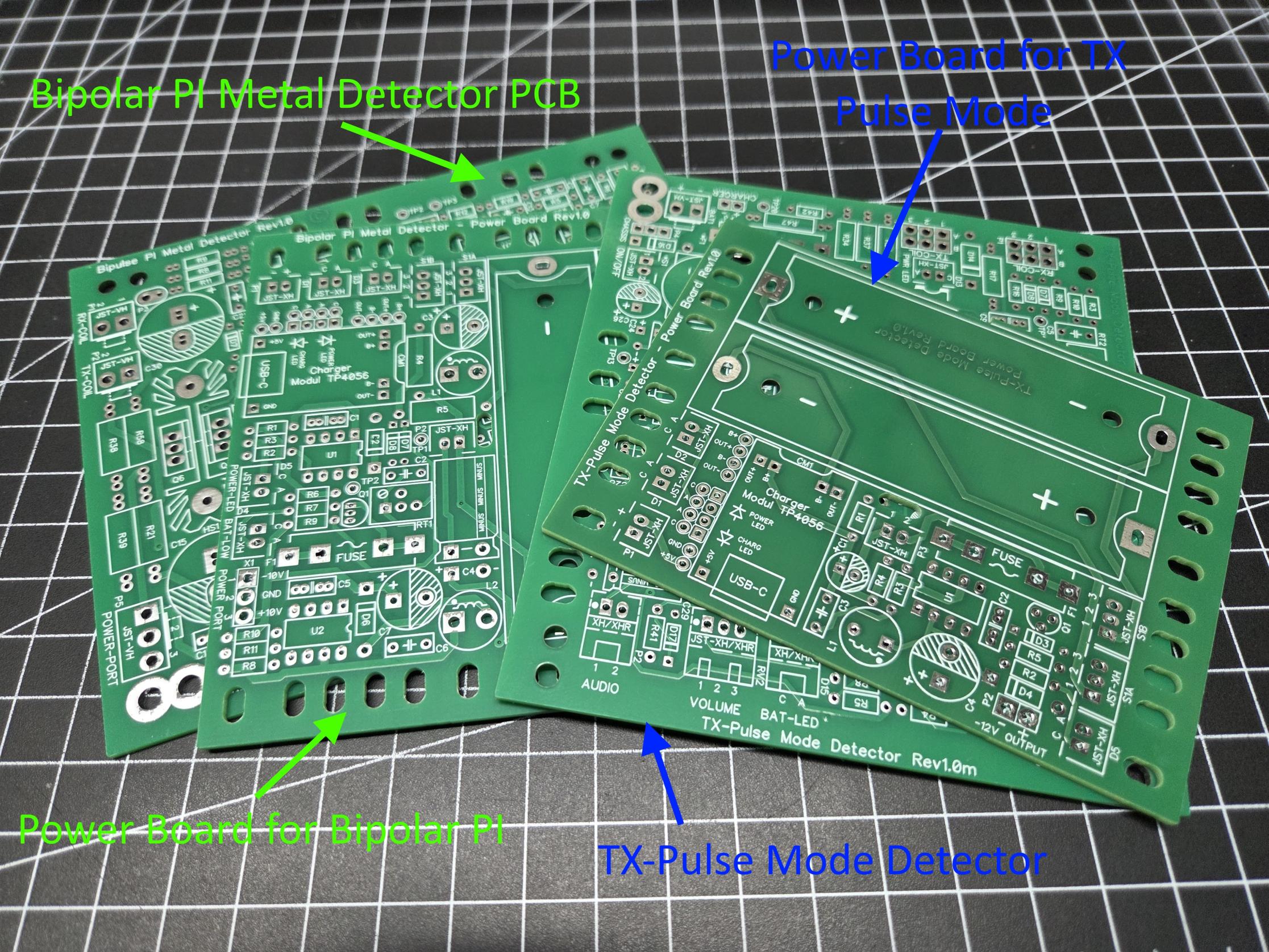

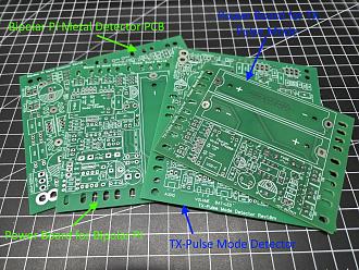

              Hello Pechkata,
              be patient... Detectorist#1 may not be finished with the board assembly and testing yet. Here's a little preview of what to expect. Each detector (Bipolar PI and TX-Pulse Mode design) has a main board and a power supply board to keep the entire design compact and fit into a standard Hammond case.
              Click image for larger version  Name:	20250601_174723(m).jpg Views:	0 Size:	692.8 KB ID:	438154
                PCBs look nice I'm waiting to build the circuit
