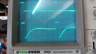

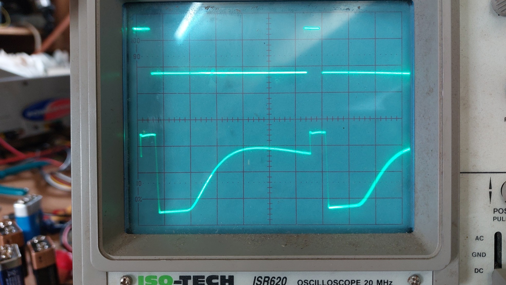

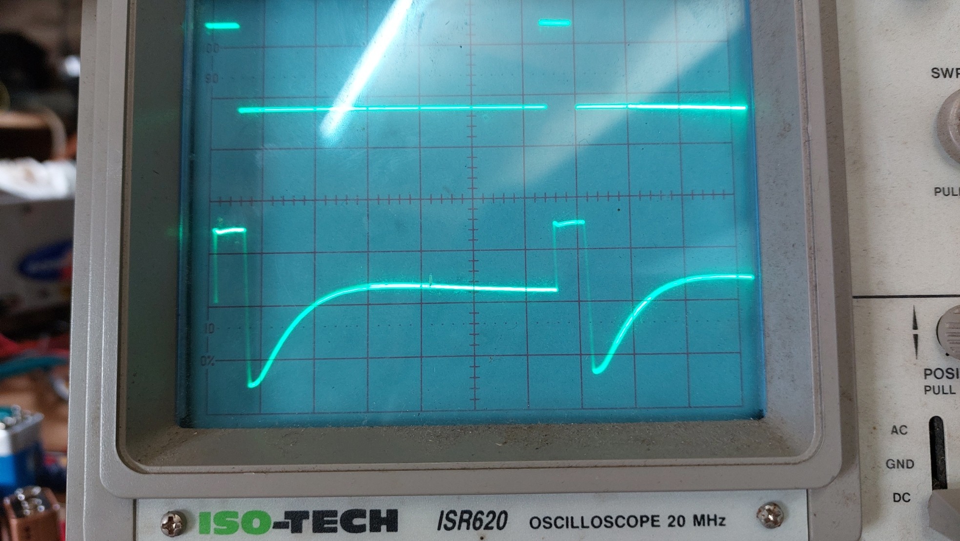

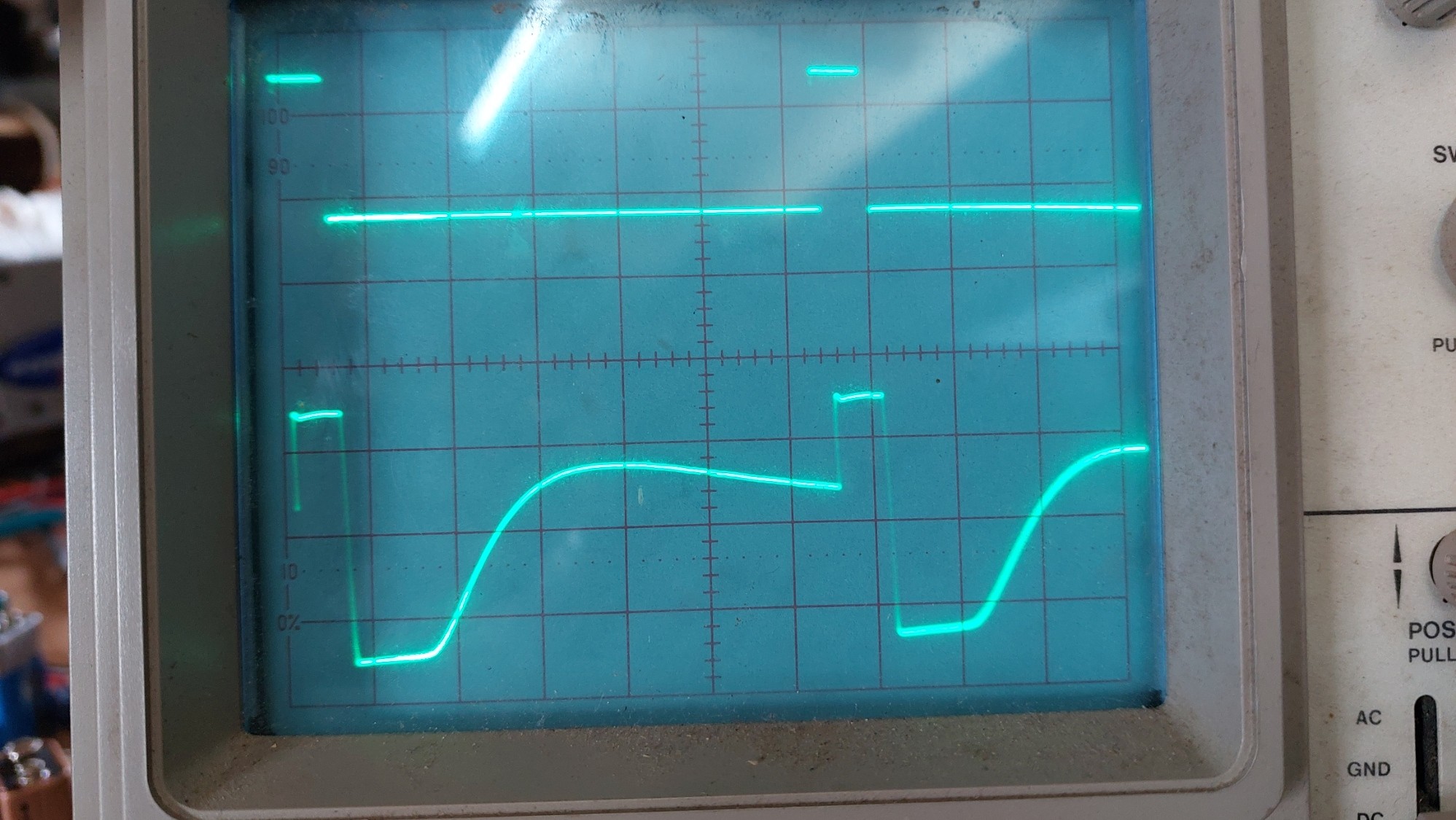

ID:	436894 I've got the same diagram. I haven't noticed the same effect though. I have been working on a PI detector for about six months. It uses an ESP32 and samples the return waveform at 10 points using the inbuilt 12 bit A/D. I've tried a few different configurations of trigger pulse duration and curve damping and none have shown any difference I can discern between steel and copper. Still early days though. Maybe when I get down to the nuances, I might spot something. It has taken me ages just to get it working. The three traces are no target, steel and copper. The steel is a pair of pliers and the copper a piece of plumbing pipe, hence the stronger response from the more solid steel object.
      Your questions:
      1/ Is this decay diagram correct - is there really a time shift depending on the type of metal near the flyback top ?
      I would say the diagram is wishful thinking but will be happy if proven wrong because I really want it to be true. I've seen a few comments on being able to identify the target by getting the measurement point as close after the pulse as possible. The A/D on the ESP32 takes approx 13μs and I've tweaked and tweaked my circuit to get as close as possible. I'm currently on 14μs for the first sample. It hasn't helped me with target identification.
      2/ If so, are there examples of PI detectors taking advantage of this property ?
      No idea. Looks like everything is IB nowadays.
      3/ If so, is there a better way to sample the top N Volts and interface it to a microcontroller / SOC at 3.3V ?​
      I have a 2 opposing diode clamp feeding an NE5532 with a gain of a few million. I then have a resistor based voltage divider to feed 3.3V max to the A/D.

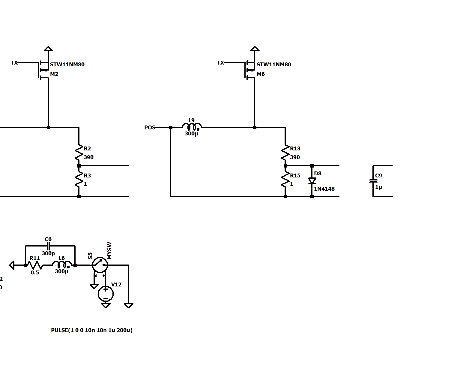

                        ..there are many ways to measure pulse width ... the Lammerby graph in post #1 is for frying pans and horseshoe sized targets .. you will never see that response for coke cans at 1 meter from the coil.
                        The proposed circuit is similiar to snubber circuits used to control or limit the peak flyback voltage. -- it wont work for your stated desire.
                        The peak flyback will change as targets / ground change the inductance of the coil ...
                        A simple voltage divider / currrent sensor is all that is required. ( see pics below )
                        Scale the voltage/ current first then process it.
                        To measure change in pulse width ... you just clamp pulse to a known voltage then integrate it ..... a change in voltage on the integrator will indicate a change in pulse width and will be way more less sensitive to noise ( phase noise ) than trying to measure the width of each pulse on the fly.
ID:	436961Click image for larger version
