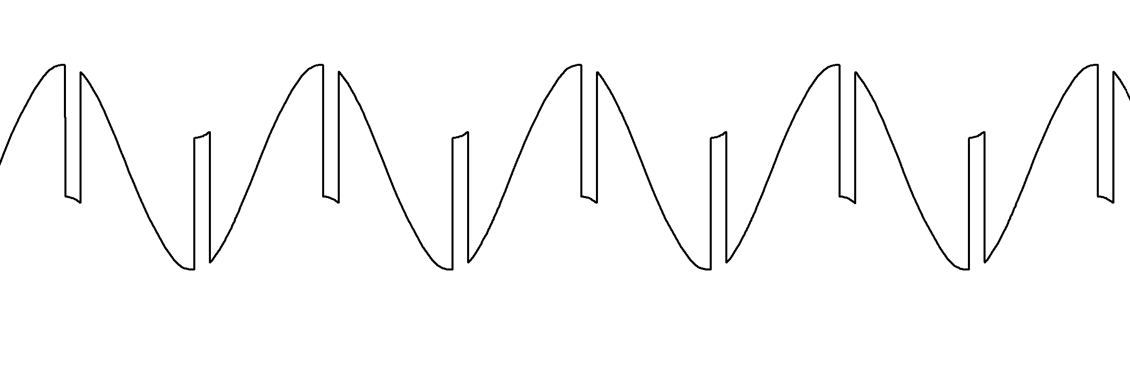

                          Boilcoil is on the right track .. the method I used and patented uses "interrupted TX" to obtain ground information whilst still utilising IQ information from the sine components.
                          Whereas that older method uses time domain multiplexing ( long pulses / short pulses ) I use "overlap multiplexing".
                          This system is superior to that used by the GPZ since it allows discrim as well.
                          eg below .... works with sine or rectangular.
