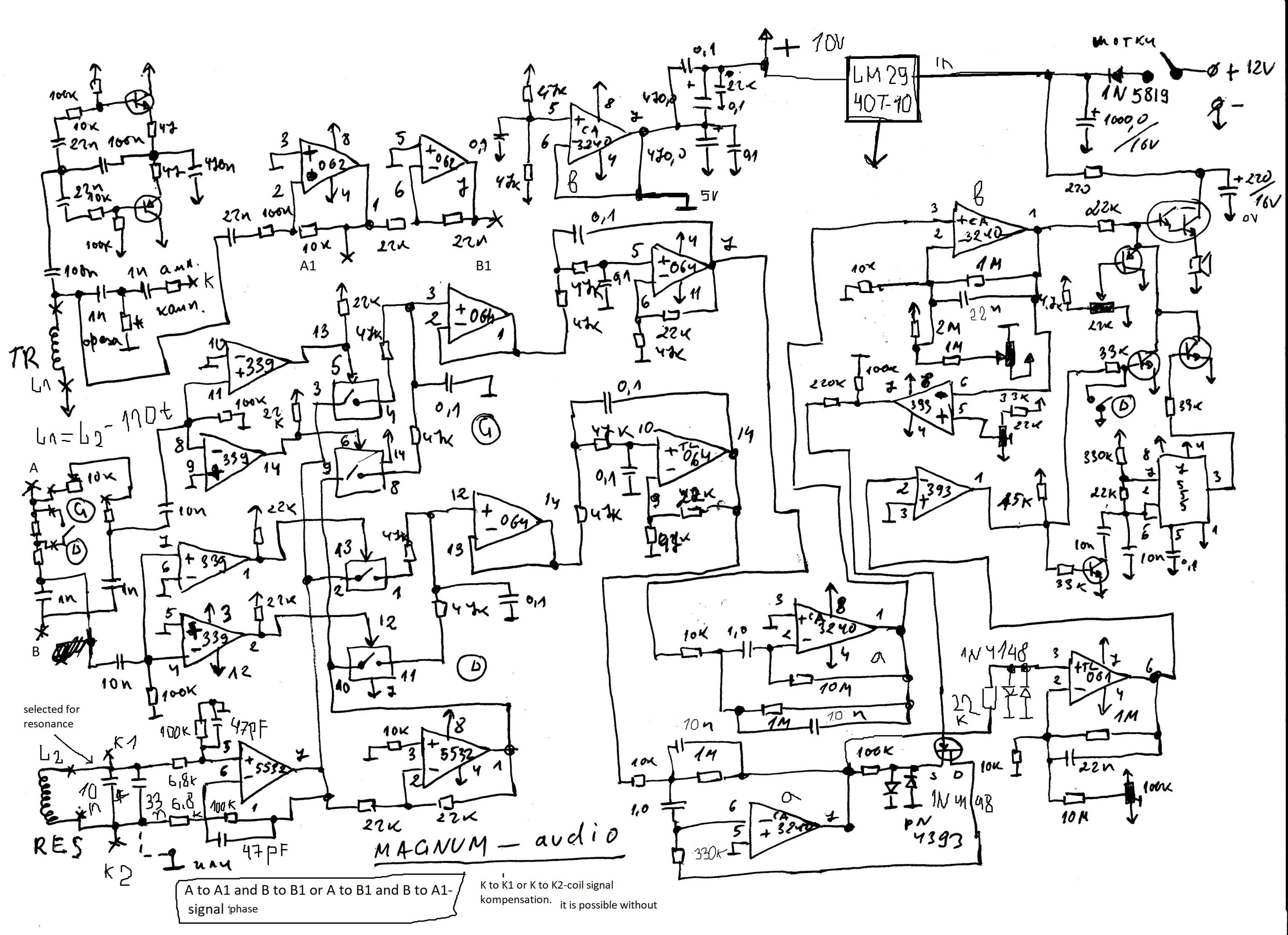

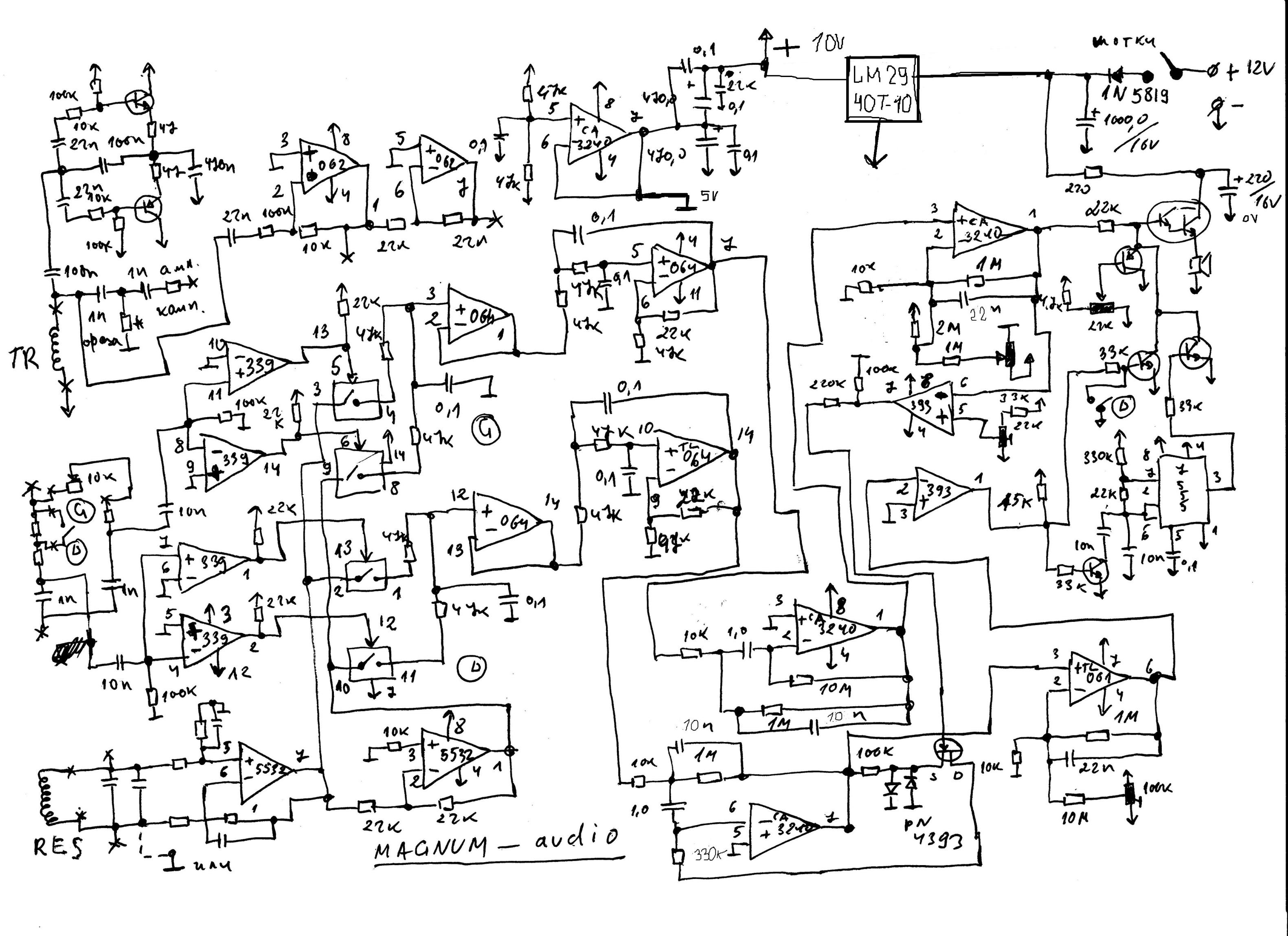

    • I have made many detectors. This is the scheme of the best for searching. It has a well-working discrimination. But it is not impulse. It works with inductive balance VLF. Frequency 8-10 kHz. I apologize for the poor quality of the scheme. I am already old and I have no desire to draw it again. The scheme is working. Whoever made it will no longer want another detector. This is my gift to everyone.​ Click image for larger version

        • Originally posted by scs-bg View Post
          Thank you.
          I have heard about this scheme, and from the words of old seekers - it is realy very good detector.
          Thanks again.

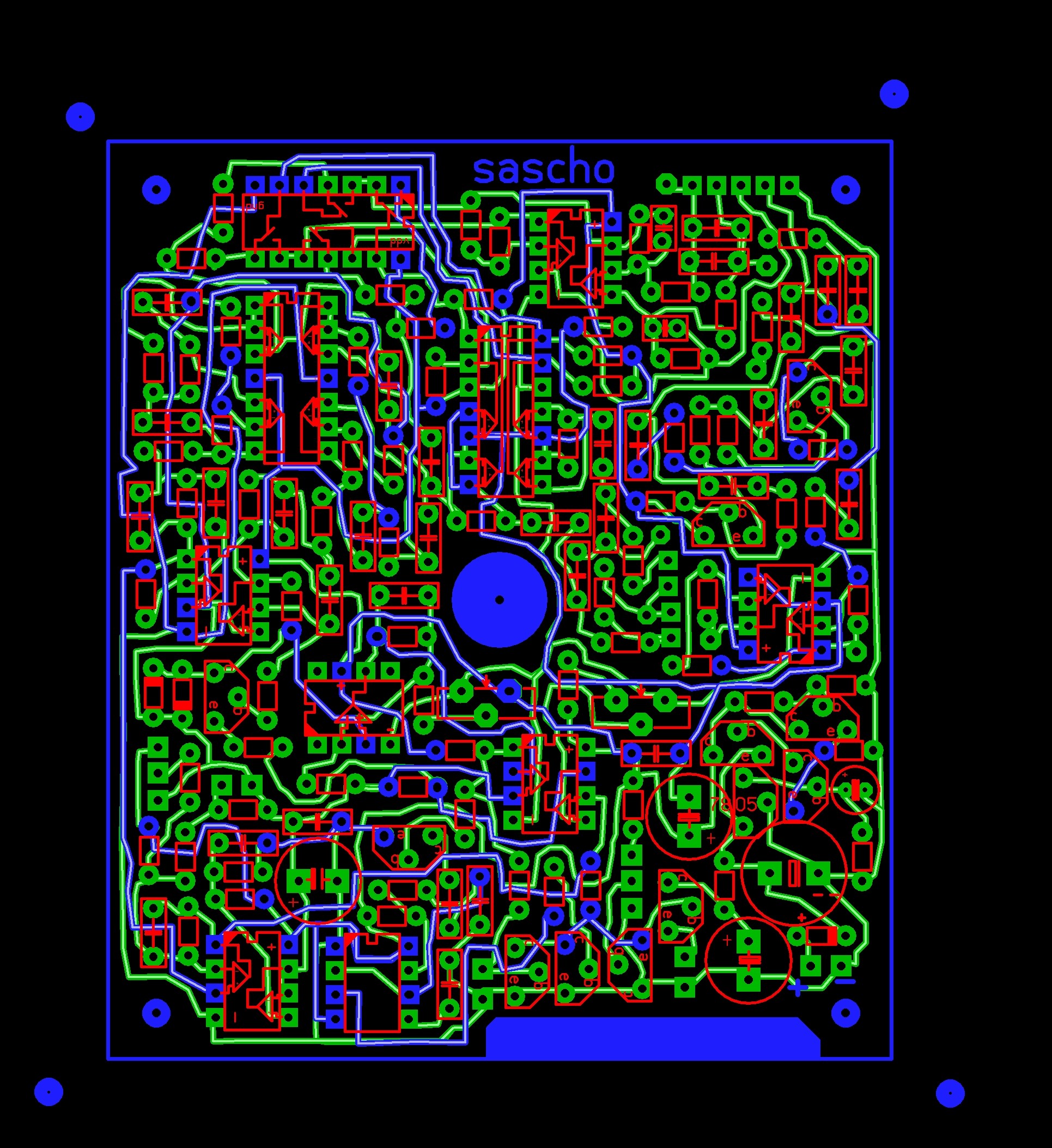

            • Thank you very much, Sasho. Do you have a picture of the board? I would like to take it.

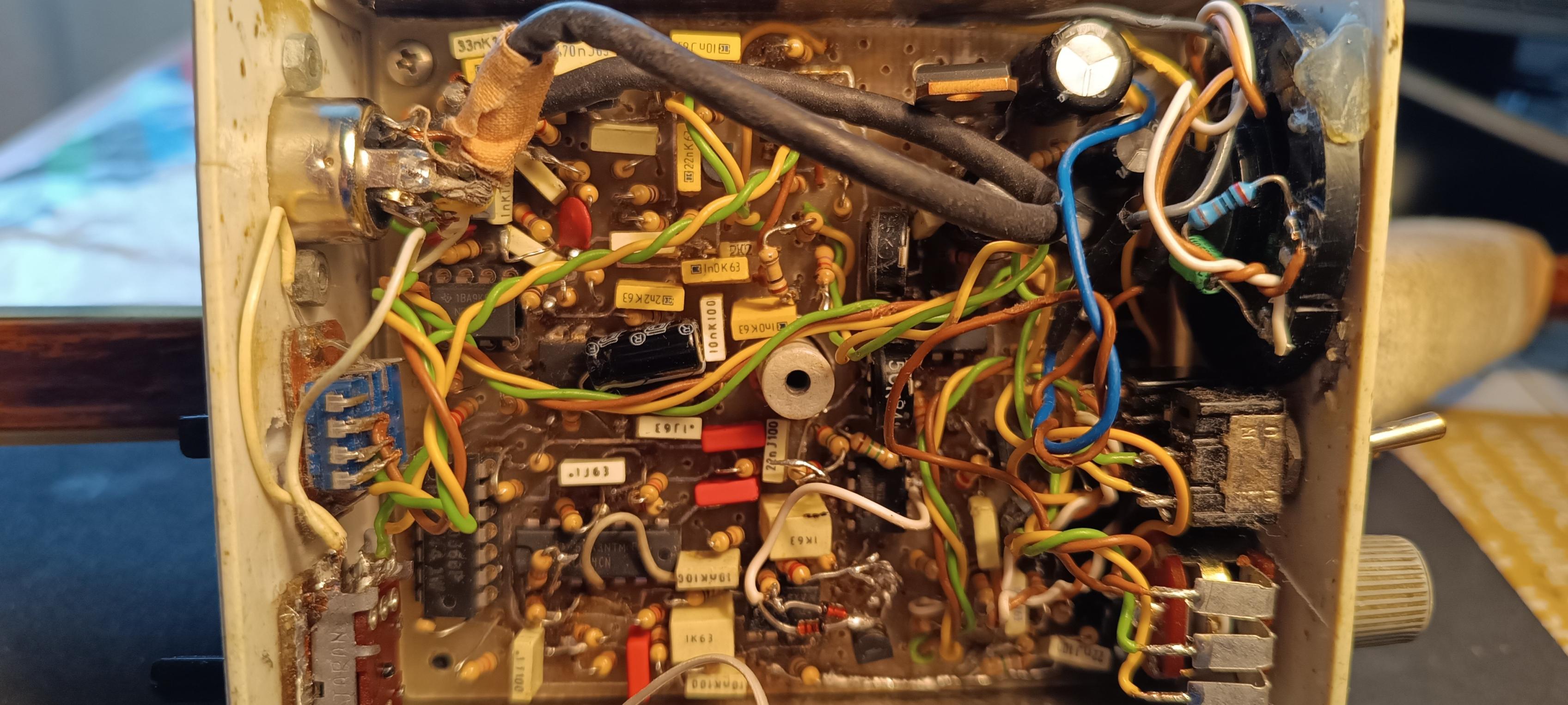

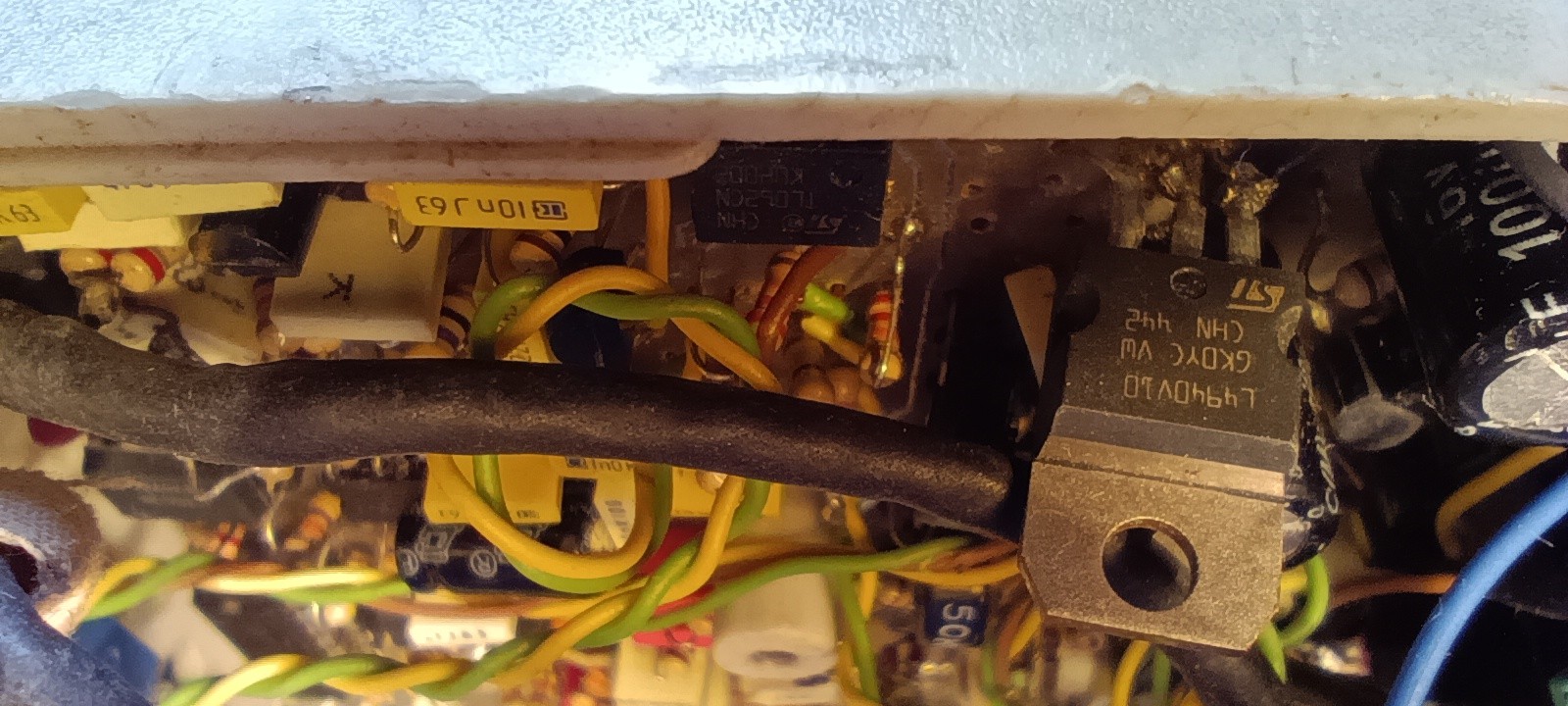

              • The board was designed with a discrete stabilizer. It was replaced with a L4940V10. There were other changes to achieve a good result. Click image for larger version
ID:	446068 Click image for larger version

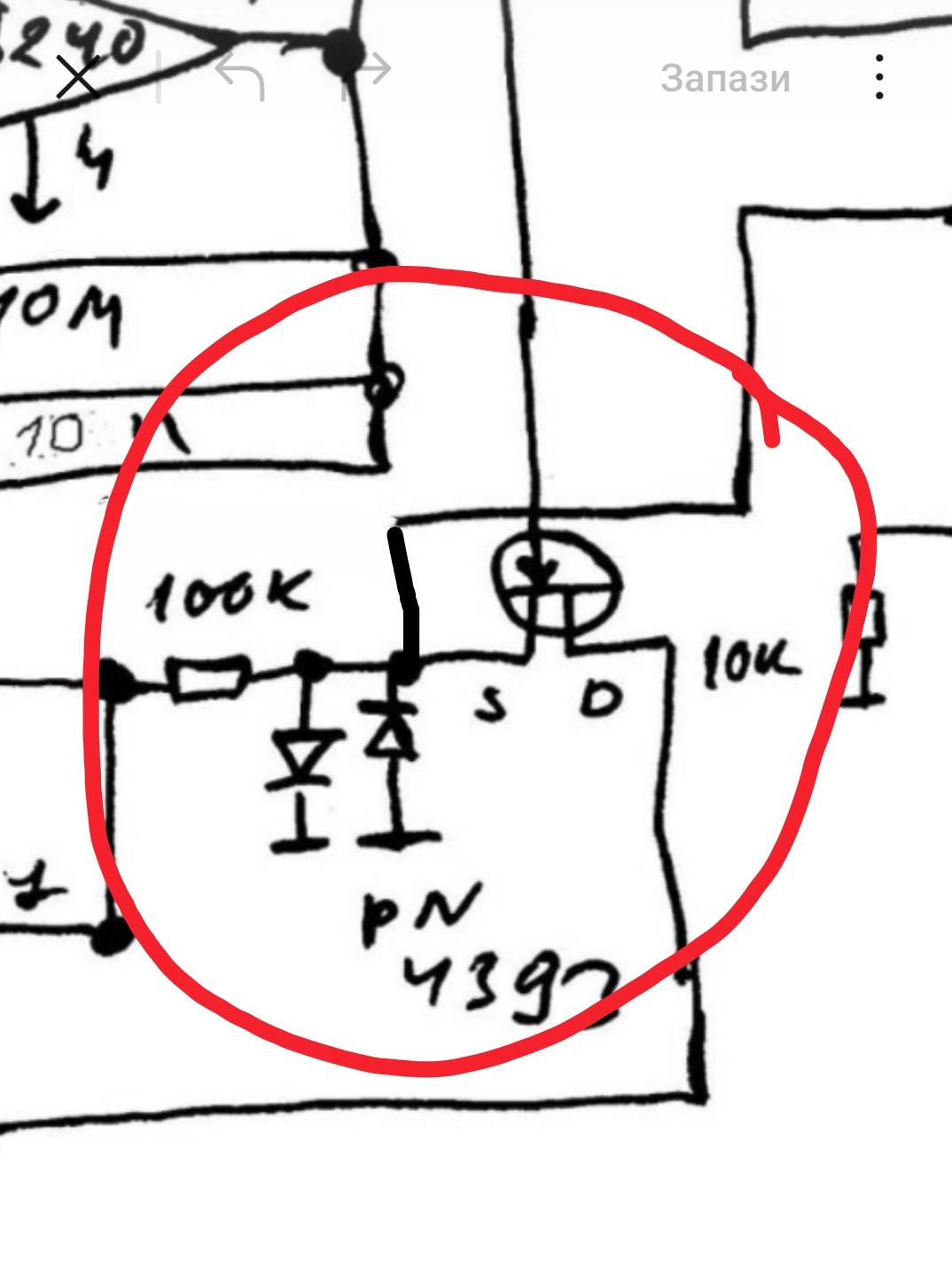

                • There are copies of TL Click image for larger version
ID:	446072 061 in which a trigger effect occurs with a strong signal. It is good to change the input connection as shown in the picture. The circuit works very well with operational amplifiers tls 272 instead of CA 3240.

                        • Hi Sasho, can you draw in red the connections of these hicks, first one hick after the transmitter and then the tl062 hicks that go to the ground balance and to the discrimination, and there is also a G and D switch there, what is it for? Yes, there is also a ground potentiometer there, the switches I assume are 4066, and for the inductance of the TX and RX coils or the number of windings, can you also write on the receiving coil, what are the values ​​of the elements at the beginning of 5532?
                          • I checked what i did years ago and corrected the diagram.It*s not pretty but it works. WARNING- this is not suitable for begginers and i don*t Click image for larger version
Name:	magnum audio -scs.jpg
ID:	446081 want to become a teacher.

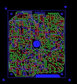

                            • Old version board with discrete stabilizer​. Click image for larger version
                              • Thank you very much Sasho, I would also like to ask about the resonance of the RX, is there a difference in the frequency up or down? If so, what is the difference? Or is it full resonance or is it equal to transmission?
