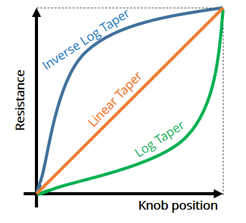

    Have you ever tried testing a 10k logarithmic potentiometer instead of a standard 10k linear potentiometer? Maybe that's better for you.​
    • I will try it with logarithmic, but with linear it depends a lot on how the threshold is set. With a 28 cm antenna, minimum threshold 10 cents Bulgarian coin with a diameter of 18.5 mm, it detects at 20 cm, with an increased threshold 25 cm, but when it is in a position between the increased and minimum threshold is 10 cm, it detects at 30 cm.
      • Hi Algan
        So, if you use a logarithmic potentiometer, you "stretch" the control's adjustment range slightly to make it easier to adjust between the minimum and maximum ranges. See the green curve in the diagram.
