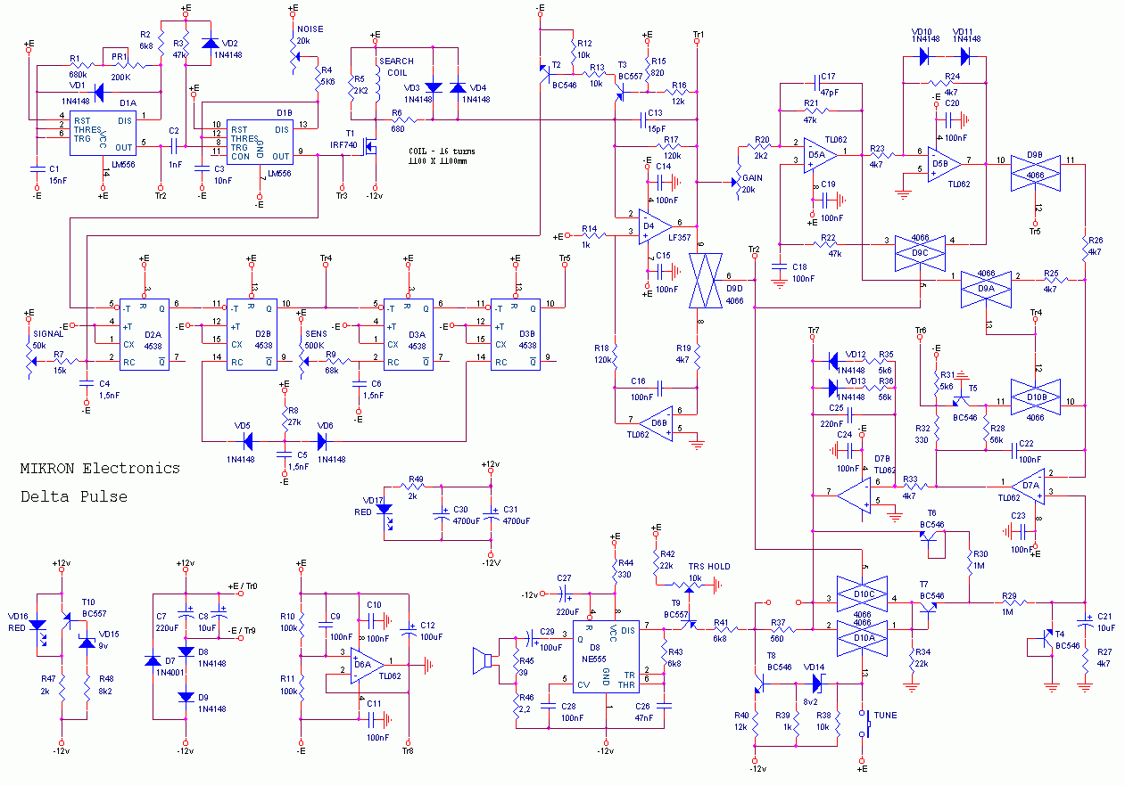

        Hi!
        I have found the polonaise schematic.
        It has the + input connected at +12V with a resistor.
        Therefore all ICs listed can not be used for your application.

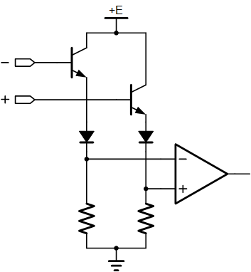

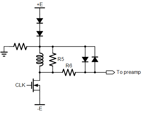

                      I use this NE5534 frequently, and it works perfectly in many designs.
                      The problem with the DP design is the preamp is operated with inputs all the way to +12v. So you need an opamp with true rail-to-rail inputs, or at least +rail inputs. This makes a sub difficult: you need an opamp with 24V supply, +rail inputs, 10MHz GBW, and a high slew rate to overcome a 24v saturation swing. On paper it looks like the TLE2071 will work so I don't know what the problem is with it.
                      You can also address the issue by changing the circuit to avoid needing a +rail opamp. Offset the coil like this:
                      ​Click image for larger version

                      Or offset the opamp inputs like this:
                      ​These are off the top of my head and may need some more thinking applied.

                        Hello Carl,

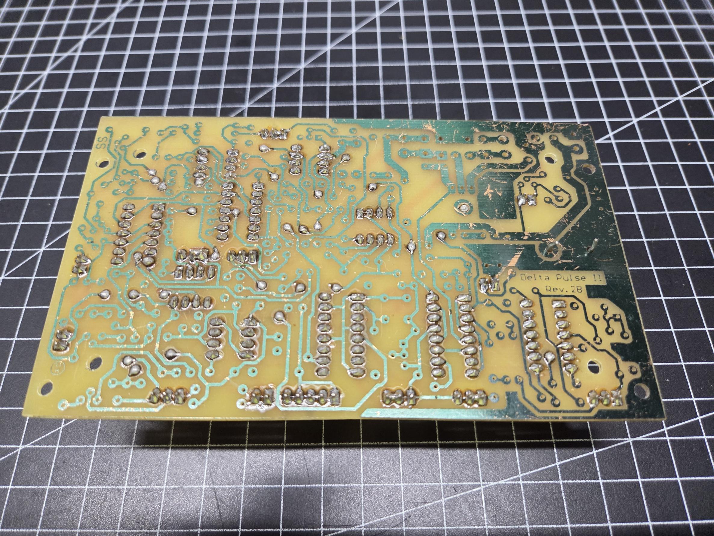

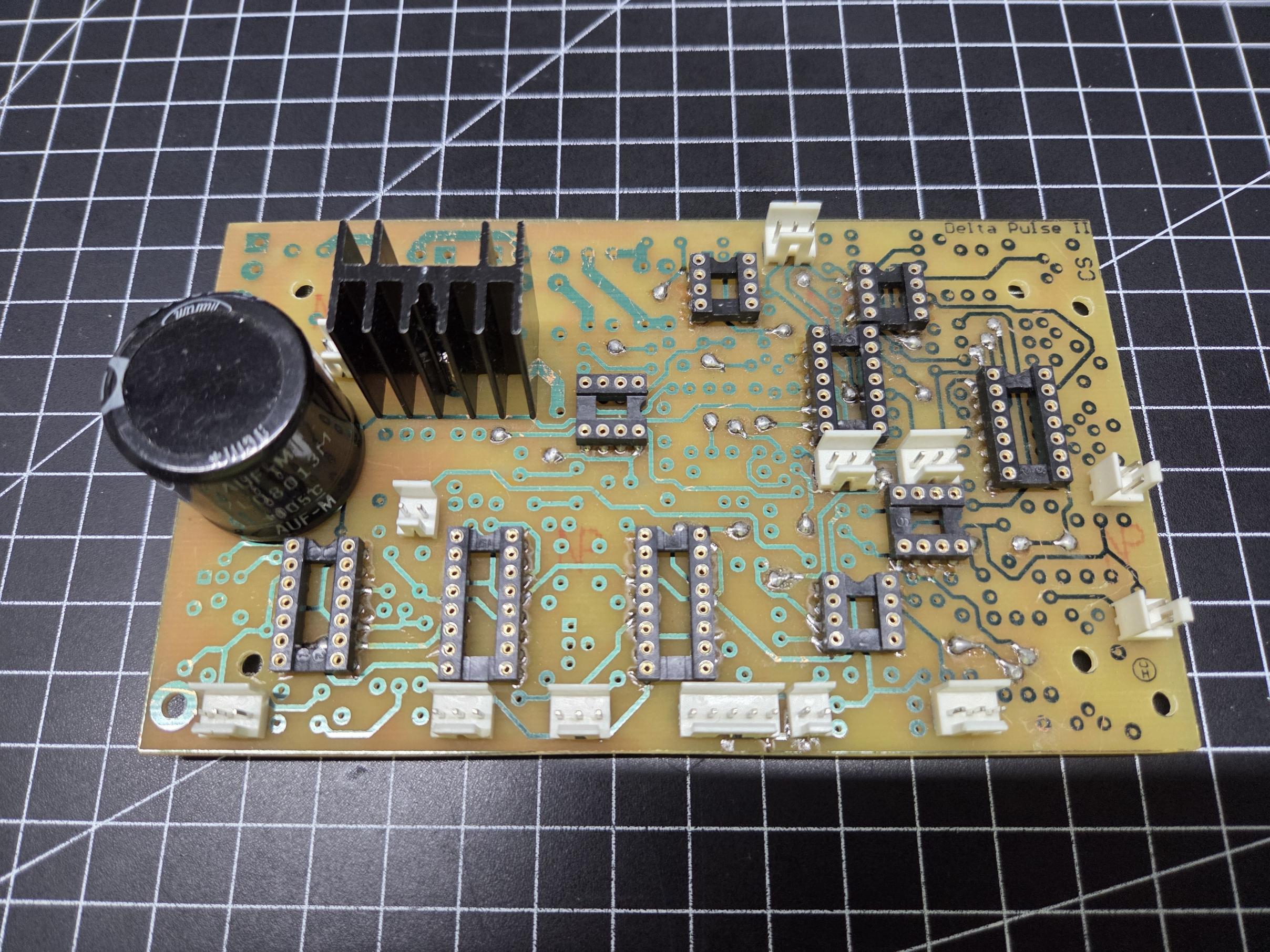

                        Your comments got me thinking, and I took another look at the DP's circuit diagram and the circuit board I made more than 20 years ago. As I understand it, it's a 12V circuit. The "-12V" is the negative terminal of the battery. I successfully built the DP, and the battery I used to power the detector was a 12V NiCad battery.
                        Here are some pictures of the PCB design I created back then on my kitchen table at home. I kept it for reference. I gave away all the other boards at the time. I designed the PCB using Protel99SE. It was one of the top EDA programs available at the time. The schematic I used to create the PCB was this one below.
                        Click image for larger version  Name:	20250815_182138.jpg Views:	0 Size:	666.7 KB ID:	440072 Click image for larger version  Name:	20250815_182222.jpg Views:	0 Size:	673.1 KB ID:	440071

                        • #72
                          You are correct, and that makes finding a direct replacement a little easier.
