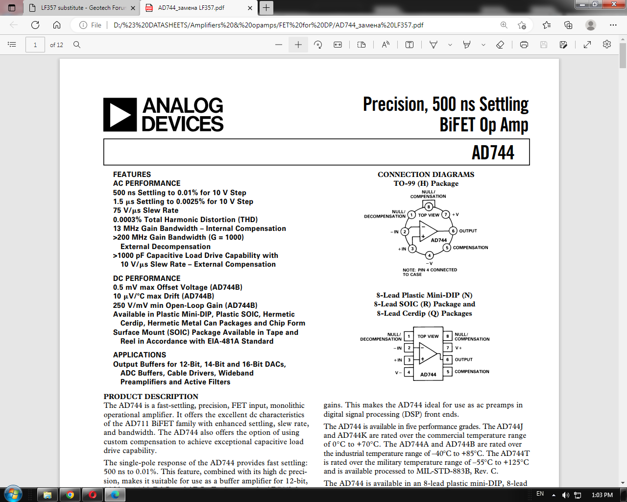

        AD744 AD845 LT1122 OP42

                The key indicators of an operational amplifier mainly include: supply voltage, input offset voltage, input offset current, open-loop gain, bandwidth, slew rate, common mode rejection ratio, power supply rejection ratio, input impedance, output impedance, noise density, and operating temperature range.
                Comparing the slew rate and bandwidth, the solution you provided has sufficient slew rate, but the bandwidth is lower than LF357.
                Thanks for your help.​

                            you are just beginner. i did keep the list from the forum. if you are not so happy in life it's the tragedy.
                            ​Click image for larger version
