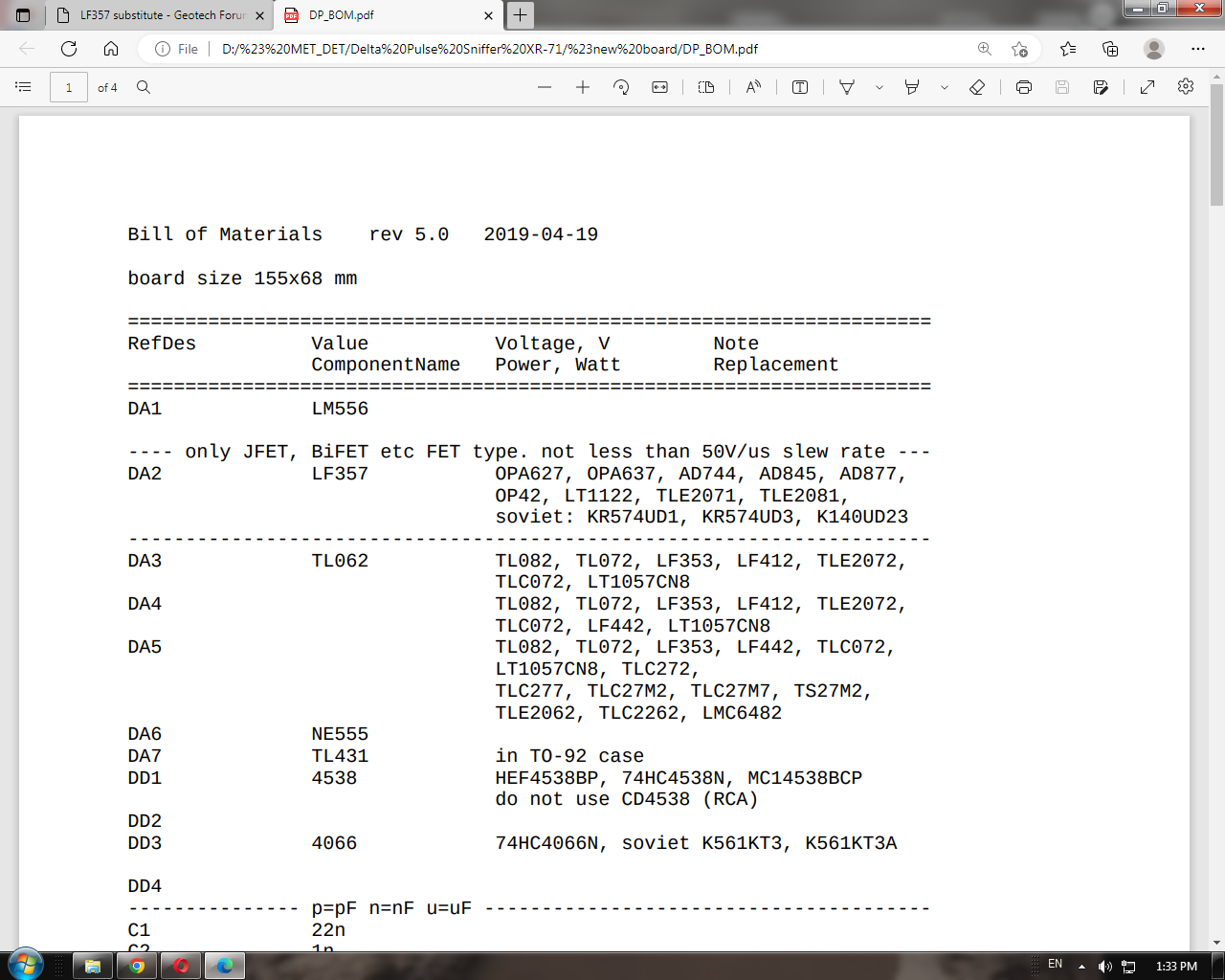

    Originally posted by nejdet View Post
    MAB357
    BOM file of DELTA PULSE. open and joy

                      Many questions for this famous LF357. This OpAmp is used in wide copied Delta Pulse MD. Input voltage in this schematic for this OpAmp is equal to Vcc. According the datasheet, this is possible TYPICAL but NOT guaranteed. If your part haven't typical value of "input voltage range", maybe this part is not fake! This project is for DIY projects - not for serious manufacturing. Serious solution is to use OpAmp with rail-to-rail input voltage range in this project.
                        Additional information for problem with LF357 for Delta Pulse MD. The company Texas Instruments continues to produce LF356 (July 2025) in convenient for DIY people DIP-8 case. In Delta Pulse MD the first delay is set in range 40-160us. For these relatively long delays, is possible to use LF356 (5MHz_12V-us) without problems. This not eliminates the problem with TYPICAL and WORST case of "common mode input voltage" range!

                            It is absolutely impossible to use LT1055 for Delta Pulse metal detector! Typical "input voltage range" is from Vee+3V to Vcc-3V. For Delta Pulse MD this parameter have to include Vcc. Read datasheets more carefully.
