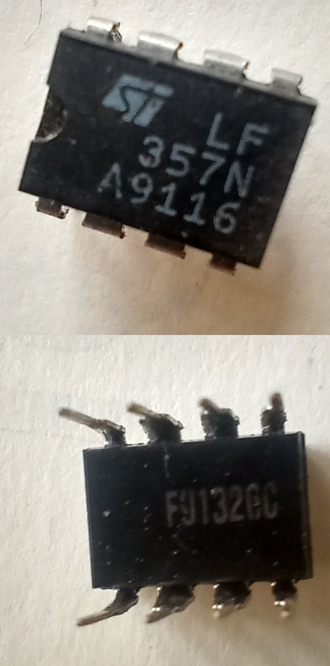

            I personally didn't like these and I've bought them and to me they are fake. If you find one like the one in this picture, I think it's original, but yes, they have been discontinued. Click image for larger version

              Hi algan,
              According to the label on the top, this part is manufactured in 16-th week of 1991 year (if the label is not fake). It will be more good if DIY peoples haves possibility to use contemporary parts.

                Hi GeoMax, I came across this by accident, but this store is in Germany and has LF357N. I think it is original, but until it is tested, it is impossible to say for sure.
                  Hello Algan,
                  I checked the website. It says it's old stock. But the price is also quite high.​
                    Originally posted by algan View Post
                    I personally didn't like these and I've bought them and to me they are fake. If you find one like the one in this picture, I think it's original, but yes, they have been discontinued. Click image for larger version  Name:	lffffffffff.jpg Views:	50 Size:	148.7 KB ID:	439966
                    i had learned pics of 357s. and yes, i noted original one has cropped edges legs. is it a rule for all 357s or not i can not know but it is sure good sign of to be the original.

                      • #41
                        take attention on the pics LF357 New Old stock - Geotech Forums (geotech1.com)​
                        • #42
                          thank you. my assumption, above, is right. the legs are cutted.
