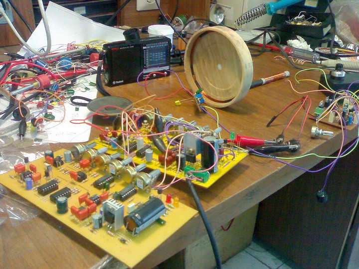

          Hi Jafar.
          I built the Delta Pulse years ago... it worked well.
          If I can find the circuit, which is in the storage room at home, I will turn it on and upload pictures of the waveforms of its various points here.​
          A photo of old Delta Pulses that I found on an external hard drive.
          from year 2009

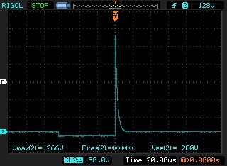

          • search coil​

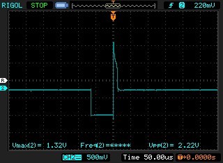

            • input preamp pin2 opamp
              ​Click image for larger version
Name:	input  preamp pin2.jpg
              • preamp pin 6 opamp
Name:	out put preamp pin6.jpg

                  Where did you connect the oscilloscope probe’s GND in this measurement? When I connect the GND clip to the circuit’s virtual ground, nothing appears on the screen — but when I don’t connect the oscilloscope’s ground probe, a waveform is visible.
                  • Originally posted by aft_72005 View Post
                    Hi Jafar.
                    Hello my friend, thank you for taking the time to send it. If it’s not a bother, I’d like to stay in touch with you more. If you have any way of contact available — such as email or Telegram — I’d appreciate it.
                    • Originally posted by Jafar View Post
                      Connect the oscilloscope ground to the virtual ground. I did the same thing.

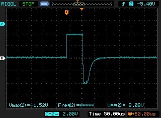

                      pin1 TL062
                        pin1 TL062
