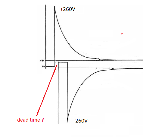

                      +/- 260 V , its that means you have 260V if you are using one MOSFET ?
                        Hi pito,
                        Bipolar sequentially pulses exists only with two MOSFETs - N-ch and P-ch
                          I mean you have +260V from one MOSFET and -260V from second MOSFET, its that correct ?
                            Yes, two peek voltages are generated from two MOSFETs. And adding of C17 (330pF) allows the starting of the TX coil peek voltages with equal delay after the end of the TX pulses. The capacitances of N-ch MOSFET are 3 times lower and this capacitor add some delay in switch-off moment for N-ch MOSFET for equalizing of this time for two MOSFETs.
                              is that so?
