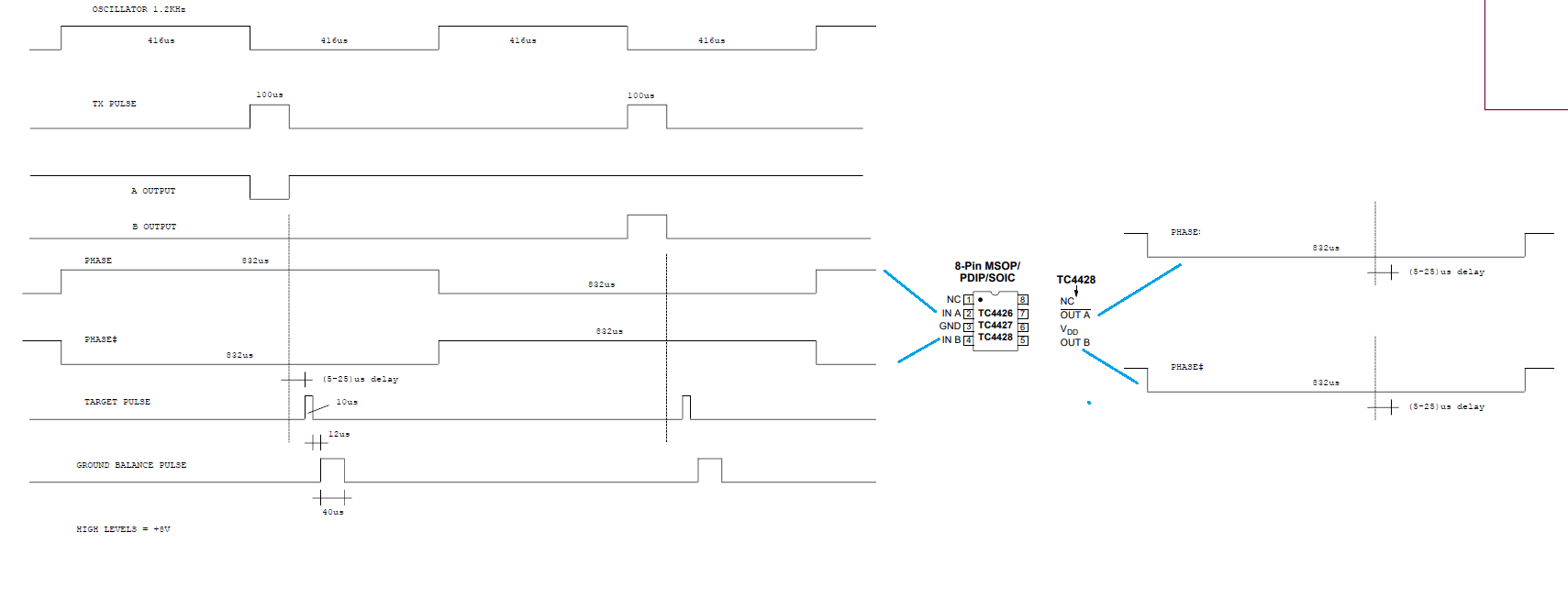

      Has anyone successfully replicated the circuit from the "New version of bipolar PI MD with GB and DD coil" thread? I’m trying to evaluate its reliability before building.
      Also, does anyone have oscilloscope screenshots or waveform data showing the signals and the timing of the measurement strobes? That kind of information would be extremely helpful​

          Hi vasilink,

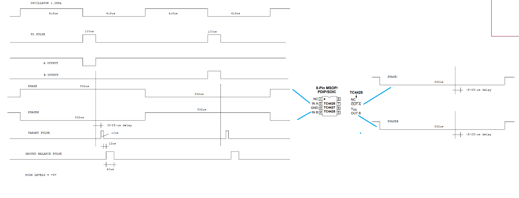

          Attached is information for timings of the control and strobe signals of this project. In the last version, only the duration of the GB strobe is increased from 40us to 44us for the moving of the GB point of the GB POT more near to the mid-point for ferrite target.

                  and timing on TC4428 outputs A and B ?
                  looks like they are the same

                    Hi pito,
                    The "A" output of TC4428 is with negative (-8V) output during TX pulse and controls the gate of P-ch MOSFET.
                    The "B" output of TC4428 is with positive (+8V) output during TX pulse and controls the gate of N-ch MOSFET.
                    Pulse on "A" output is generated during the high level of the signal "Phase".
                    Pulse on "B" output is generated during the high level of the signal "Phase #".
                    You forgot to have in mind that the signals "Phase" and "Phase #" are multiplied (logical AND function) with the TX pulse by the two 1N4148 diodes and the two resistors in the inputs "A" and "B" of TC4428.

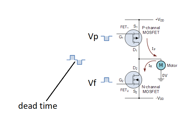

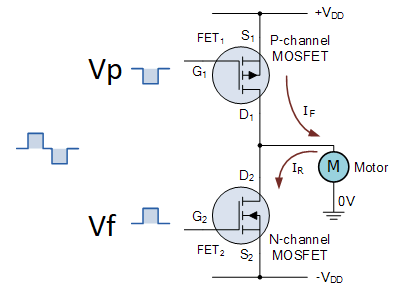

                      google complementary pair mosfet
                      This bipolar it is actually complementary pair amplifier, for square waves dead time is required , for sin wave not.​
                        Hi pito,
                        The case with bipolar PI with N-ch and P-ch MOSFET switches is very different from the case for motor control. The "dead time" is appr. half of the TX period in bipolar PI design!

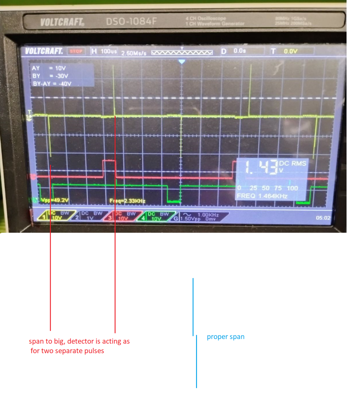

                          Hi Detectorist#1, we are eagerly awaiting a video with the final version of this project. Greetings!
                              Hi pito,
                              The right work of the bipolar PI MD is exact as the yellow (coil's voltage) , red (gate of N-ch) and green (gate of P-ch) traces on your picture. Yes, this detector is acting as with two separate pulses in two opposite directions. This is clear explained in ITMD3 book.

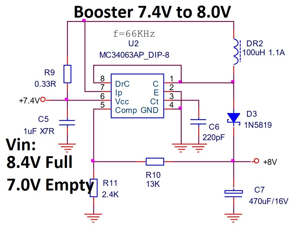

                                Hi Detectorist#1
                                The input is a 2-cell 18650 Li-ion battery. Each cell’s full-charge voltage is about 4.2 V, empty around 3.5 V, and the nominal voltage is 3.7 V. In the power supply, U2 (MC34063AP) is used as a voltage booster (step-up). The input voltage is labeled 7.4 V, but in reality, it ranges from about 8.4 V when fully charged down to about 7.0 V when empty, and the output is set to 8.0 V. When the batteries are full (Vin = 8.4 V), this cannot operate as a boost converter anymore. A quick and easy fix is to increase the boost output to +9.0 V or +10.0 V (±9 V or ±10 V).

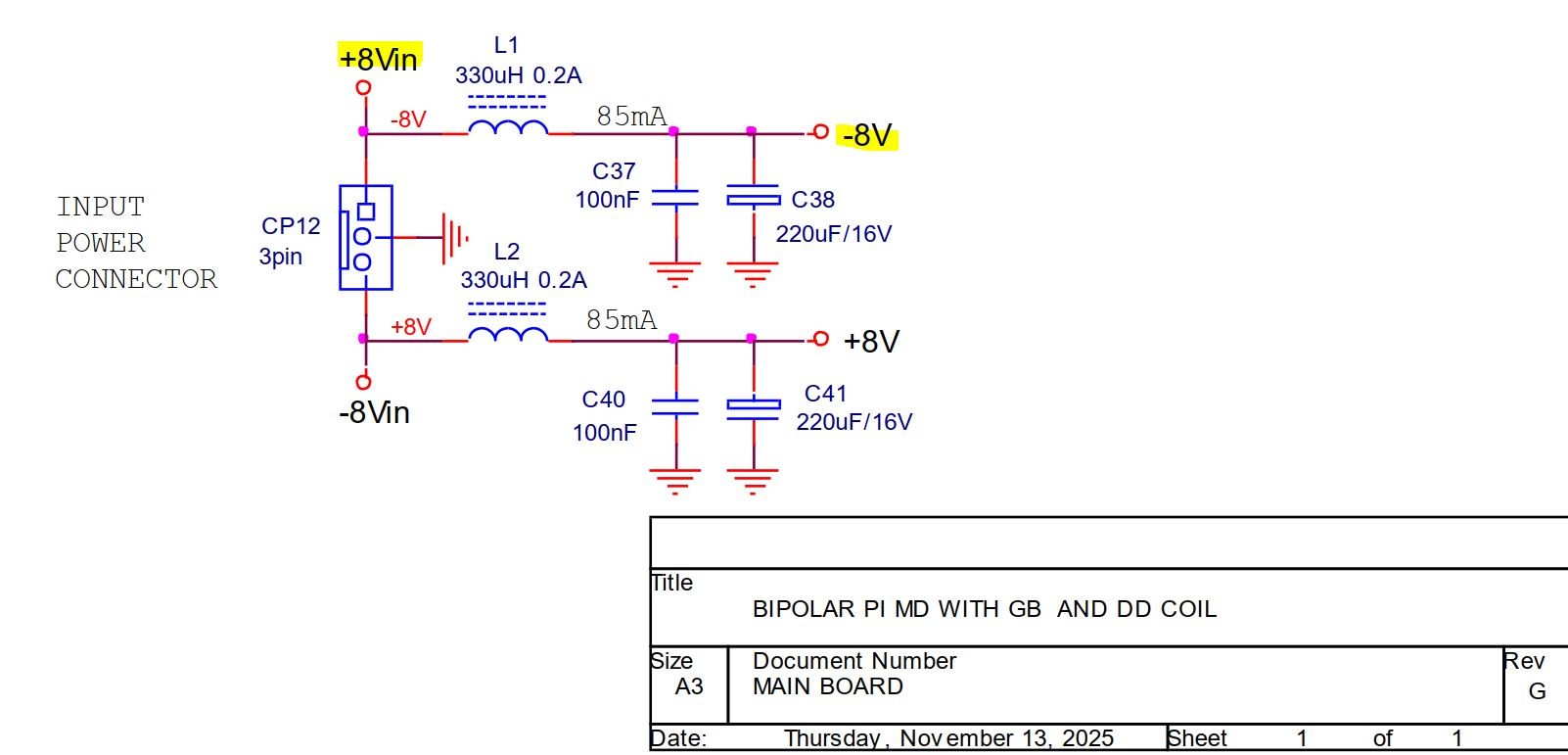

                                There is another error in the Mainboard schematic (bottom right corner): +8 V is connected to −8 V through L1 (330 µH). It looks like an LC filter, but it’s connected to the wrong power rail.
