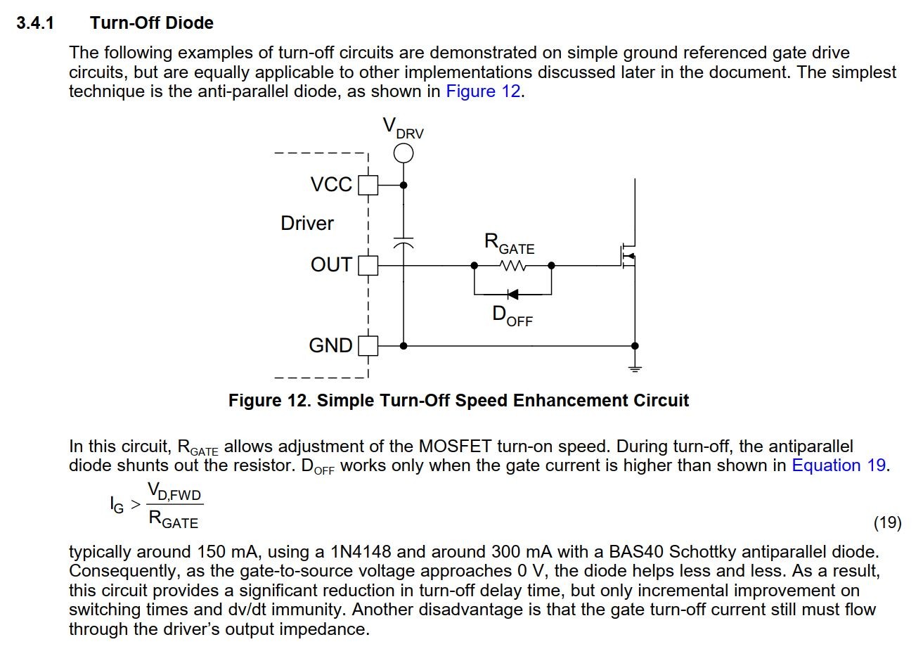

      sorry for late response. yeah, i know the boost converter work when the input voltage is 8.4V (but efficiency drops) and the output = input - diode voltage drop but increasing voltage to ±9V solve this without exceeding the voltage limit for TC4428CPA since 18V is the max recommended supply voltage (Absolute Maximum voltage is 22V). But either ±8V or ±9V works fine.
      about the Li-po voltage it depends on battery internal resistance and current draw from battery, but 2.75V is completely discharged. to avoid damaging battery it is better to set low battery 20% percent (maybe somewhere around 3.0V or so).
      i was looking at schematic and noticed adding parallel Turn-off diode across R3 and R33 (MOSFET Gate) increase turn-off speed.

      TC4428CPA (U5) pin5(VDD) connected to +8V through series resistor R1 (1Ω), same thing happened to pin3(VSS). i think it is better to directly connect MOSFET driver supply pins to ±8V and keep the 1Ω resistor for MOSFET source pin, because during transient current peak probably cause voltage drop across U5.

          3. Adding of diodes in parallel of gate resistors not improve nothing . Output resistance of TC4428A is 7oHms (not zero) and no improving in OFF timing of the MOSFETs

                3) you are right. i didn't consider the Output resistance of TC4428A. The improvement is 30% but for PI metal detector it's negligible.
