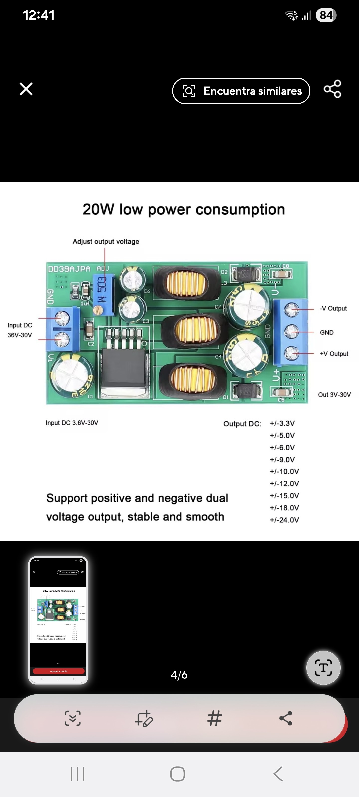

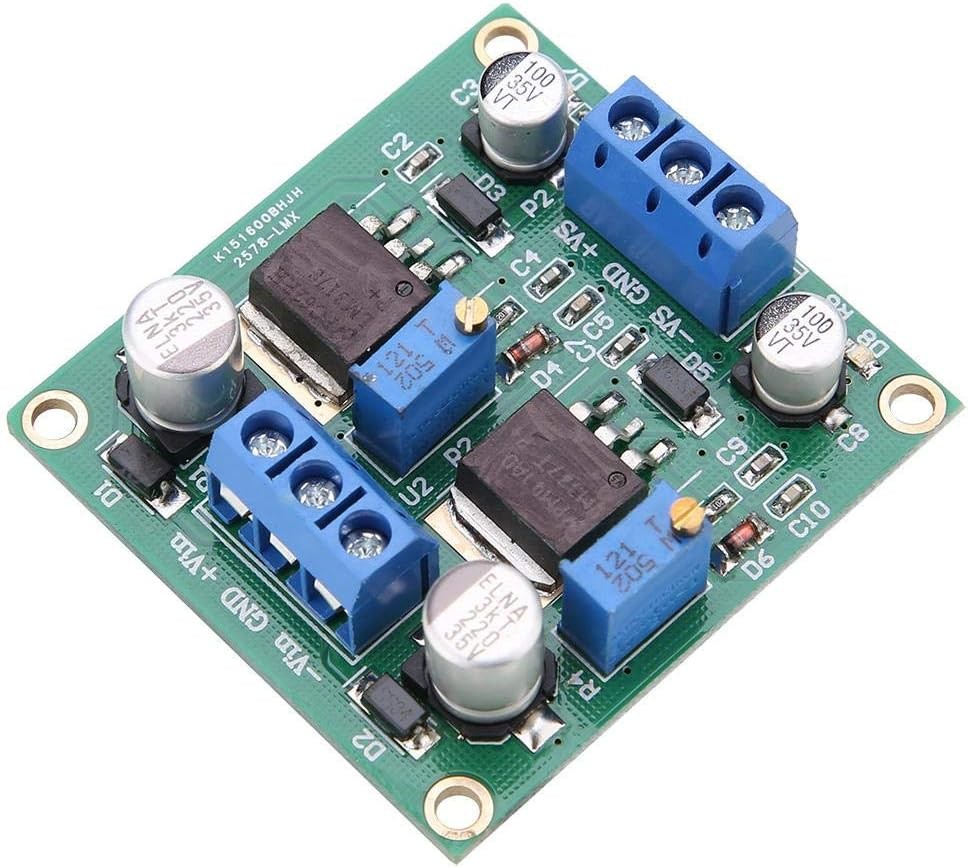

    Is this kind of adjustable regulator a good option to provide Positive/Negative voltages for PI detectors?

    I'm searching for something already made to use as power supply for my test projects and thought this could work, please give me your opinion.

    I prefer using Mornsun but add cost.. https://www.ebay.co.uk/itm/334710152357
      Hi cristiano.sar,
      I also use for test projects this type of bipolar regulated power supply with 317-337 regulators. In front with 2x10VAC 6VA transformer + bridge rectifier + 2x2200uF/35V capacitors. The advantage of this type linear regulators is the absent of noise from DC/DC pulse converters.
        Hi Cristiano,
        If you are using this module, you will need a power source (at least 2 batteries) with a center tap to obtain an input voltage from +/- and GND.​

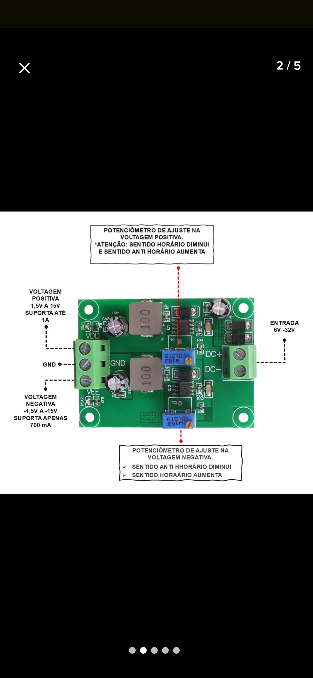

          Thank you. I posted the wrong photo. The one that I want to use is this one. Click image for larger version  Name:	Screenshot_20251224_222242_Mercado Libre.jpg Views:	0 Size:	185.0 KB ID:	444078
            I have one like that and it works very well.
              Beside the positive voltage and ground, which you can get from a battery, you still need a source of negative voltage. And since the regulators in this circuit are linear, there has to be a 2 volts difference between input and output for each voltage (+ / -) in order for this circuit to workcorrectly.
                Yours actually is different because it doesn't require negative voltage supply in order for it to produce regulated negative voltage.

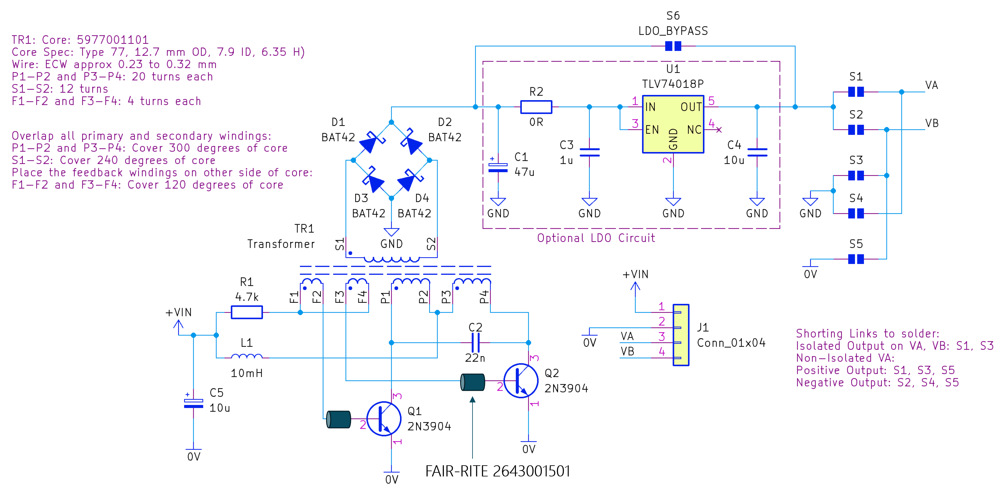

                  I found this schematic in another forum, it is an isolated, low noise power supply (may be the input need to be adjusted to accept higher voltages). Is it a good option to use in PI detectors?

                    All ready-made modules sold on various sites can only be used in pulse detectors that have a P-channel mosfet, e.g. SURF-PI,BARACOUDA, etc.,!NOT! in MINIPULSE, GS4, HAMMERHEAD ..and others that have the coil ground connected to + of the battery​.
