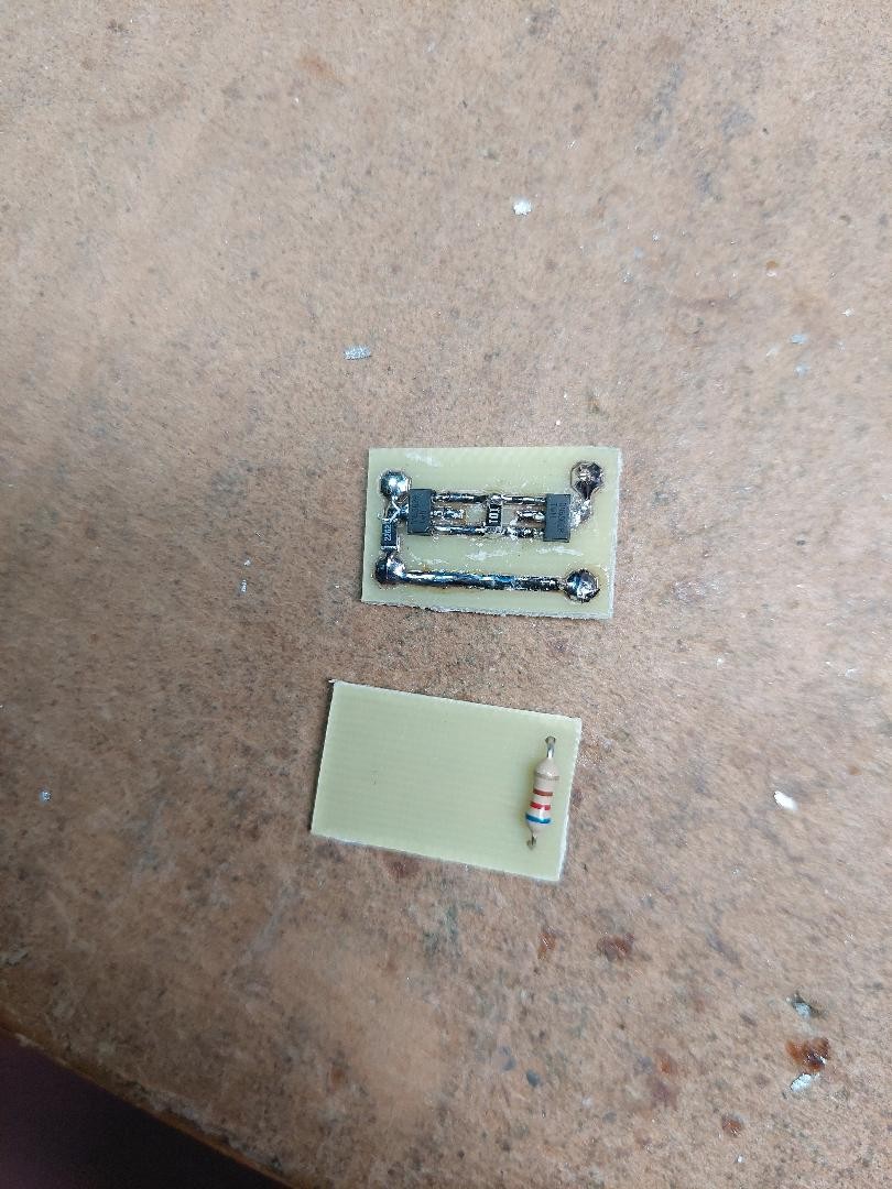

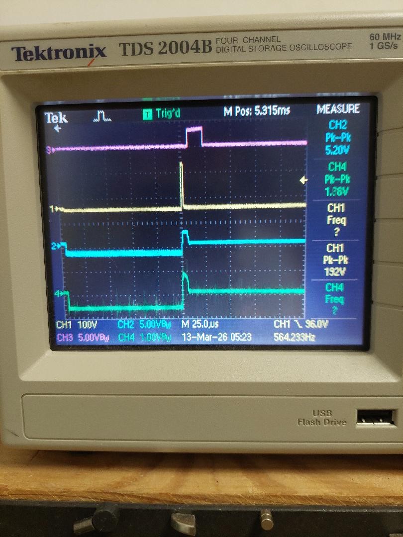

      I got it to work using DN3535 mosfets. My circuit uses a 180v snubber circuit, so the assumption of overvoltage is probably correct. The transistors were running warm. This blocker circuit works the best out of the ones that I have used. By the way ML didn't invent this current limiter. See fig4 in attached pdf. Photos of the add on blocker pcb and scope shot.

      Hi Altra. Could you please attach the diagram again, as the PDF file you're referring to doesn't exist?

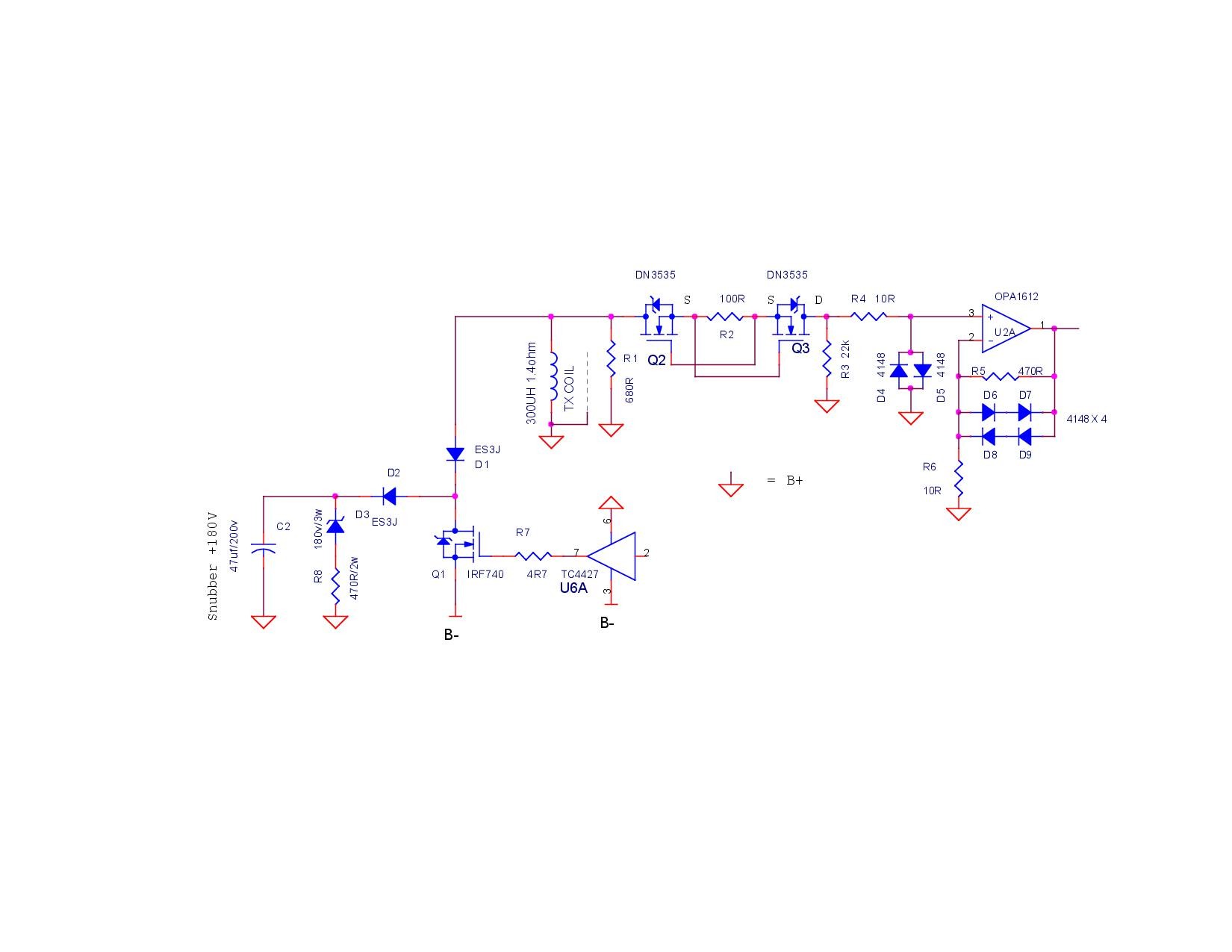

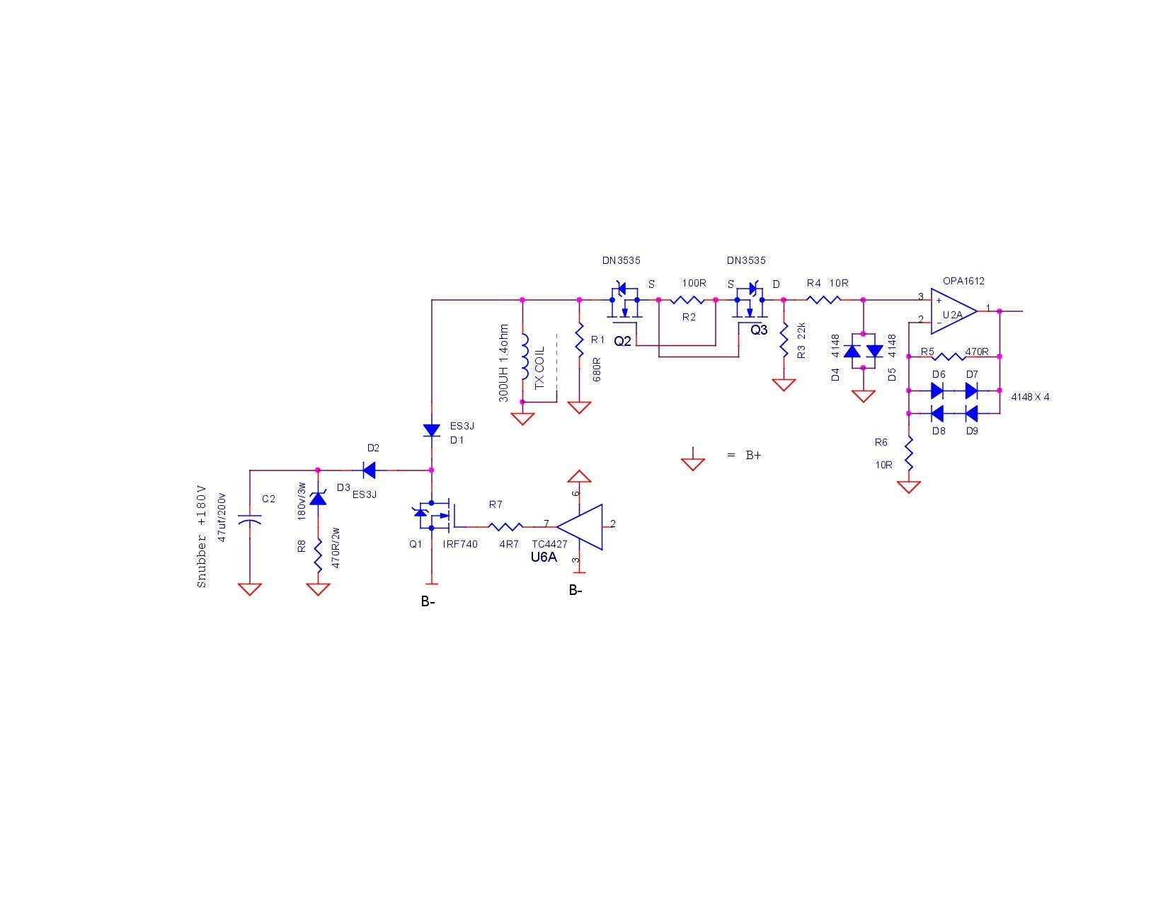

            This is the test circuit with snubber
            Click image for larger version  Name:	PI frontend.jpg Views:	0 Size:	98.4 KB ID:	447675

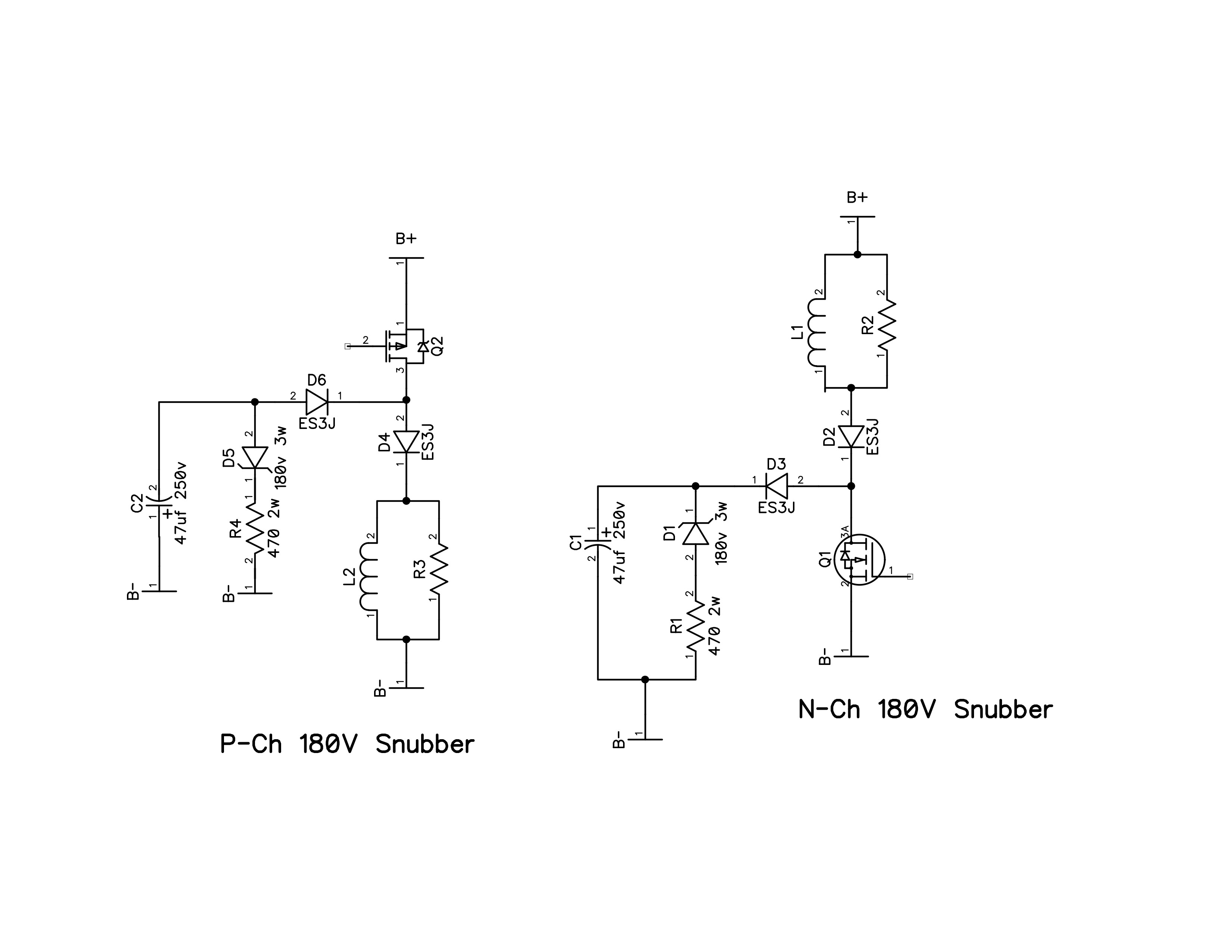

                  Here's the variant for P-type and N-type MOSFETs. It's a schematic that Altra published a while ago.
                  That can help if you want to reduce the voltage to 180V and avoid overheating the MOSFET.

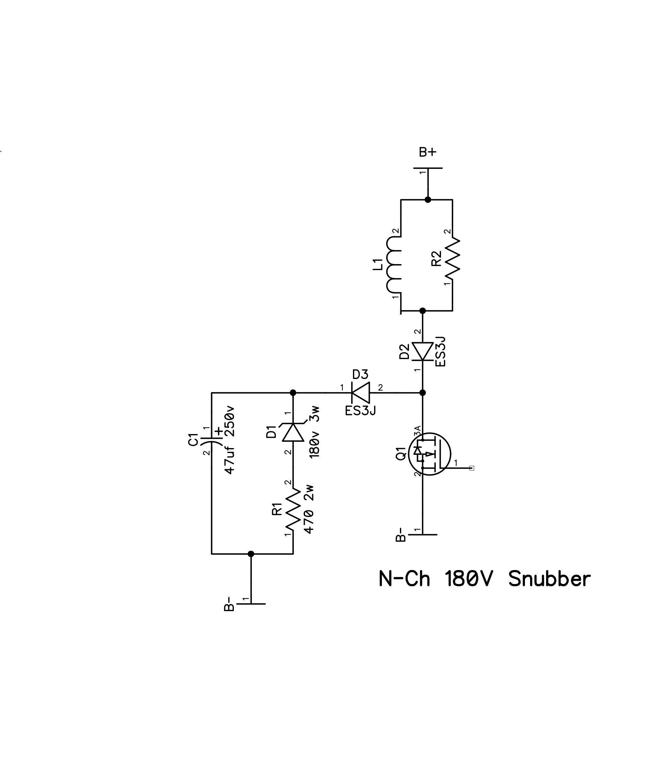

                      Hi Altra.
                      I have two questions about the snubbers shown in the two attached files. Which one is correct? I see that in one case, the 47uF capacitor is connected to GND (B+), and in the other, it's connected to B-. I also notice that in one case, the snubber is in parallel with the MOSFET, and in the other, it's in parallel with the inductor. Could you clarify these points for me, please?​
                      Regards.
                      • #56
                        Originally posted by eduardo1979 View Post
                        Hi Altra.
                        Regards.
                        Hello Eduardo, it will work either way. But the correct connection would be across the coil or snubber connected to coil ground. This goes for the P or N configuration.
