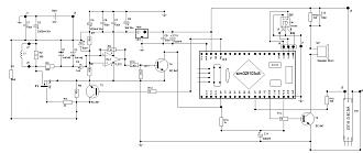

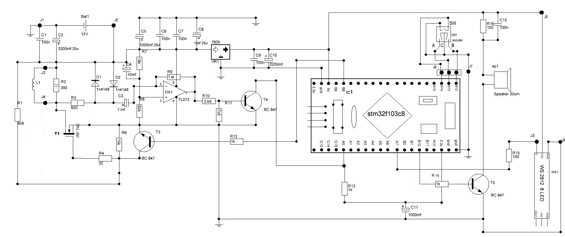

    Hi, Gdane, I am also interested in similar projects and would like to learn more about how signal processing is done. Can you explain what happens in the circuit chip, and here the samples cannot be measured with an oscilloscope, or are they sampled in the chip according to the written code? Click image for larger version  Name:	335971683289286427.jpg Views:	0 Size:	153.0 KB ID:	444554

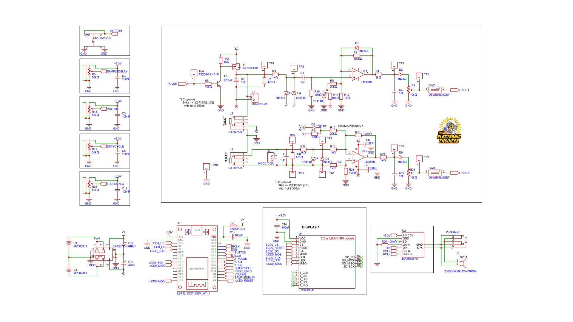

          Sorry, don't know how those links got abbreviated. Here they are again, hopefully in their entirety:
          For those who can't seem to access the Element14 design, the schematic is attached.
Name:	Element14 Schematic.png

              Yes indeed samples of the RX are measured by the MCU, which is also responsible for generating the TX pulse. What would stop you from also measuring RX with an oscilloscope?
