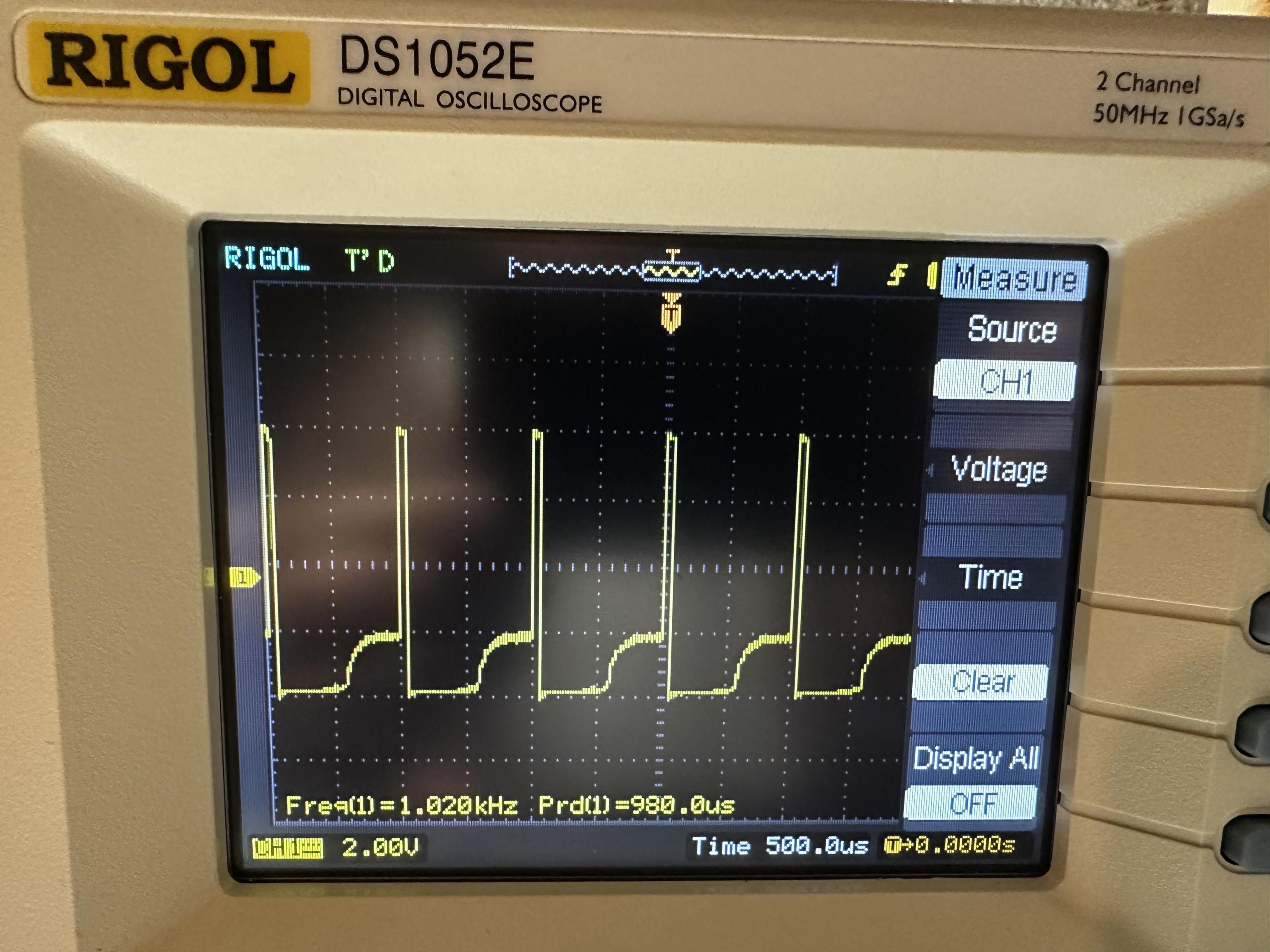

                Thanks for the advice Qiaozhi i. I've made good progress on my build. My damped (3R3) coil flyback voltage seems to match Fig. 4-9 from the book so that's promising (image attached). I've moved on to Step 10 and built the pre-amp, but I'm concerned by what I'm seeing on TP6. I was expecting somethiing like the "Preamp Output" waveform from Fig. 4-14, but what I'm seeing looks more like a pulse (image attached).
                One thing to note is that I used a 20k resistor for R9 instead of 22k because it was all I could find. Is that going to be a problem, and could it explain the TP6 output?
                I also wanted to ask for advice about how to incorporate RX DSP into the Arduino Nano PI design. What is the best place to connect the ADC on the PCB to acquire samples?
                Note that ultimately I'll be incorporating a STM32 board that only tolerates 3.3V on its ADC input, so any advice about how to condition the RX signal for acquisition using this board would be greatly appreciated.

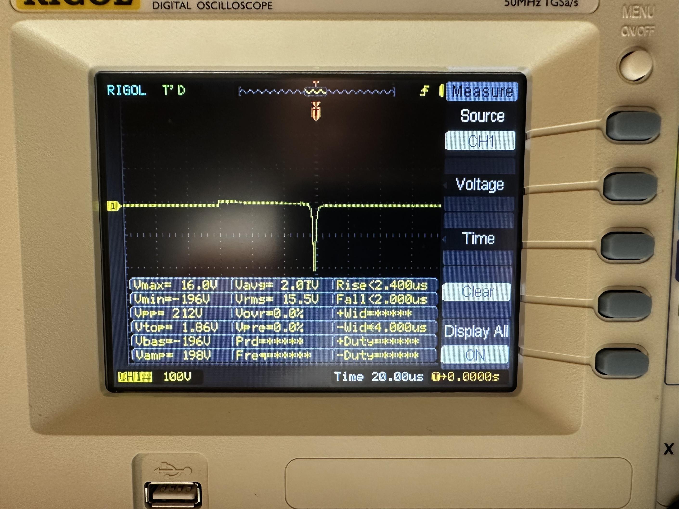

                  I'm not sure what I'm looking at in the attached images.
                  The coil flyback voltage voltage should be about -200V, but the channel amplitude is set to 2V.

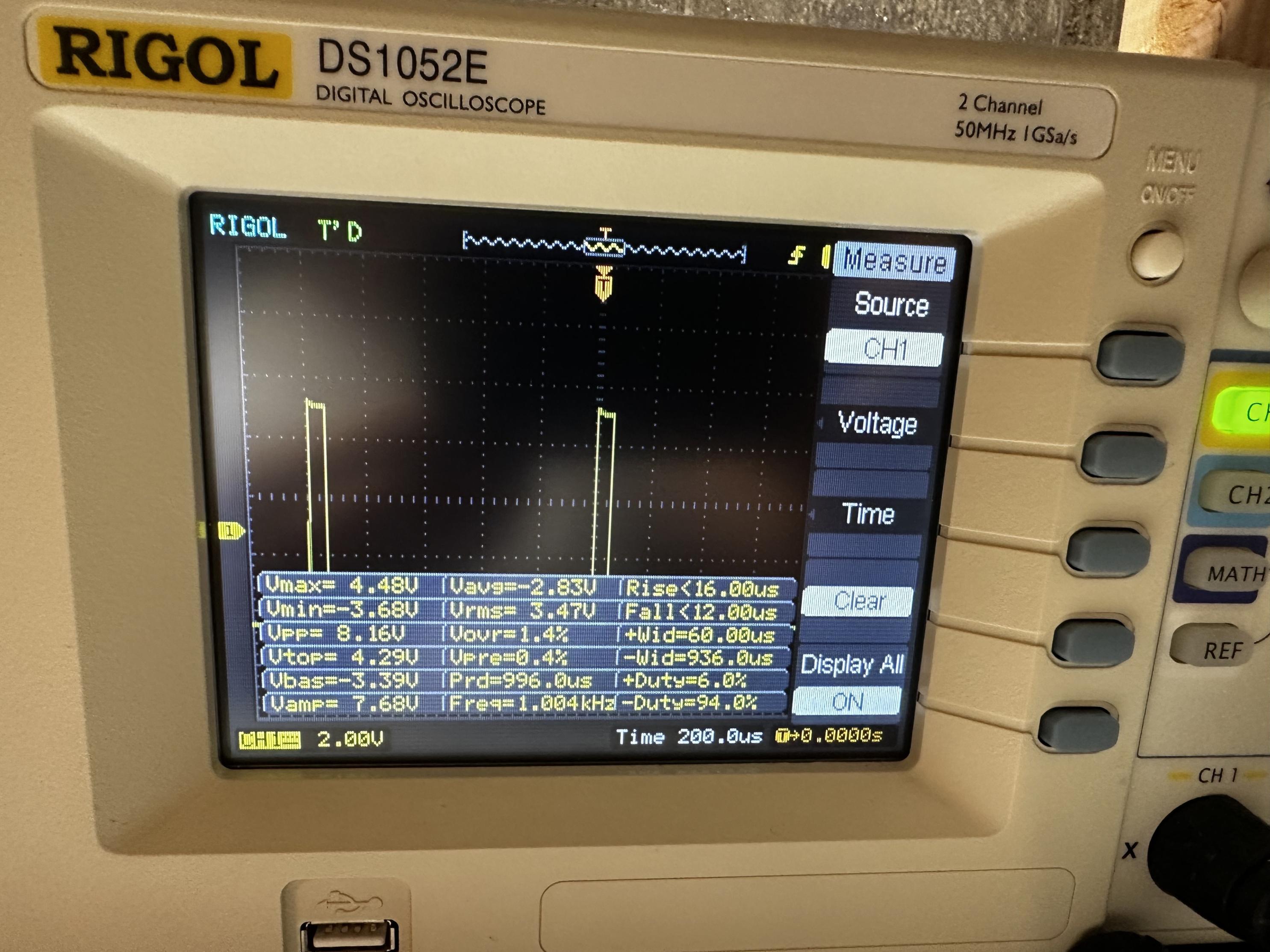

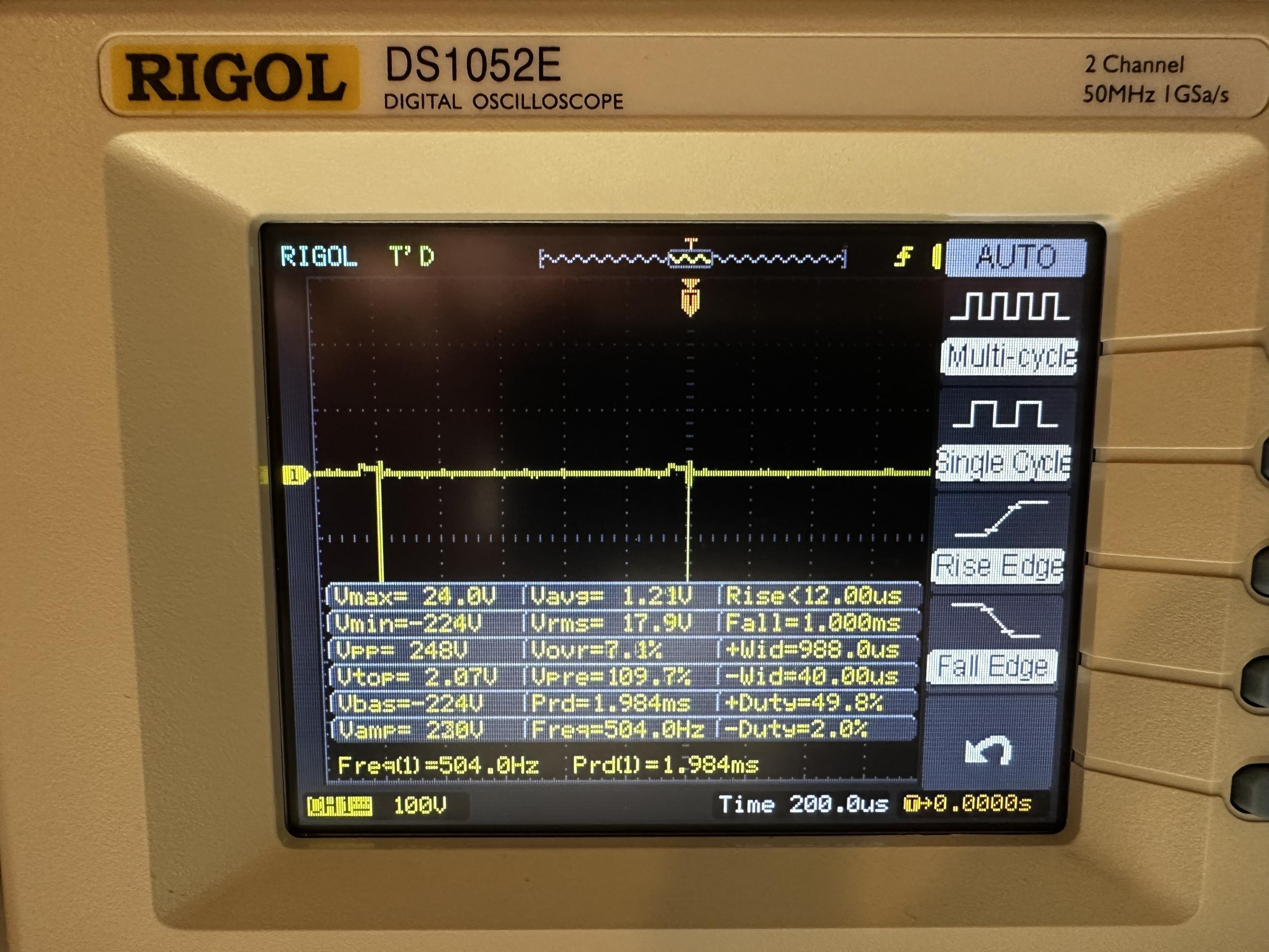

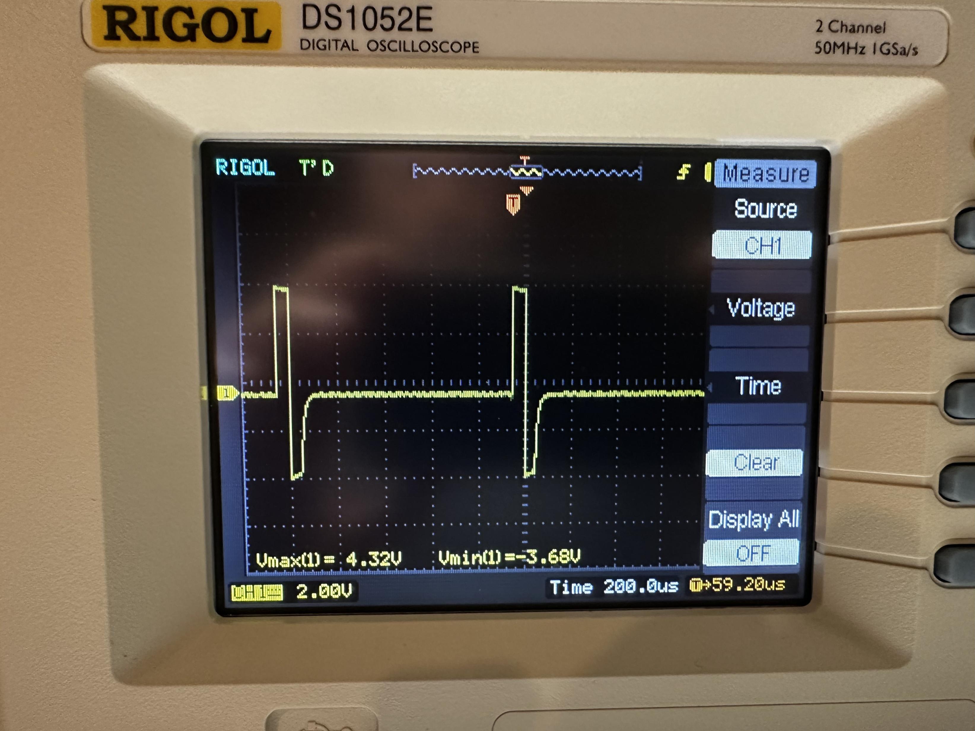

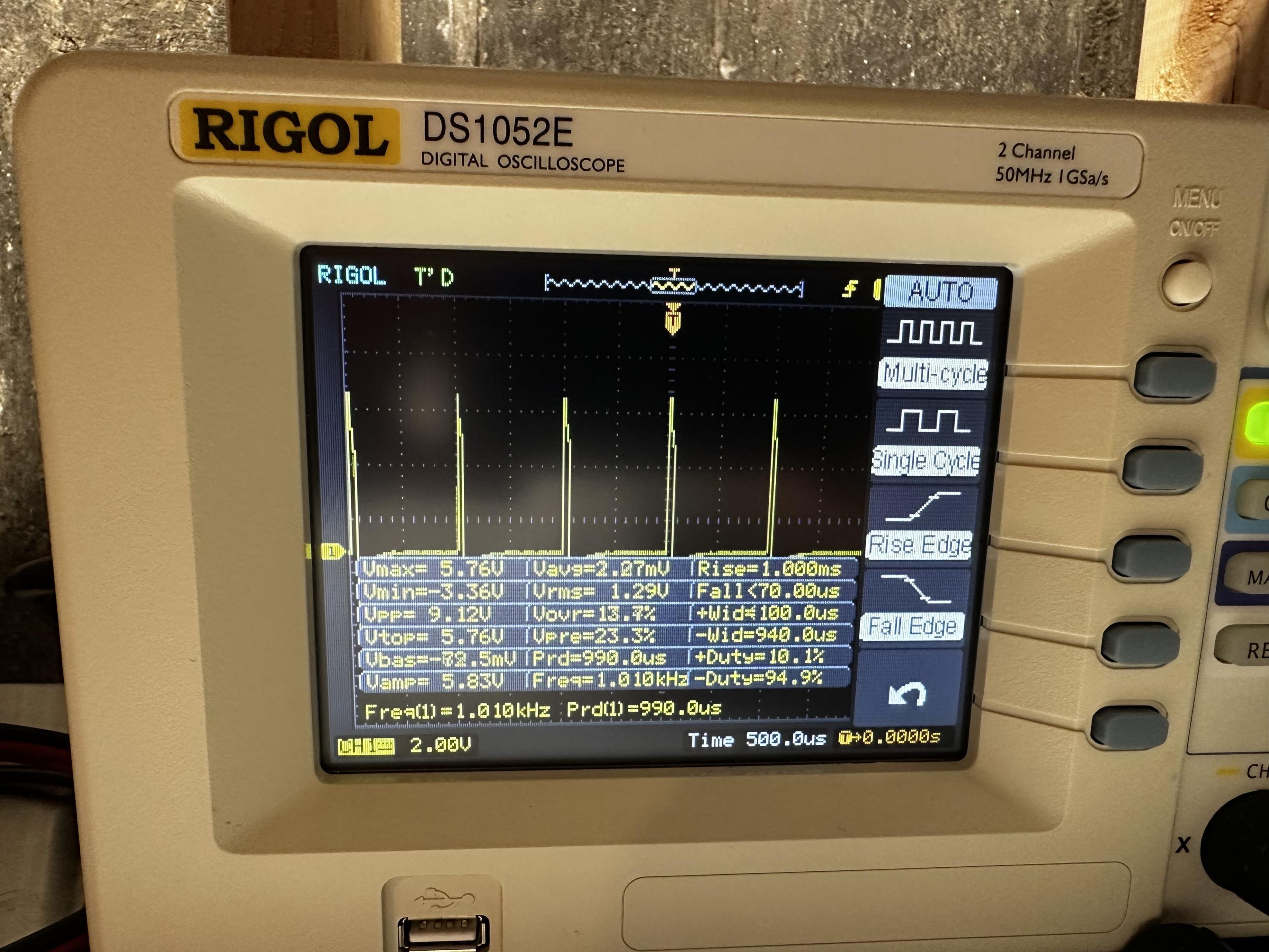

                    Qiaozhi Attaching images showing full measurements. Apologies in advance for my limited understanding of how to effectively use my oscilloscope. Hopefully this makes sense.
                    - Without the damping resister installed, the flyback is showing voltage range +24V and -224V.
                    - With a 3R3 damping resistor installed, the flyback is showing voltage range +5.76V and -3.36V.
                    - TP6 is showing +4.48V to -3.68V range in a pulse waveform with jumper on pins 2 & 3 of PL4 per the book.
                    Note that I adjusted R12 to remove the hump preceding the pulse, which is how I interpreted the instructions in the book:
                    "adjust R12 so that the preamp output settles to 0V"
                    Just doesn't seem like TP6 should show a pulse?
                    Flyback with damping resistor removed:
                    Click image for larger version  Name:	IMG_7706.jpg Views:	0 Size:	617.9 KB ID:	445619
                    Flyback with 3R3 damping resistor:
                    Click image for larger version  Name:	IMG_7708.jpg Views:	0 Size:	601.6 KB ID:	445620
                    TP6 with sample delay pot jumper installed:
                    Click image for larger version  Name:	IMG_7708.jpg Views:	0 Size:	601.6 KB ID:	445622

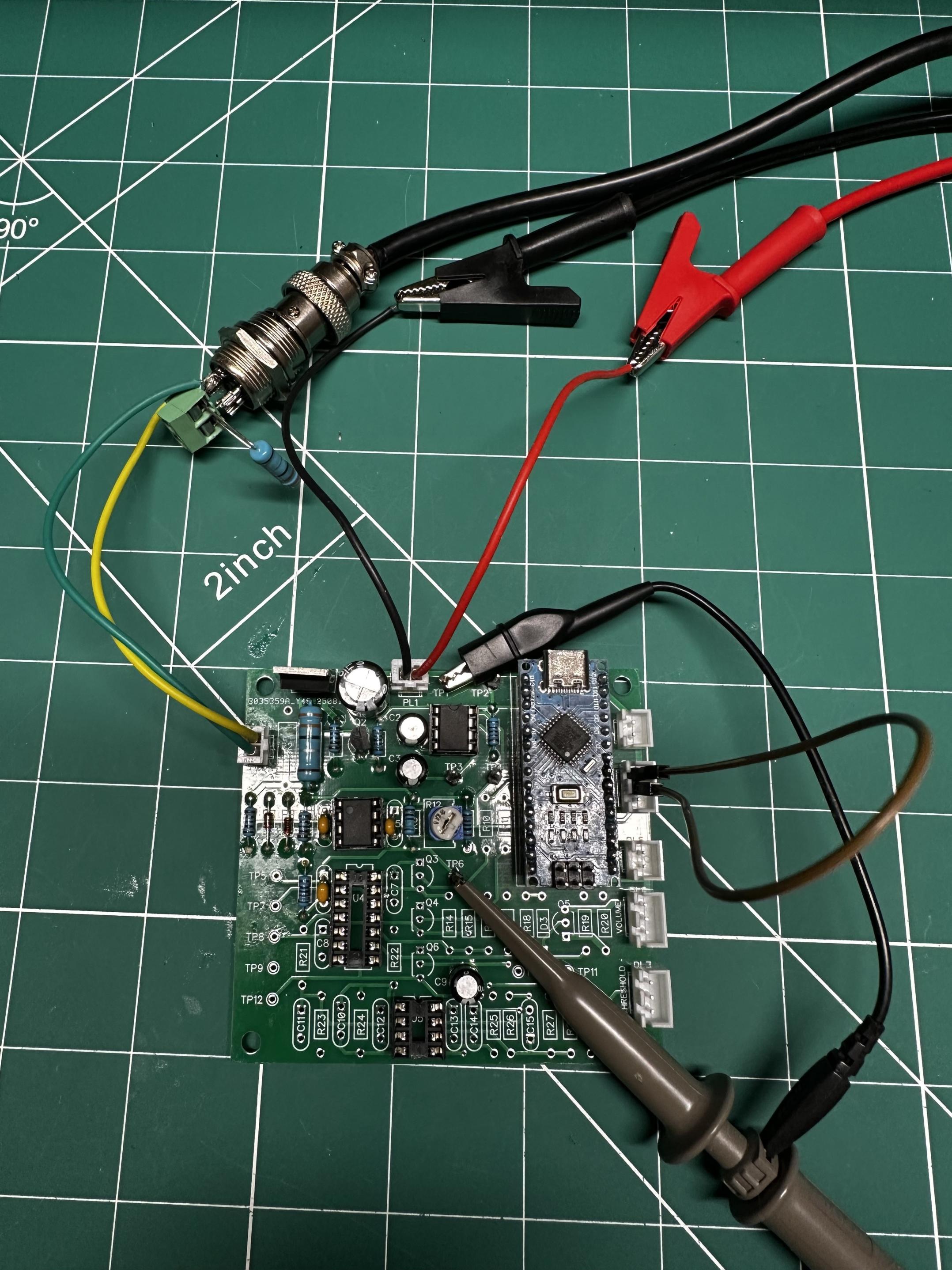

                    Build so far setup to measure TP6:
                    Click image for larger version  Name:	IMG_7709.jpg Views:	0 Size:	634.6 KB ID:	445618

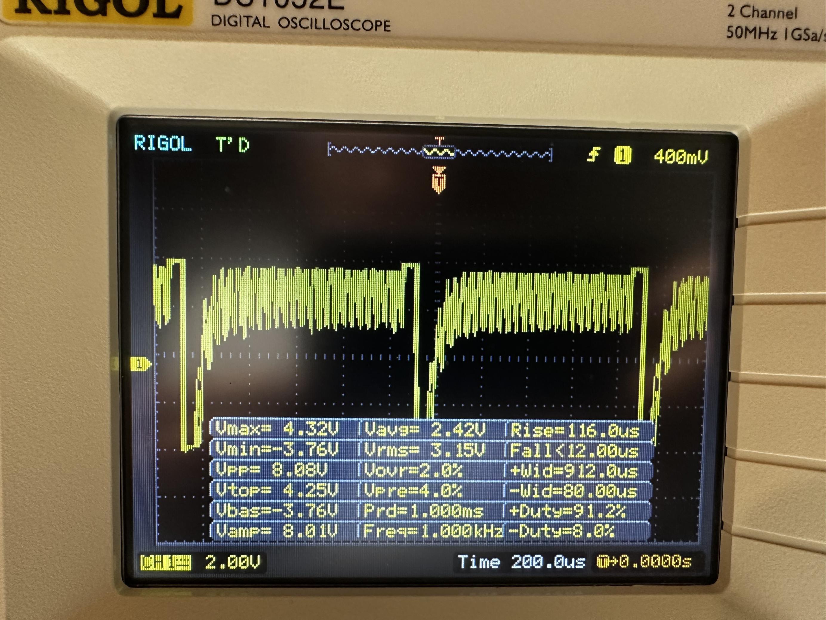

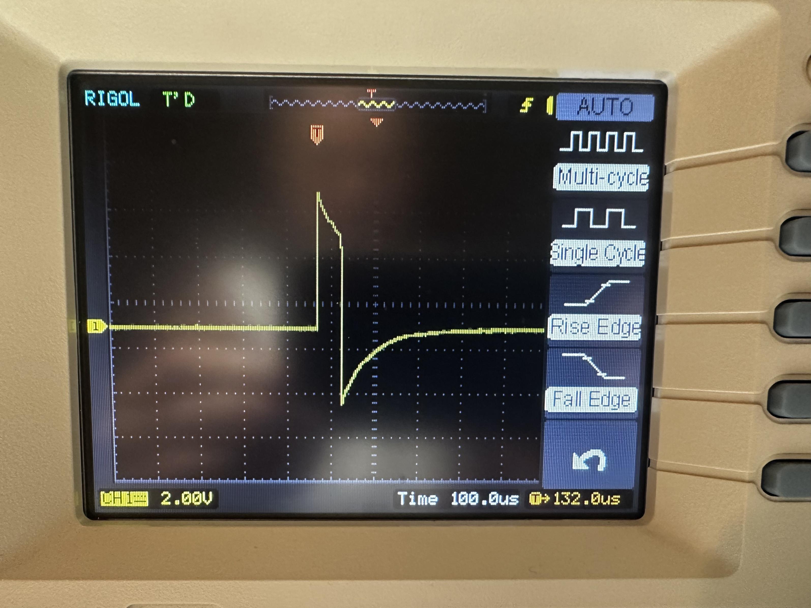

                      Qiaozhi after the Nth time going back over the steps, I realized that I misread the suggested initial value for the damping resistor. I had installed a 3R3 instead of 330R.
                      I switched this out and now my flyback no longer has the nice form it did before. It also appeared to add a lot of noise to TP6.
                      Incidentally I zoomed in on the waveform of TP6 and saw something that me a bit more revealing. The waveform now faintly resembles the expected waveform, only with a lot of oscillation. What do you make of this?
                      *** EDIT: The TP6 waveform below appeared after I turned R12 all the way counter-clockwise. Not sure if that is minimum or maximum resistance.

                      Flyback with 330R damping resistor installed:
                      Click image for larger version  Name:	IMG_7710.jpg Views:	0 Size:	593.3 KB ID:	445625
                      TP6 with 330R damping resistor:
                      Click image for larger version  Name:	IMG_7712.jpg Views:	0 Size:	635.1 KB ID:	445624

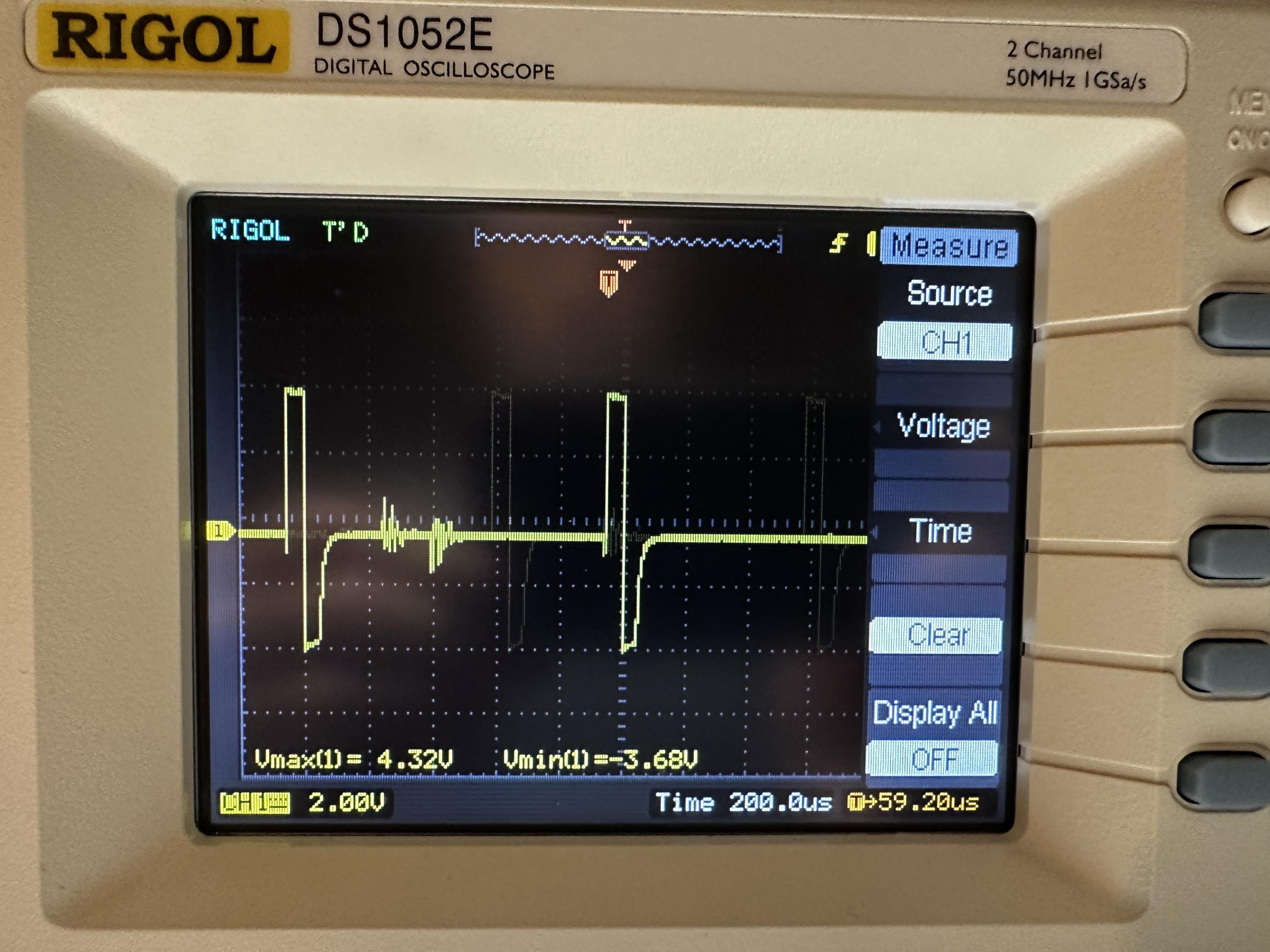

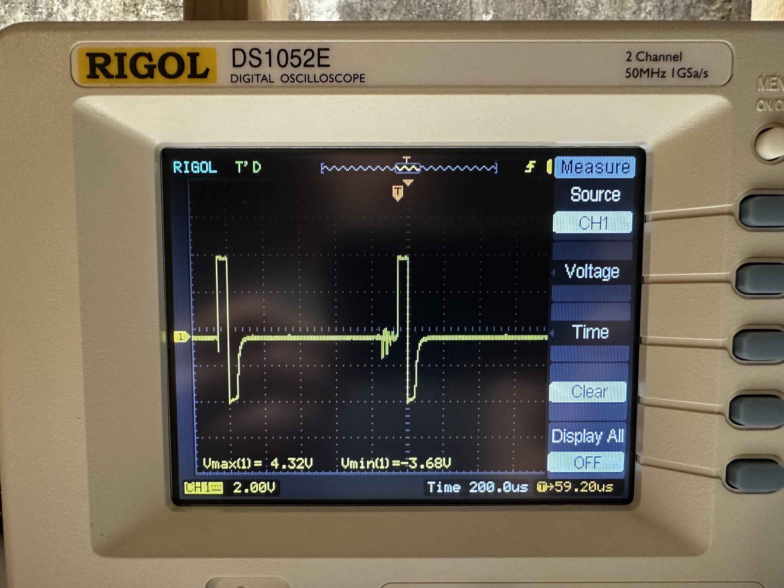

                            Could be EMI (LED lights give me grief), also make sure there are no other coils nearby. A good way to determine if the ringing is caused by external sources is to pick up the coil and rotate it around in free space, see if the ringing changes.
                              I think you nailed it Carl-NC! I moved the coil as far away from my workbench as it would reach and that seems like it may have resolved most of the noise. Probably was either the LED lighting or the power supply. There is still some transient noise that flashes across the waveform. Wondering if that is to be expected?

                                Yes, I often get that. It's EMI from somewhere. A way to determine external noise from circuit noise is to disconnect the coil.
