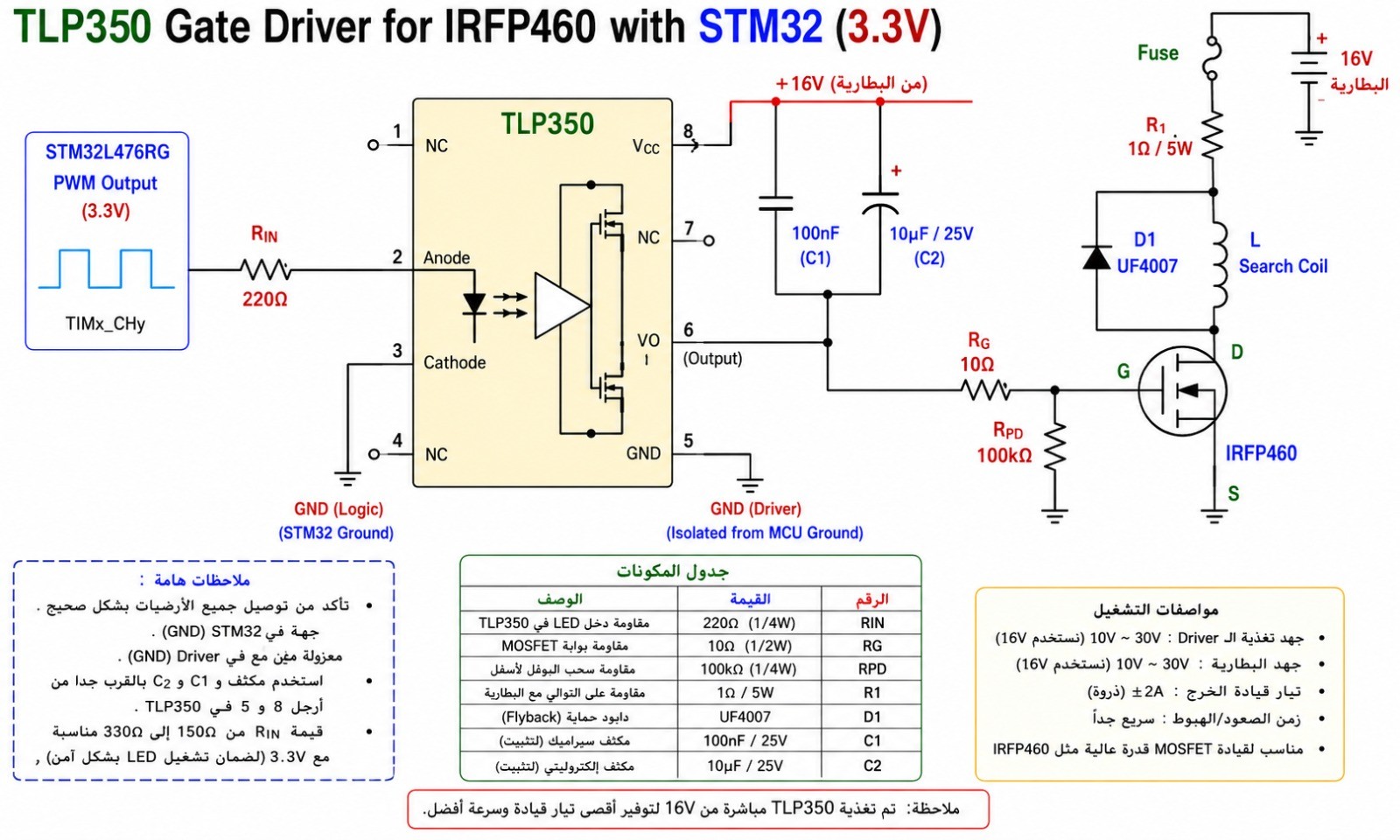

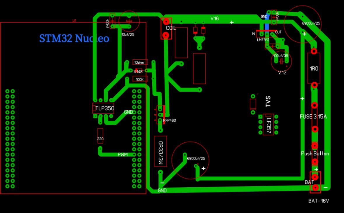

    I'm working on an advanced pulse induction metal detector project and I'd like expert feedback.
    Hi h5ha,
    The schematic and the traces on the board are full of errors. Try to find more serious source of information.
      Hi h5ha,
      Yes, that's why I'm presenting the plan to the experts here for correction.
