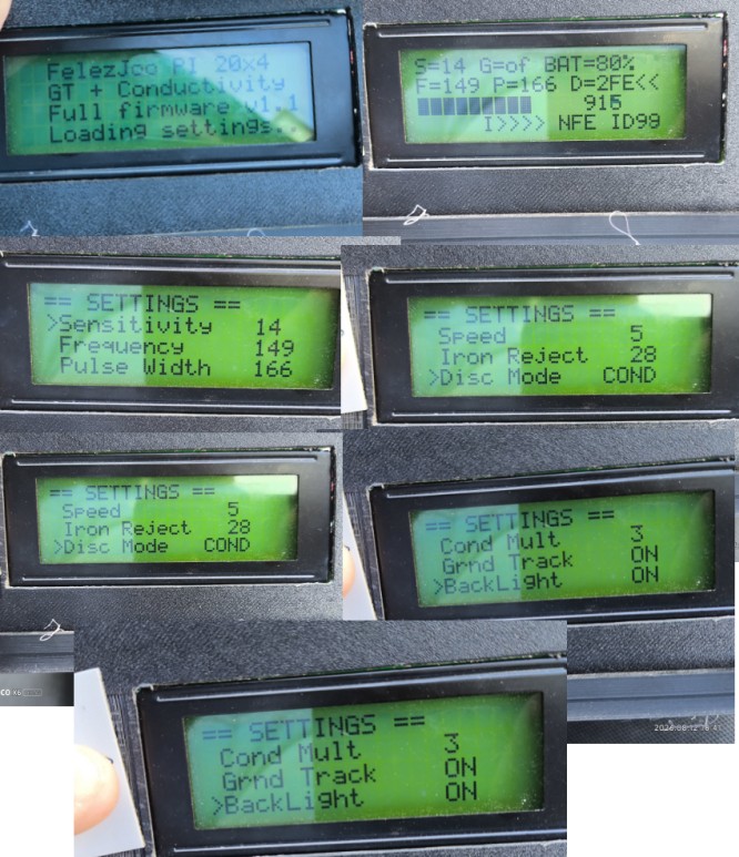

    I am working on a new version of the Felezjoo that includes some improvements. It is still in the testing phase—as you can see, it is in the early stages—but it is coming along well.
    I have already conducted preliminary tests; the unit features switchable Ground Tracking and a numerical adjustment setting for use on different soil types.
    It also now includes discrimination based on the standard Threshold method, as well as Virtual Conductivity discrimination, which utilizes seven sampling windows.
    And, of course, it incorporates the best features of the original Felezjoo.
    I plan to change the name, however, to avoid confusion with the Felezjoo.​​

            This is a demo of the new program I’m working on; the GT function is already working, along with other improvements I’ve implemented. I want you to test it on various types of terrain—I’m from Veracruz, Mexico, where the ground conditions differ, so the goal is to see how it performs in different environments. I still need to work on the discrimination feature, but otherwise, it seems to be functioning well; give it a try.
            It works with the original Felezjoo board, so no additional modifications are required.
            Finally, there are two different menu modes: the first is accessed by simply pressing "OK," while the second requires a long press (holding the button for about two seconds); the same long-press action is used to exit the menu.​
            One final detail is that a 20x4 LCD is used for this.

                      I’ve just uploaded a new video to showcase the new program I’m finishing up; I should clarify that it’s still in the testing phase, but it’s coming along very well.
                      This version differs from the Felezjoo and VolcanoPI; it now includes improvements found in very few pulse induction detectors. It features a discrimination function with adjustable high and low settings, allowing you to lock in specific parameters if you’re targeting only certain types of items. However, as I mentioned, I’m still working out the kinks with the target IDs—I hope to have that sorted soon, and once that’s done, the program will be complete.
                      It also includes GT (Ground Tracking)—an automatic ground adjustment feature that adapts to changing terrain so you never miss a thing.
