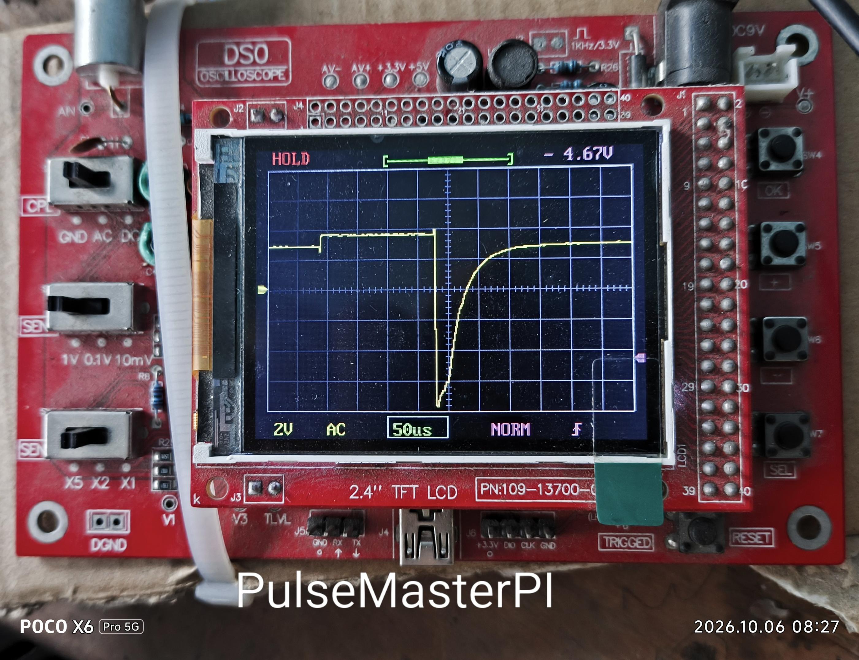

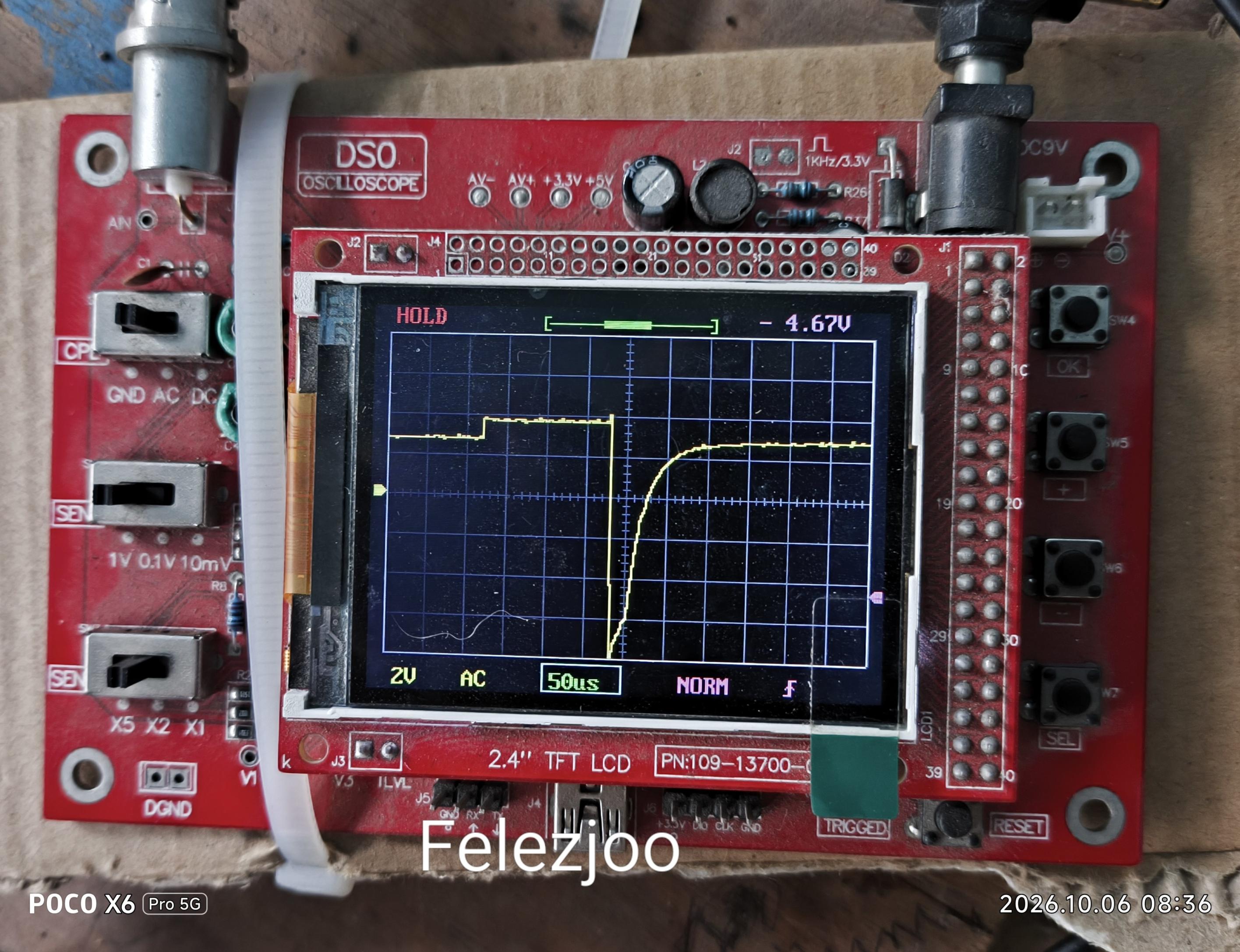

    After a lot of testing, I’ve finally sorted out the ID issue; it took a lot of work, but I’ve finally arrived at a solid configuration.
    It now features true, dynamic ground tracking as well as dynamic ground balancing—meaning, in short, that you can use the coil at any height (though holding it too high does slightly reduce depth).
    It also boasts more advanced discrimination compared to the Felezjoo.
    It is capable of detecting a silver coin amidst construction nails—something not many pulse induction detectors can do; I actually tried that same test with the Felezjoo, and it failed.
    For now, I’m still running tests to confirm its actual detection range.​
    Here is a sample, but remember, it's a demo.

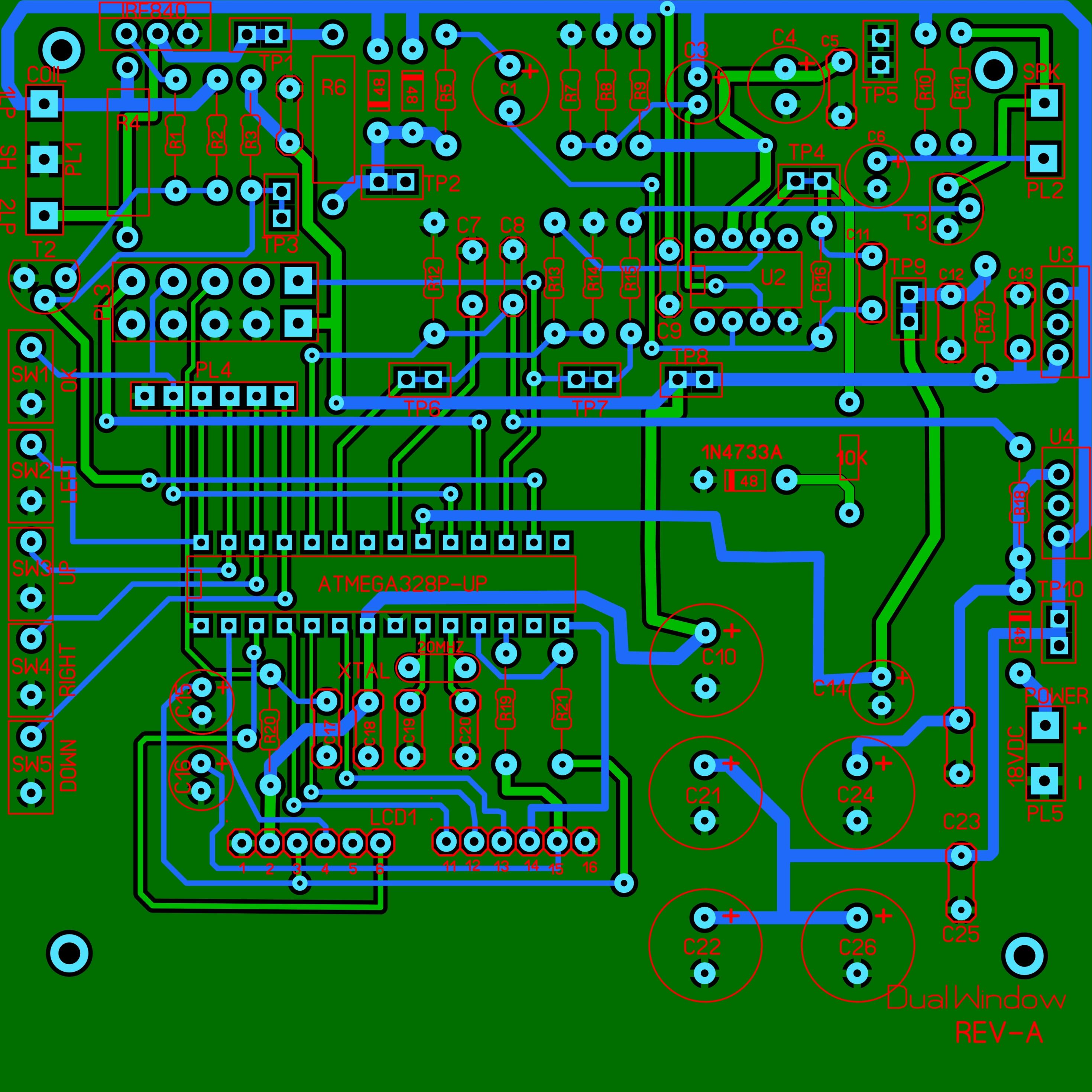

          This is the board I use for the GT—feel free to check it out.
          It works for the PulseMasterPI as well.
          It has a small modification that might seem insignificant, but I tested it against the standard version; with this latest one, iron discrimination actually improves a bit.​This is the board I use for the GT—feel free to check it out.
          It has a small modification that might seem insignificant, but I tested it against the standard version; with this latest one, iron discrimination actually improves a bit.​​
          And of course, I did that because removing and reinstalling the ATmega for so many tests is difficult given the limited space in the original design.
