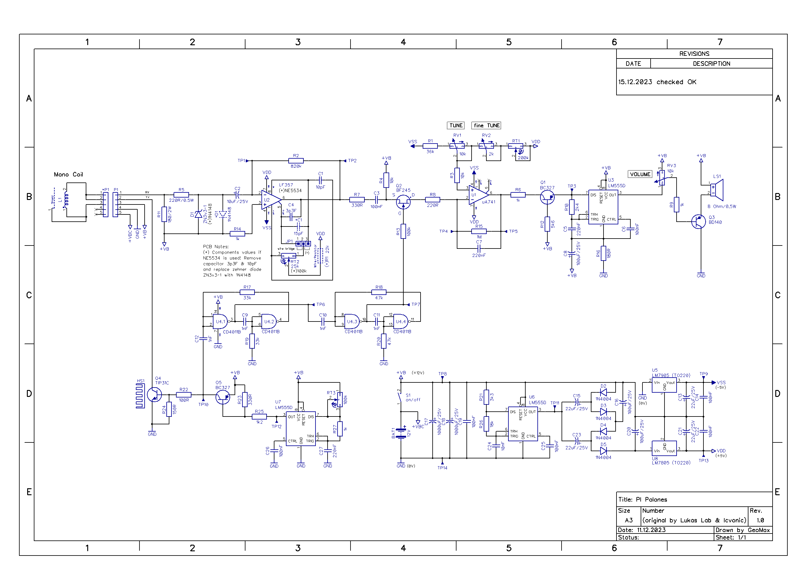

              Hi Aashif,
              I’ve taken a look at your schematic. To be honest, this drawing certainly won’t win any design awards. It’s quite a jumble with no discernible layout logic. But that’s okay—you’re here to learn, and we want to give you a few tips on how to improve it. First of all, you need to realize that reading a schematic is very similar to reading a book. In my part of the world, you read a page of text from left to right and then from top to bottom. A schematic should be structured the same way. I’ve attached an example of how I draw schematics; other experienced designers here on the forum use a very similar style. I usually start at the top left, where the signal is received or the TX signal is generated. Next come the receiver, any integrator circuits, and/or amplifiers, etc., depending on your design. Then comes the audio section, usually positioned on the far right. The timing and sampling circuitry is typically placed below the receiver. I draw the power supply unit next to that—or underneath it for larger circuits. These functional blocks fit neatly onto a single page, making the schematic easy to read and very organized. Just take a look at the example circuit for the PI-Polones; its structure is similar to that of your detector.​​

                Thank you so much for the detailed feedback and the example, GeoMax! I really appreciate you taking the time to explain the proper layout structure. Since I am still learning, this left-to-right and top-to-bottom approach makes a lot of sense. I will definitely apply these tips and try to organize my next schematic much better.

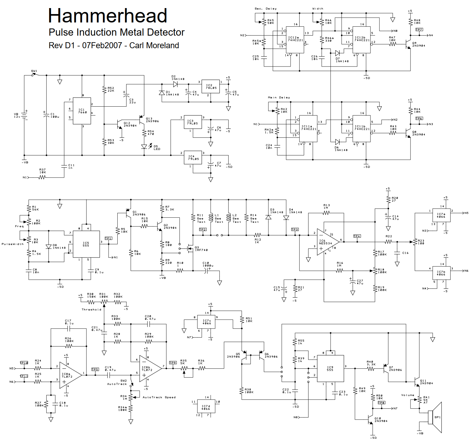

                  Also notice the use of implied connections. You don't need to literally connect everything with wires, you can use ground and power symbols (and even signal symbols) to make connections, and it makes it far easier to read. Here is one of mine, notice how it's broken into several pieces:
                    Thank you for jumping in and sharing your expertise, Carl-NC! Your 'Hammerhead' schematic is a great example of how clean and readable a design can look when broken into logical blocks.
                    I now completely understand the point about "implied connections." Using ground, power, and signal symbols instead of routing long wires everywhere makes a huge difference. This will definitely help me clear up the mess in my current drawing.
                    By the way, could you please tell me which software you used to draw this 'Hammerhead' schematic? I am currently using EasyEDA, but I really love the clean and professional look of your drawing. Which software would you recommend for making such neat schematics?

                      I would recommend KiCad. It is quite powerful—comparable to professional PCB software—and also free.​
                        Hi Aashif,
                        Carl's example schematic for the Hammerhead is another great example of how to create a clear and readable schematic. Always try to divide the entire schematic into circuit blocks and connect them using labels. This makes troubleshooting easier later on should any problems arise. It also makes it simpler to redraw a circuit block or swap it for a different version without having to redraw the entire schematic.​
                          That particular schematic was done in Microsoft Visio which is a generic drawing program, not a schematic capture program. I usually do all my formal schematics in Visio (such as all the ones in ITMD3) because it gives me more control over the appearance. For real schematic capture, get KiCad. It's free and quite good.
