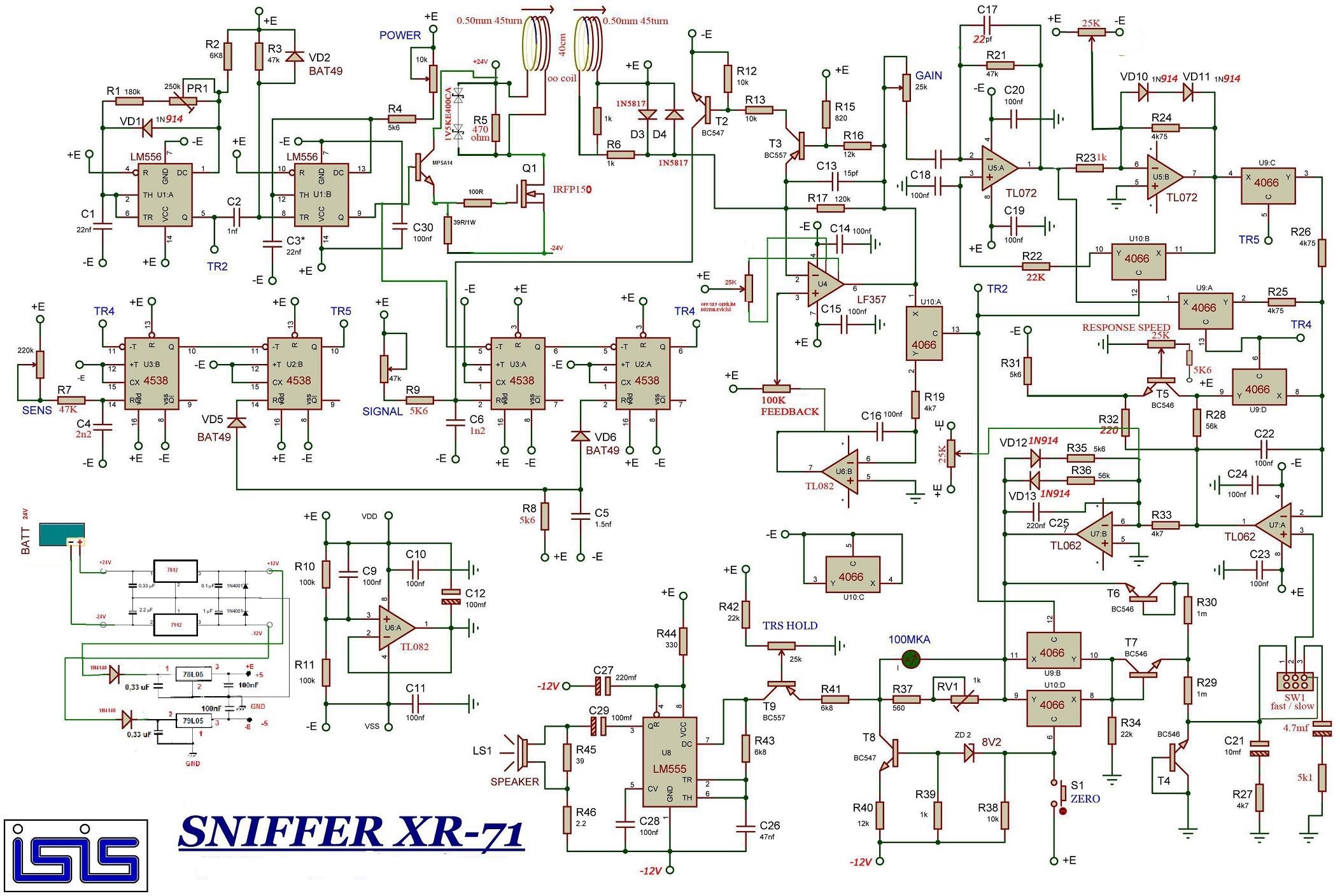

    Hi Detectorist#1 and @GeoMac,
    I cannot thank you both enough for taking the time to review my schematic. As a learner, getting guidance from experts like you is a huge privilege, and your practical insights are literally saving this project!
    Detectorist#1:
    I have carefully followed your instructions and updated the design:
    1. Power Supply: Removed C1 to C8. Kept only C9 (4700uF/35V Low ESR) and added a 100nF/50V ceramic capacitor in parallel.
    2. L1 Inductor: Replaced L1 with a 1 Ohm (0.5W) resistor.
    3. MOSFET: Swapped the Drain and Source connections so they are now correctly routed.
    4. Damping Resistor (R: Replaced the single 330-ohm resistor with three 110-ohm (3W) resistors connected in series to handle the flyback voltage safely.
    I just have two small doubts:
    * R9 Resistor: In my schematic, R9 is a 10K pull-down resistor at the MOSFET gate. Did you mean a different resistor to be divided, or should I leave this 10K as it is?
    * D1 & D2 Diodes: I still have the back-to-back 1N4148 diodes at the gate. Should I completely delete them so they don't clamp the gate voltage?
    @GeoMac:
    You are absolutely right, and I completely missed that flaw! Using a standard BJT (Q1) to switch the delicate sampling signal was a rookie mistake on my part.
    I would love to learn the right way to do this. Should I be using an Analog Switch IC like the CD4066 or a specific JFET instead? Your expert advice on how to properly wire this sampling stage would be incredibly helpful.
    To make things easier, I am attaching both the updated PDF and the EasyEDA source file (.zip) to this post.
    If you spot any more silly mistakes, please let me know. Also, if it is easier for you to explain the sampling logic by directly tweaking the source file, please feel free to do so! I am here to learn from the best.
    Thanks again for being so patient and supportive!
    Best regards,
    Aashif

      - What is the purpose of the capacitor connected in parallel of TX coil? And the working voltage of this capacitor have to be more than 2000V - not 630V
      - Used type of SIC transistor is not suitable for this design - he needs +20V pulse on gate for 6A Drain current. If you not want to use SMD type transistor - use IMWH170R450M1 type. The case is TO-247-3 and the Ron=450moHm at +12V pulse on the gate for 10A Drain current. This will allow to NOT use +15V stabilizer especially for controlling of the SIC transistor.
      - The connection of gate driver is wrong - no connection to GND. Also the name of pin7 have to be "NC".
      - It is not good to use for power ground and for minus 12V supply the same symbol despite the different name.
      - GeoMax is right - for sampling is good to use J113 unipolar transistor instead of bipolar 2N3904 type. Also it is not possible to control the base of 2N3904 from pin6 of U10 - this is input, not output of 4011.
      Further will be more remarks...

          Hi Aashif,
          Your schematic have to many mistakes and some of them are too general to be easy corrected. The total structure of the detector is wrong and is not suitable for the design of the PI detector with "Brutal" TX power with 24V power source.
          I will propose to you an other structure more suitable for your purpose instead of write many remarks. Soon, I will draw the schematics with the building blocks and you will have possibility to try to draw the full schematic as an exercise.

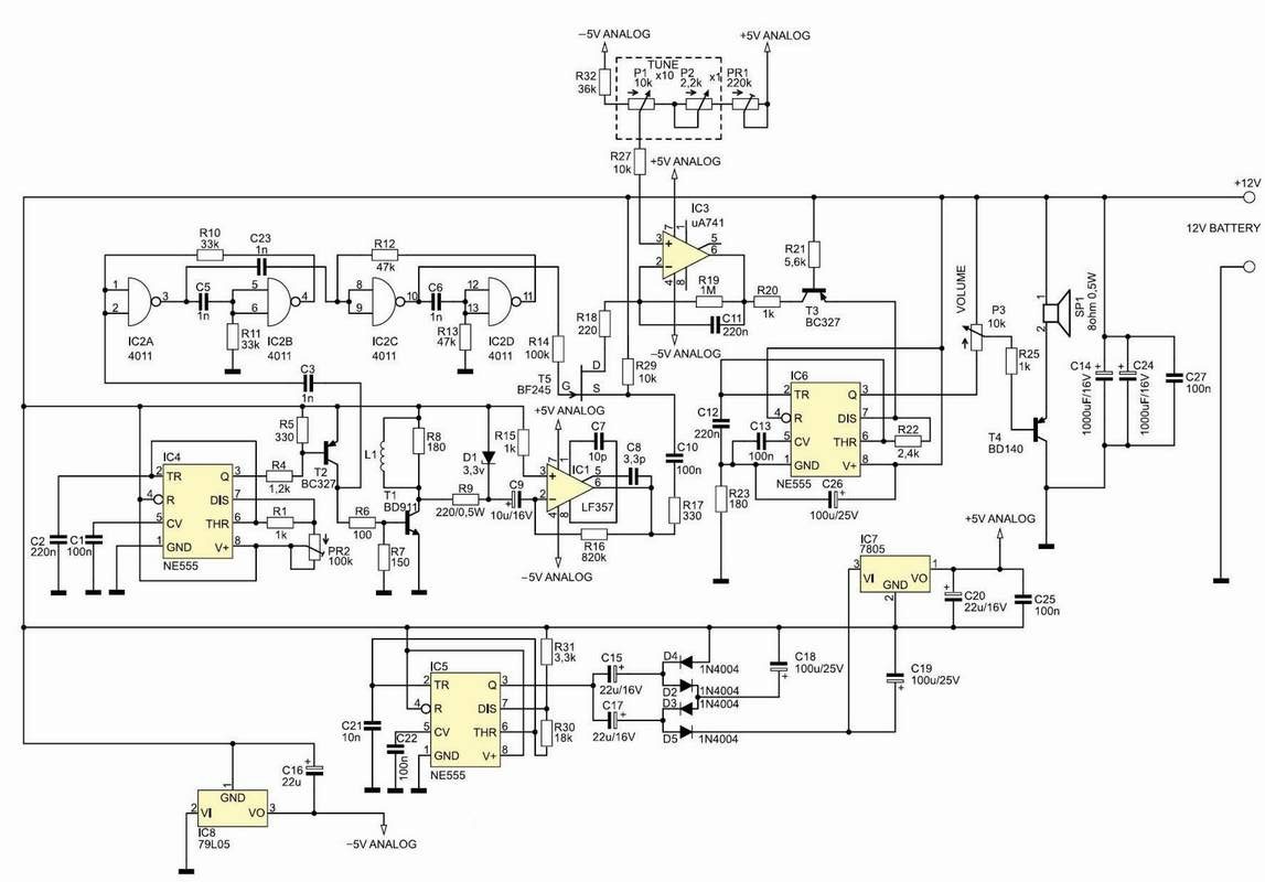

              You should take a look at the schematic for the PI-Polones, as it's very similar to your circuit design. The only difference to your design lies in the audio section and the transmitter control. Your approach for the transmitter, however, is a bit overkill.​
              Furthermore, you should know that PI-Polones is a modernized version of Sandbanks PI from 1979. You can find the project details and how the circuit works in the download section of Geotech or attached below. I would recommend checking-out this first before continuing to design your circuit. Once you understand how the circuit works, you can then convert the detector to 24V and/or modify the audio section.

                Hi @GeoMac,
                Thank you for pointing out the PI-Polones / Sandbank connection and sharing the PDF!
                I have downloaded it and will definitely study the core principles. It will be great homework for me while I wait for Detectorist#1 to share his proposed building block schematics for my 24V goal.
                Reading this theory will surely help me understand his upcoming schematics much better. I really appreciate the guidance from both of you!
