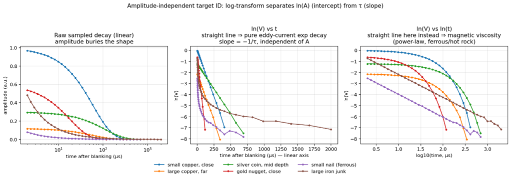

            With a PI metal detector the target response amplitude varies very much, depending on the size of the target, the distance from the coil and the material of the target itself. Which is the best way to "normalize" the target amplitude, so that we can look only at the time constants of the targets and analyse the decay curve of the targets to
            The clean way to do this is to work in the log domain, not to literally "normalize" the amplitude by dividing curves down to a common scale. Here's why that's the right move and what it buys you.
            The physics. For a target dominated by simple eddy-current decay, the voltage you sample after TX blanking is well modeled as
            V(t) ≈ A · e^(−t/τ)
            A is a big, messy multiplicative factor — it bundles target size, distance/coupling (mutual inductance falls off steeply with range and orientation), and any gain in your front end. τ is what actually carries the material/geometry signature (for a simple conductor, τ ≈ μ₀σd²/k, with k a shape constant), and it's largely decoupled from A. Because A only scales the curve and never changes its shape, the natural way to strip it out is to take the log:
            ln V(t) = ln A − t/τ
            That's a straight line in t, with intercept ln A (all the "how big/how close/how conductive-in-an-absolute-sense" information) and slope −1/τ (the shape you actually want). So the "normalization" isn't a division step you do to the raw curve — it falls out for free once you log-transform and fit a line. Amplitude becomes the intercept, τ becomes the slope, and they're orthogonal by construction.
            Why this beats a naive amplitude-normalize. If you instead divide every sample by, say, the first gate (V(t)/V(t₀)), you're using one noisy sample as your entire reference, and multiplicative noise on that one point corrupts every point downstream of it. Doing it in log space and fitting a slope by least squares over many gates averages the noise down instead of propagating it from a single point — with your 94-channel filter bank you have far more gates than the classic 2-point "early/late ratio" scheme most commercial PI detectors use (that ratio is literally the 2-point special case of this same idea: ln(V_early/V_late)/(t_late − t_early) = −1/τ). You have enough resolution to do a proper weighted regression instead, which is a real advantage.
            The complication worth designing for: not everything decays as a single exponential. Ferrous targets and mineralized ground exhibit magnetic viscosity (Néel/after-effect) relaxation, which looks much more like a power law than an exponential — its signature is a straight line in ln V vs ln t (log-log), not ln V vs t (log-linear). So a robust front end should fit both models per target and use which one fits better (plus the residual curvature) as an extra discriminant axis — eddy-current-only vs. viscous/ferrous vs. mixed — completely independent of amplitude, since both fits are done in log space. I generated a quick synthetic-target figure to make this concrete:
            Presented filesClick image for larger version

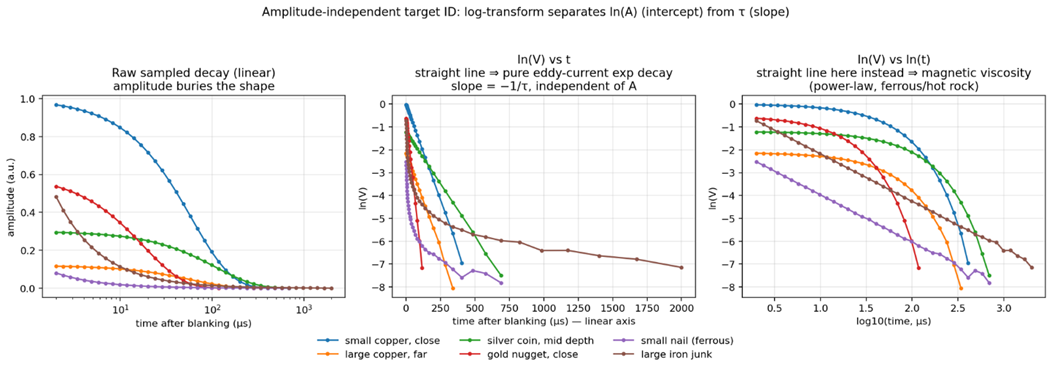

            Presented files
            Left panel is what you get straight off the ADC — six wildly different-looking curves, dominated by A. Middle panel is the same data after ln(V): the two copper targets (same τ = 60 µs, ~8× different amplitude from size/distance) collapse onto parallel lines — only the vertical offset (intercept, i.e. ln A) differs, the slope is identical. Right panel shows the same data in ln V vs ln t — the ferrous targets (nail, iron junk, magnetic-viscosity decay) straighten out there instead, revealing themselves as a different physical decay law rather than just "a weird τ."
            A few implementation notes specific to your architecture:
            Do the synchronous bipolar-pulse averaging (your PRF/mains cancellation) before the log transform, in the linear domain — log(mean(V)) ≠ mean(log(V)), and averaging after logging biases the estimate, especially at low SNR near the tail where it matters most. Guard the regression against samples that dip below ~3× noise floor (visible in the figure as where each curve just stops) — this is a real dynamic-range limit, not an artifact, and it means your usable decay window is itself target-dependent (short τ or weak/deep targets give you fewer usable gates, which argues for an adaptive-window, SNR-weighted least-squares fit rather than a fixed set of gates). And keep the intercept (ln A) around as a separate output rather than discarding it — it's your depth/size/signal-strength estimate, useful for gain ranging and depth indication even though you deliberately exclude it from the τ-based target ID axis.
            One physical caveat worth flagging: this removes the amplitude confound (size/distance/gain), but size and conductivity are still coupled inside τ itself (τ ∝ σd²), so a small very-conductive target and a larger less-conductive one can land at a similar τ — that's an inherent physics limit of single-parameter time-constant discrimination, not something normalization can fix. With 94 gates you have the SNR headroom to go further than a single τ if you want — fitting for curvature (deviation from a single exponential, indicating a multi-mode/composite target) or a two-exponential model via Prony's method / matrix-pencil on the log-decay residual — which is a natural next step given the front-end bandwidth you've already built.

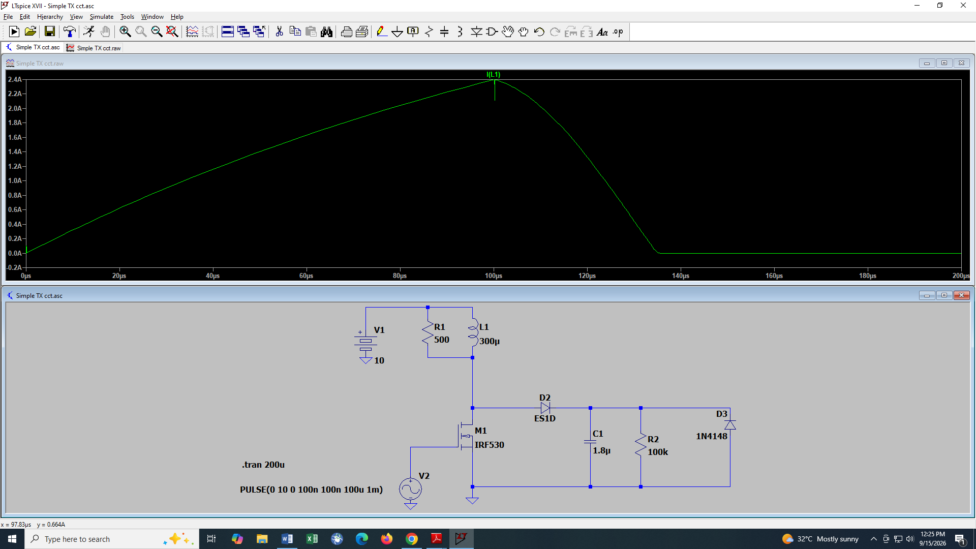

                Click image for larger version  Name:	TX on response.png Views:	0 Size:	99.3 KB ID:	452584
                Classical Single-Period / Mono-Pulse Architecture
                TX Turn-On Response Analysis​
                Reference: "PI Math" page 553
                  The foundational laws, and Lumped element theory.

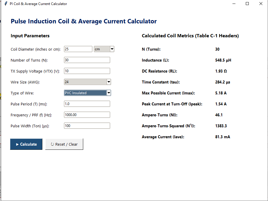

                  It is good to know some calculas also. I used this book.
                    An AI generated app for generating all the results.
                    The app was generated using the Eq C-2 from "PI math"
                    Click image for larger version  Name:	coil app.png Views:	0 Size:	35.6 KB ID:	452694
                    Coil Inductance Calculation
                    The app implements the Kirchhoff-Stefan continuous multi-loop circular bundle formulation.
                    Link to the app:

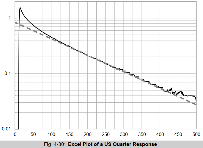

                          Consider a step magnetic field applied to a metal cylinder. At t=0+, eddy currents are distributed only across the top surface of the cylinder. Immediately, the eddies begin to diffuse downward into the depth of the cylinder, but also radially diffuse outward toward the perimeter. After about 1 tau, the eddy diffusion is done and then it's all decay, and closely follows a single tau decay. Here is the step response of a silver US quarter:
                          The dashed line is the single-tau (146us) decay. The initial non-linearity is due to eddy diffusion and is done at about 146us, which happens to be the tau of the quarter.
                            Thank you Carl, for the clarifications.
