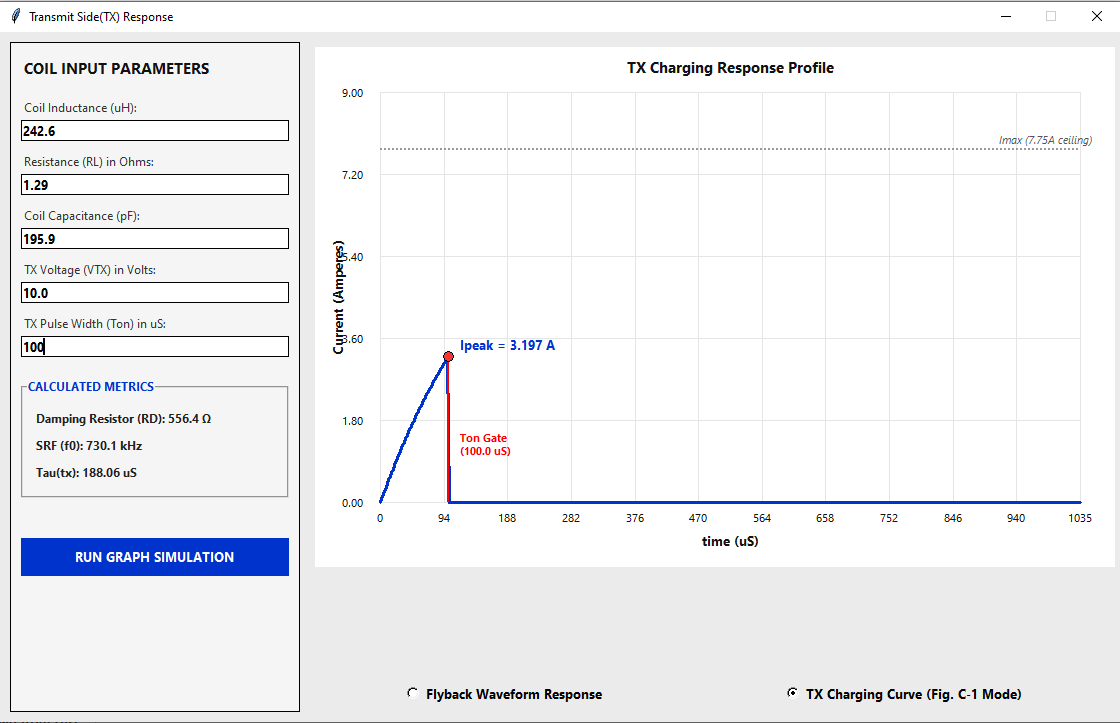

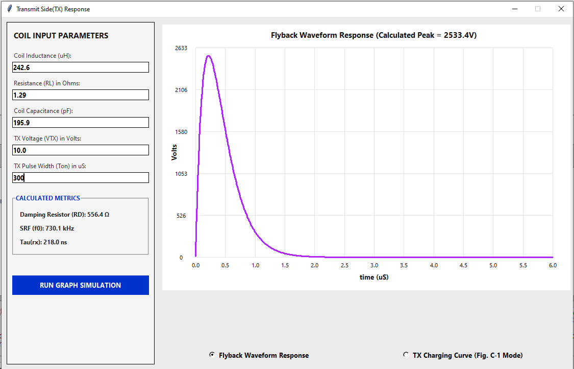

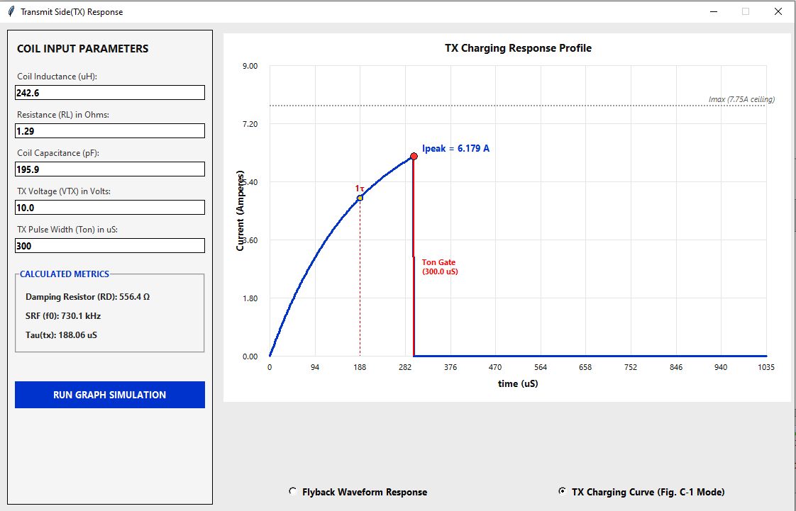

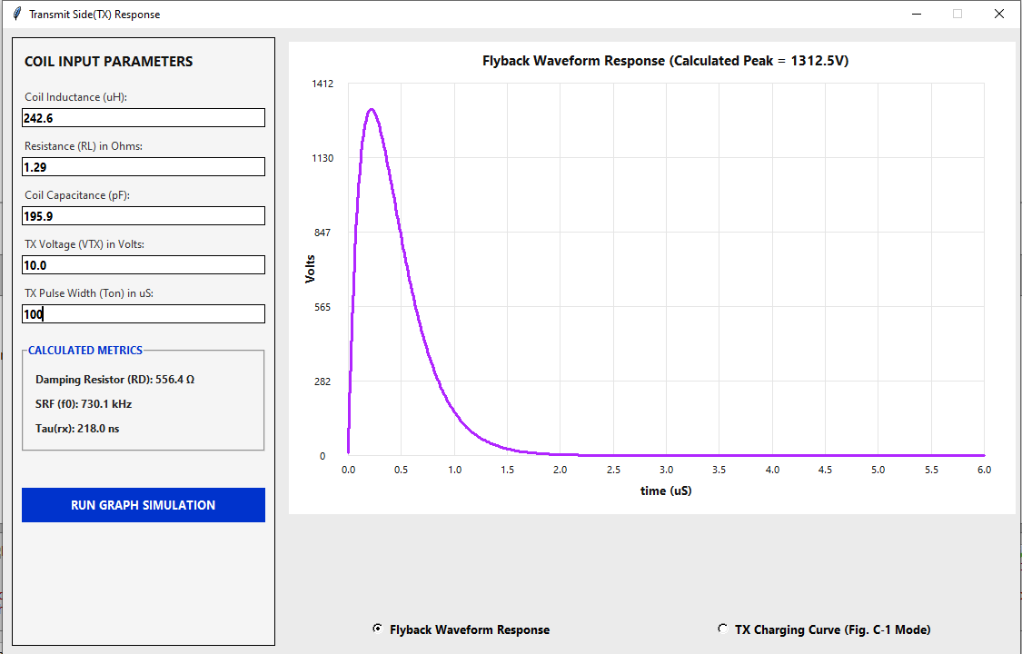

                            AI conjured up this app for me. Seems quite good. It should give an idea of what results to expect when constructing DIY singular round (circular) coils (Multi-loop Mono-coils).
                            It agrees with the actual measured parameters contained in Tables C-1 and C-2 in "PI-Math" document.
                            And for magnet(enamel)copper wire, it is quite close to Qiaozhi's coil calculator (Maxwell/Wheeler) which I still use.
                            The results for Teflon wire looks reasonable as to what should be expected (lower CL(pF)), only way to find out would be to make a few coils and run tests.
                              Playing around with AI to write python script is sure fun, I'll get over it soon though.
                                Transmit side
                                Here I can generate the waveforms for any coil metric. I use "PI -Math" Fig.C-1 and Fig. C-2 as templates.
