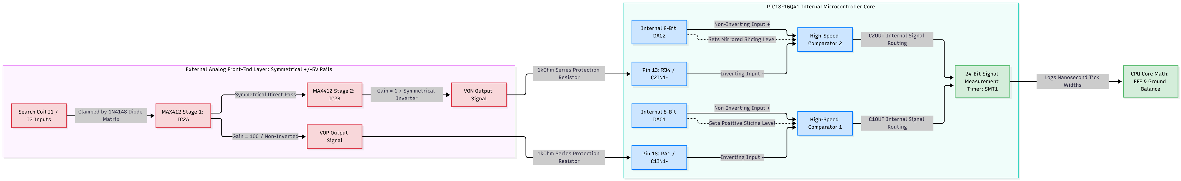

      How to be connected the outputs of the RX stages generating VOP and VON signals to the ADC inputs of uP supplied between +5V and naturally zero (GND) rail? If you use true symmetrical +/-2.5V regulated power supply for uP and RX amplifiers, these connections will be direct, without need of any level translations. Also, after sampling of the RX signal will have relatively long pause to the next TX pulse. Maybe this time will be enough to calculate VON value without using of inverting stage in the RX tract. Sorry if my remarks are totally not useful.
        VOP and VON feed directly into the two internal hardware comparators, not the ADCs.
        I added the two 1K series resistors in the pathways of (VOP) and (VON) as discussed before. Also added GND(coarse) and GND(fine) pot-meters.
          Hi dbanner,
          Sorry but you are FAR from the exact working connection for the signals VOP and VON to the uP unit. It is not possible for the uP (supplied from +5V and GND) to accept and converts (or compare) the input signals below the negative rail of the supply of uP unit!
            ........ accept and converts (or compare) the input signals below the negative rail of the supply of uP unit!
            It uses only the positive signals from U2a and U2b (depending on the coil supply—positive or negative), utilizing only one of the comparators depending on the current cycle.
              Yes, one at a time!
              Cycle 1 - Positive pulse decay - U2a - VOP - routed to comparator 1 - captured by SMT1 (comparator 2 not used and is clamped by internal diode and current protected by series input 1K resistor)
              Cycle 2 - Negative pulse decay - U2b(flips) - VON - routed to comparator 2 - captured by SMT1 (comparator 1 not used and is clamped by internal diode and current protected by series input 1K resistor)
              Maybe adding external clamp diodes on VON and VOP as extra protection, a single Schottky diode(BAT85) after each of the 1 K resistors. Only need to protect against the negative voltage swing, because the MAX412's positive saturation already sits safely underneath the PIC18's +5.3V damage ceiling.​
                The exact microsecond that exponential voltage decay tail drops and crosses that DAC threshold line, the comparator trips. Mathematically, the time delay (dt) at which that crossing event physically occurs is the natural logarithm of the signal.​
                Because U2B cleanly inverted the negative tail, the mathematical slope and amplitude characteristics of Cycle 2 remain an exact mirror image of Cycle 1.
                Because these two time intervals (dt positive) and (dt negative) are perfectly mirrored in magnitude but opposite in native magnetic orientation, adding them together in code allows any slow-moving external EMI or Earth Field Effect (EFE) noise to completely cross-cancel and drop out to absolute zero.​

                  OK. Now, the idea is clear to me. The both signals VOP and VON will be used.

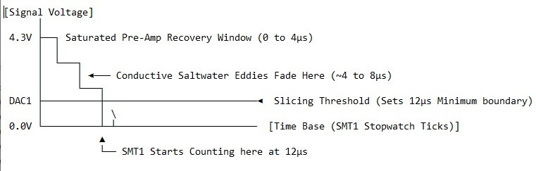

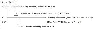

                    THE TEMPORAL SAMPLING DESIGN uses voltage height to establish the time boundary.
                    15 microsecond sample delay in the traditional PI, let's say 12 microseconds translate to:
                    Click image for larger version  Name:	slicing threshold.jpg Views:	0 Size:	30.4 KB ID:	453580
                      SMT1 starts counting here
                      You just gate the internal timer with the pulse output of the comparator, right ?
                      With temporal sampling,"sample delay" is just a matter of shifting the slice level ?
                      Everything that is determined by "voltage" in a classic PI needs to be translated to "time" and vice versa ?
                      Shifting the sample delay in a classic PI = changing the slice level ?

                          Yes, this is the general idea, every single one of your points is 100% correct.
                          Because the coil's decay tail is an exponential curve descending over time, changing the vertical height of the DAC slicing level automatically shifts the horizontal point in time where the curve crosses it.
                          If a classic PI machine wants to ignore wet beach saltwater(conductive noise), it stretches its sample delay further out in time (e.g., waiting from 8µs out to 15µs) to let the saltwater voltage collapse to zero. This is why I chose a slicing level equivalent to 12µs. The remaining beach sand matrix will be solved by the timing-vector subtraction and filtering methods which are well known.
                          So my very basic understanding of this method is if the temporal machine wants to ignore wet beach saltwater, it simply raises the internal DAC slicing level higher up in voltage. Because the saltwater voltage decay curve is small and collapses rapidly, an elevated DAC threshold ensures that the saltwater signal falls beneath the tripwire almost instantly. The SMT1 timer won't log any saltwater extension ticks, achieving perfect beach stability purely by adjusting a voltage reference register.​
