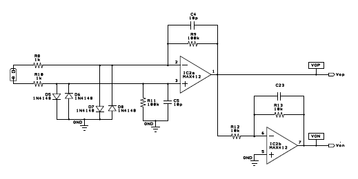

    Click image for larger version  Name:	RX front end.png Views:	7 Size:	14.3 KB ID:	453492
    TRANSMIT CYCLE - NET VOLTAGE AT MCU - ACTIVE INTERNAL COMPARATOR
    Cycle A (Positive) - VOP is POSITIVE (>0V) - COMPARATOR 1 processes VOP.
    VON is Negative (<0V) - (Comparator 2 ignores the clipped VON line).
    Cycle B (Negative) - VOP is Negative (<0V) - (Comparator 1 ignores the clipped VOP line).
    VON is POSITIVE (>0V) - COMPARATOR 2 processes VON.
    Also, to run a proper subtractive ground balance loop, the firmware must capture the decay time width (dt) at two distinct signal heights within the exact same pulse window: an Early Sample (t₁) and a Late Sample (t₂)
    Because the PIC18F16Q41 features twin peripheral sets, the software configures them to act as two independent stopwatches running in parallel.​​

    Professional designers of pulse-induction metal detectors are most likely laughing at our discussion right now, but this is the logical direction of development of projects created by DIY designers.
      The analog part of the schematic is copied from BipolarPI_Sch_Rev2.1.pdf

          Now I must look at the BCLK signal for the charge pump and the pulse drive for the H-bridge.​​​​ The pulse width and PRF have to be considered carefully. Also I haven't considered what "sample delay" means in the context of this methodology, since strictly speaking we are dealing with slicing level triggers and not sampling gates.
            Have you given thought to the saturation of the pre-amp?
              I still think that a 16bit PWM output can produce a more accurate slicing level than the internal 8 bit DAC.
              Especially when you have a 12 bit ADC value as ground level.
              The PWM output pin needs to be filtered with an R/C and fed back into the input pins of the comparators.
                  I haven't looked too closely at that. What about it? I think I need a couple of series resistors at VOP and VON. The inverted negative saturation voltage can possibly damage the PIC input port (excessive current through the internal clamp diode). Maximum possible output swing at saturation is roughly +4.3V and-4.3V.
                  The firmware safety delay routines make sure the PIC18 ignores the initial saturation block.​ The register mapping of the internal 8-bit DACs will position the slicing tripwires precisely at the exit of that recovery curve.​

                    The gain of the pre-amp is 100. One single step on the internal 8-bit DAC is at the sub millivolt level, do you think this will be insufficient?
                    In this proposed setup, firmware will make real-time baseline tracking—sampling the op-amp drift at the very end of everysingle pulse window and instantaneously updating the slicing level before the next pulse fires (occurring up to 1,000 times a second depending on the PRF).

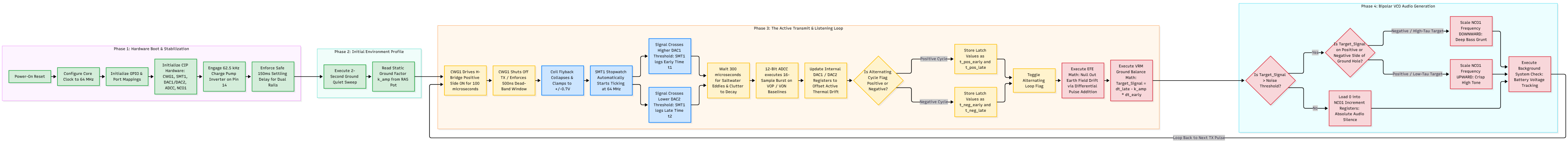

                          Here is basic framework of the firmware flowchart architecture. The chart is beautiful, it was generated by Mermaid. Never mind what is inside the boxes(could be all wrong). I am not capable to write such complex code, I'm sure I could learn but then that would take me a very, very long time. So long that I may be dead before I could manage to complete anything. So I hand off to AI.
                          It is clear that AI will make some of us less capable as time goes on, but I digress.
                          I am happy so long as I can have some basic idea of what is going on at the block level. I'll only go down rabbit hole if I have to.
                          Click image for larger version  Name:	Execute Signal Flow.png Views:	0 Size:	225.9 KB ID:	453521
