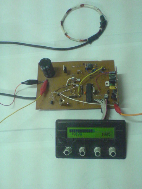

                    Here is a pic of the PI and the 8cm coil;
                      Hi 1843,
                      really nice work. Looking forward to more details.
                      Aziz

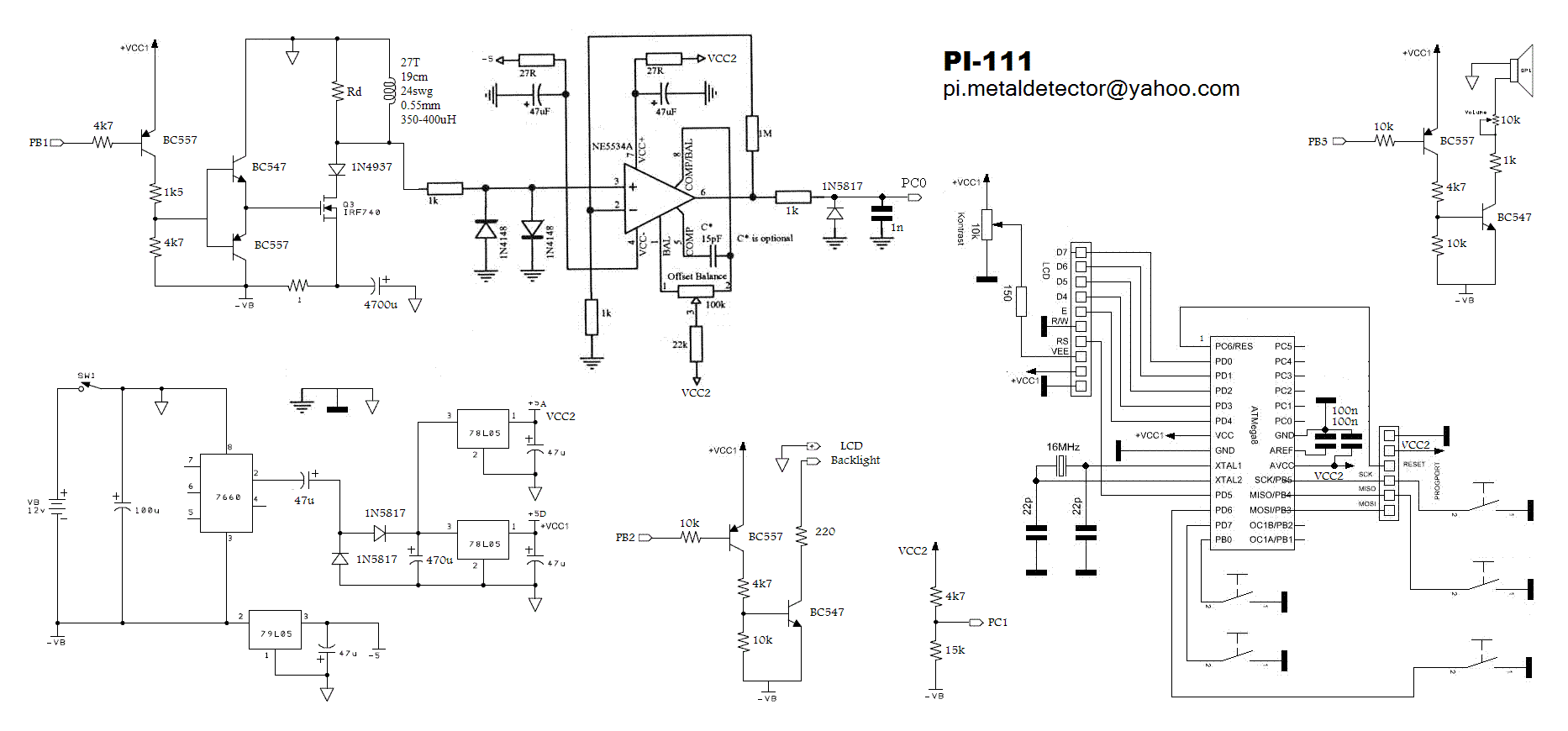

                          Schematic
                          Here's the schematic:
                          Who is ready to design a PCB?
                          Best regards,
                          1843
                            Hi 1843
                            Thank for your share schematic,
                            I aks again,
                            Did you use Pulse width modulation (PWM) technique in atmega8
                            programing for produce necessary pulses to drive tx signal in your
                            MD coil ?
                            if not please tell us how your MD pulses produce ?
                            with best regards...

                              When Timer1 is needed I don't use PWM...
                              In this PI I use both the PWM and simple active delay-loops to produce two different pulses...like Minelab!
                              If you want to learn proggramming there are a lot of educational kits and books for AVR...
