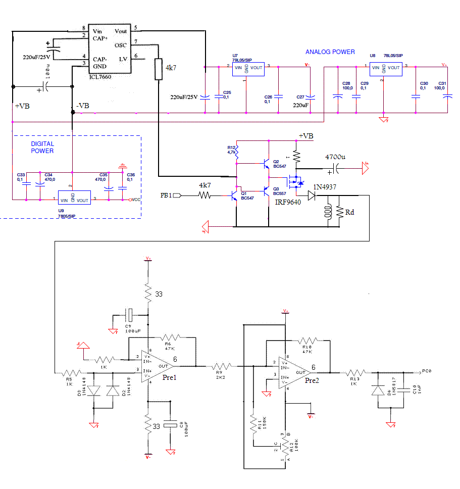

    • Have a look at the power supply on the Hammerhead II ->
      A basic PI design incorporating a PIC micro for timing control, intended as a learning platform for using uC's.
      It is very similar to your previous power supply. Perhaps it will have the same noise problems.
        It doesn't have the noise problem, because it's synced.
        • Originally posted by 1843 View Post
          OK - I note that you've already tried that as a solution, but the ATMega8 keeps stopping due to the voltage drop.
            I'm modifying the schematic at the moment...
            By using a P-MOSFET and changing the 7660 task, all the noise problems will be solved.
            Kind regards,
            1843
            • The main changes I'v done:
              Two opamps are used, so one has a lot of choice... AD797, AD8055, etc etc
              As you see the 7660 is synced.
              Any comments ?

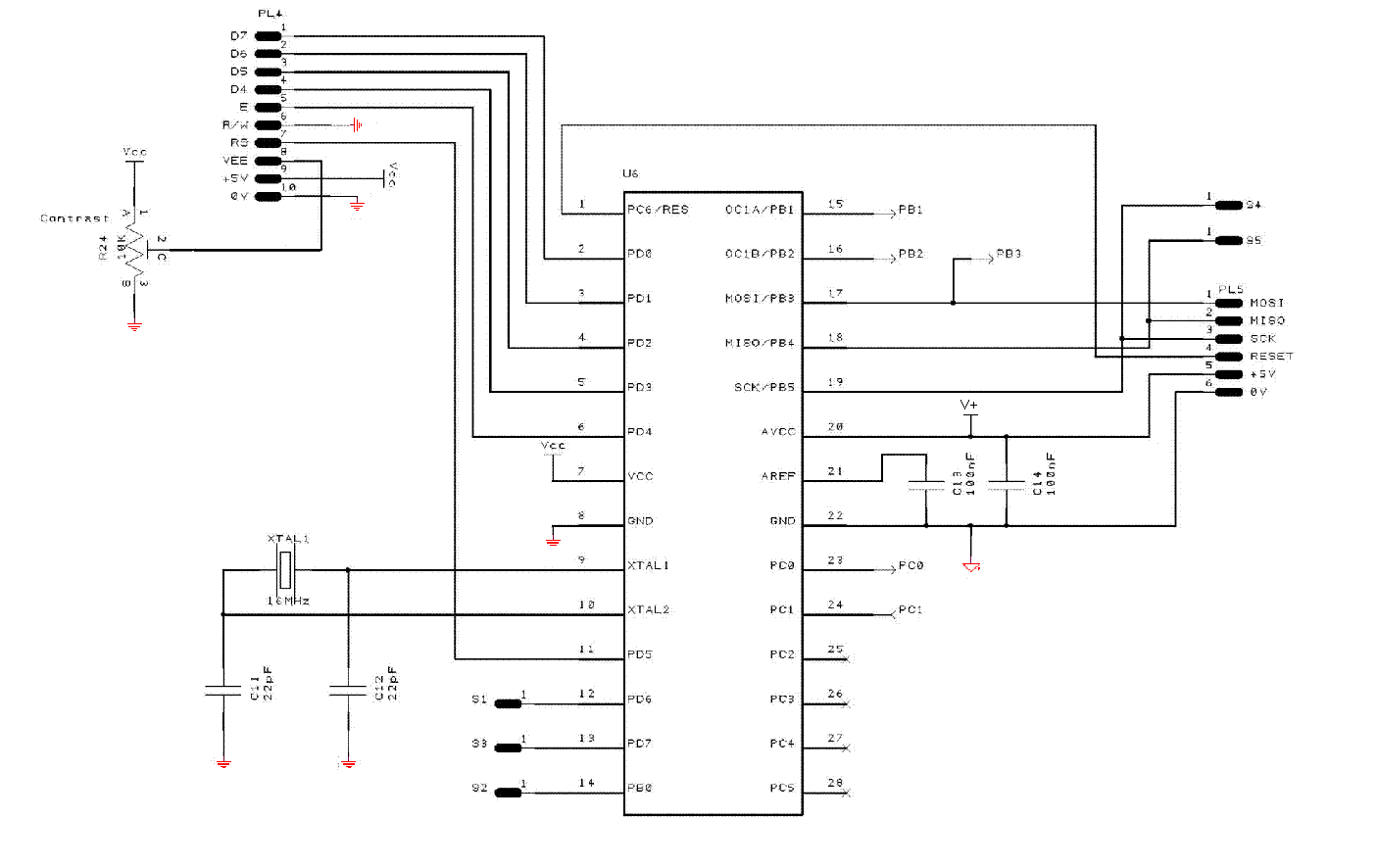

                Here's the main changes I'v done on it:
                Any comment ?
                The power supply looks much improved.
                  Grounds are separated...

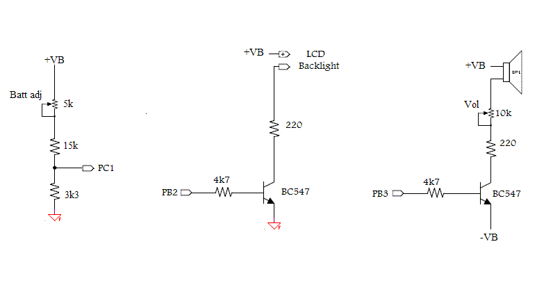

                  • And the other changes:
