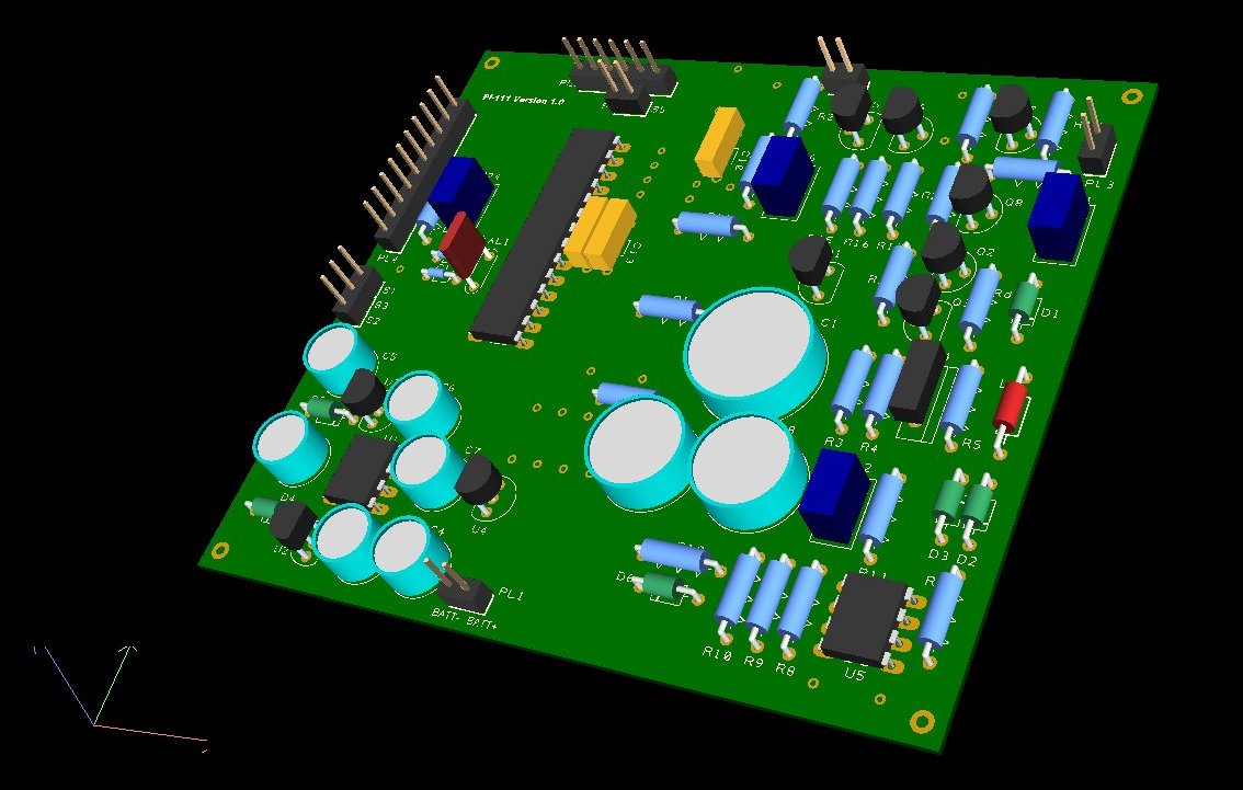

    Hi 1843,
    Let me know if this is what you're looking for?
    There may be errors, so please check. The usual caveats apply.

            Latest Version
            See attached zip file.
            The following errors were corrected:
            1. The missing 10K Battery Setting resistor has been added.
            2. The PCB name was written as PI-110. Changed to PI-111.
            3. Original schematic from 1843 showed separate grounds in use, but this was not intended. All components now use the same ground.
            4. D1 changed to 1N4937.
            5. Lead spacing of C1 increased to 0.3".
            6. Pin B of R26 connected to -12V (battery supply).
            7. Emitters of Q3, Q6 and Q8 connected to -12V.
            The layout passes all DRC and continuity checks.
            The board size is 4" x 3.5".

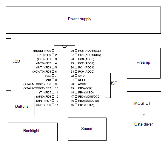

                    To keep analog signal paths as short as possible, I suggust the following PCB configuration:
                    Best regards,
                    1843

                        Just it's a suggestion to those who are interested to design a PCB.
                        1843

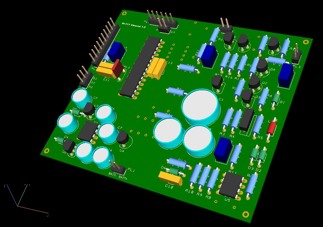

                        • Last one
                          IMHO I think this is now good enough to create a prototype.
                          Latest ECO:
                          1. Moved PC1 net to junction of R25 and R27.
                          2. Changed value of C1 on schematic to 4700uF. Value was lost during last update.
                          3. Recreated copper pour using thermal pads. During the last update the copper pour areas were deleted and redrawn. Some of the properties were removed during the process.
                          4. Moved C10 closer to PC0 on the ATMega8.
                          5. Decreased pin spacing on C11 and C12 to 0.2".
                          Given the small size of this PCB, with thick tracks and wide spacing, I would expect this layout to be relatively noise free. I do not have the time (or inclination) to drastically change the layout at this time.
                          Please keep us updated with your progress on this project. We will expect lots of photos and test results.

                            Qiaozhi what program did you make that layout with ?
                            • Originally posted by barry View Post
                              Easy-PC PCB Design Software is a cost effective, easy-to-use Schematic Capture and PCB Design Software
