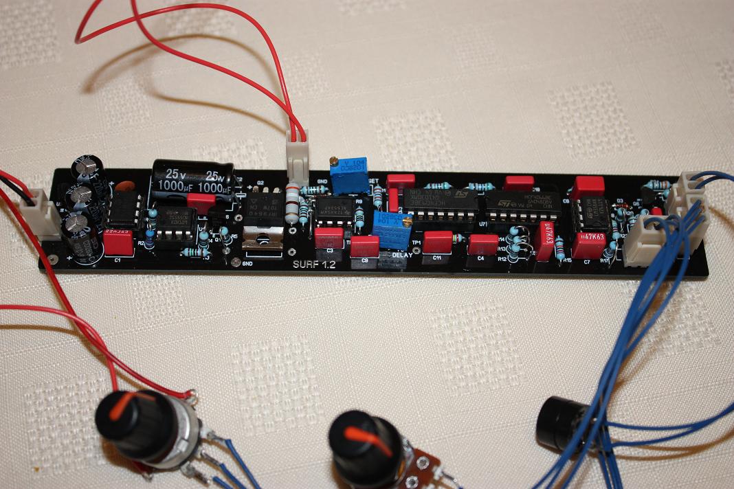

            • Finished populating the board!
              The two kits came today in the mail... I just finished populating the 1st board, Surf 1.2 kit... Wasn't getting any sound or anything when I hooked up the battery, however, when the coil leads were touched together, I got a tone! I'm psyched... Seems to be working... Now, next step... Gotta make a coil, and after that, make external pots! Thanks Silverdog!

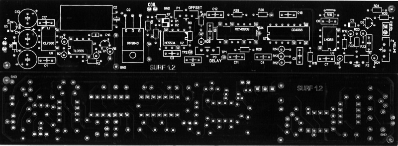

              • Surf Pi Back in Stock and improved
                More boards arrived today, with a corrected silkscreen for R18 / R22
                Kits will now include;
                All metal film resistors
                All Wima Mks2 polyester caps
                Molex type connectors for battery, coil, speaker, tune and volume pots
                A 1k external pot with switch for on/off and volume control
                A 10k external pot for tune
                happy hunting
                Silverdog

                    • NEW Surf Pi Kits
                      I put together one of the new kits as I had picked up a cheap Whites Surfmaster Pulse coil on ebay - not sure if the new parts make a difference but I think they look nice
                      This baby is coming on holiday with me this year

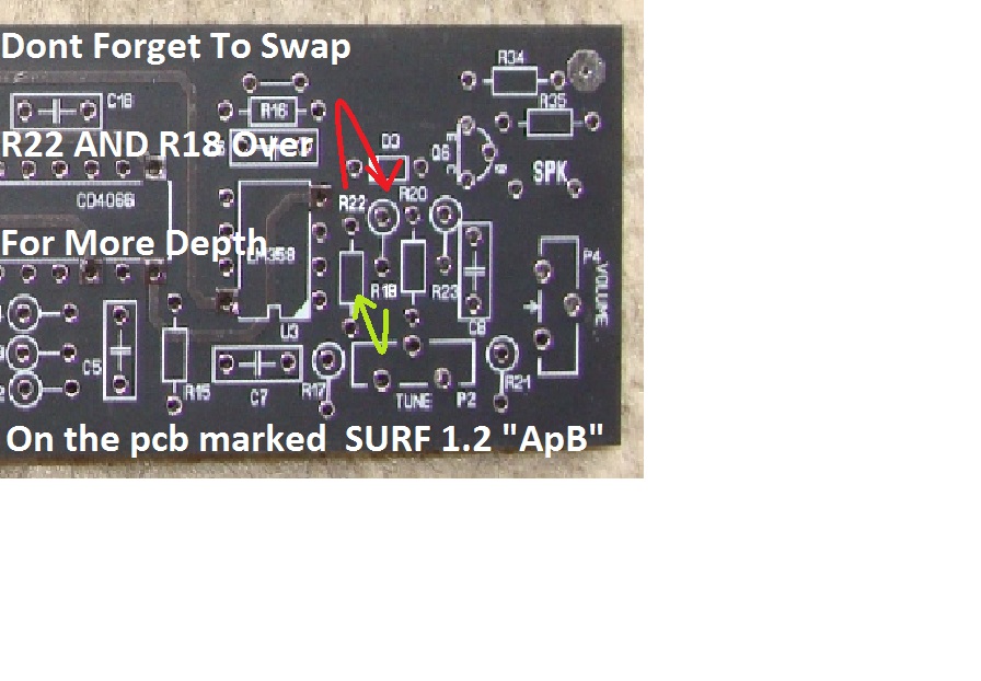

                      • Older Surf mod
                        For those who havnt read every thread entry here..
                        There was a minor error on SURF 1.2 "ApB" pcb
                        (NOT THE CURRENT 2012 pcb labelled SURF 1.2)
                        This is what you do for a little more depth.
