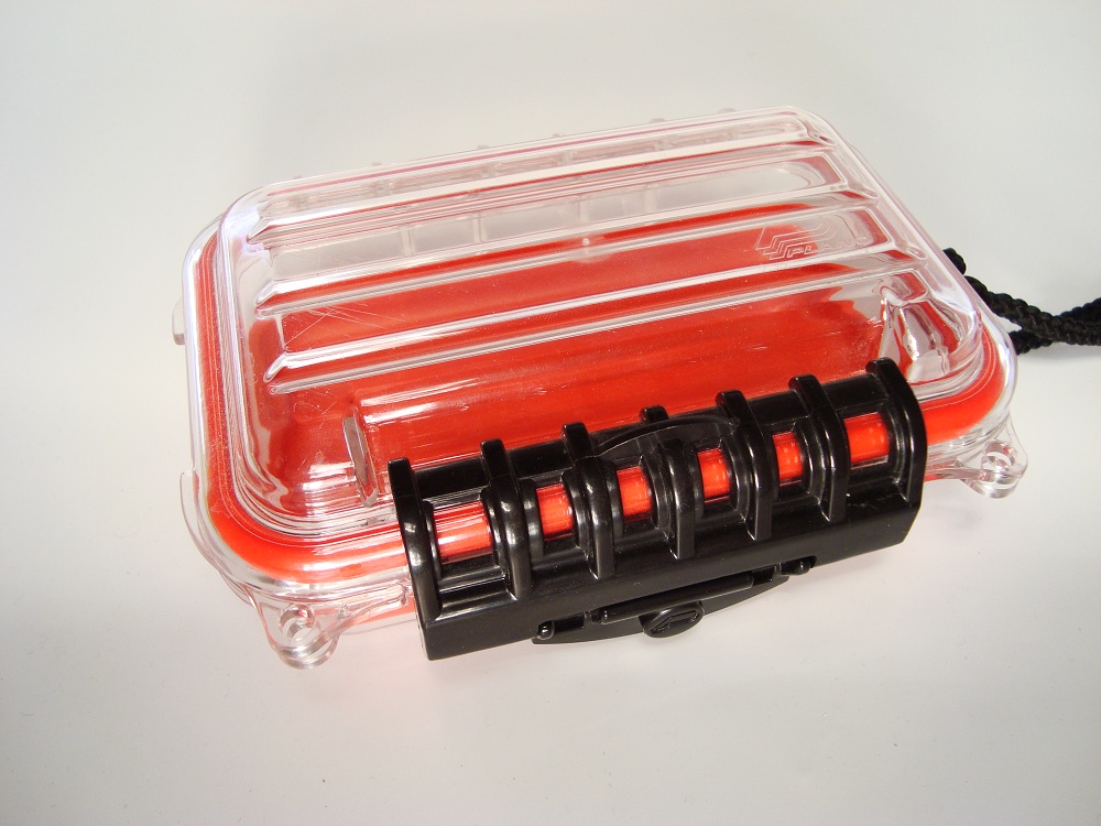

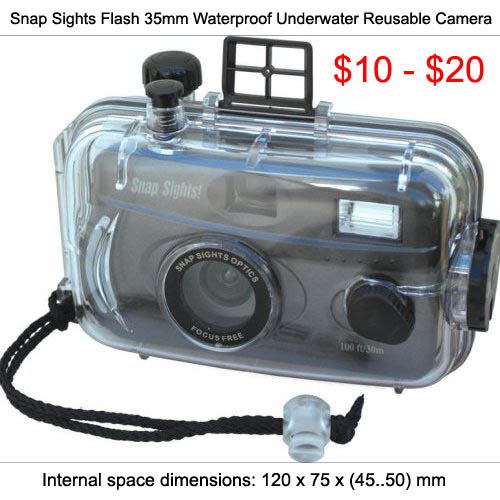

            • UNDERWATER SURF PI CASE. I hope to see "rectangular" version of Longboard kit for Surf PI
              I have already assembled two Surf PI metal detectors using waterproof boxes
              from film photo cameras to use it UNDERWATER.
              Nobody wants film cameras now so it is cheap to buy. For example $13
              in Walmart or even cheaper on eBay:
              http://www.ebay.com/sch/i.html?_nkw=Snap+Sights+CAMERA (from $5 for Waterproof box only)
              It is REUSABLE Waterproof box that can withstand water pressure up to 100feet (30 meters)
              You can open and close box easy and it is reliable because of O-ring and good plastic.
              I am using such box for my Surf PI last two years (over 1000 hours) of searching
              in salt water and very satisfied with it.
              In addition I am using rubber bands to keep halves together to protect it from accidental leaks
              because if wave hits your detector very hard lock may fail and water gets it. (It was once) Also I am using corn oil to lubricate O-ring. It works.
              I recommend to use SNAP SIGHTS SS01 because it is bigger
              and fits 8-AA battery case but smaller SNAP SIGHTS SS02 (no flash)
              works for me too because it fits 3 Li-Ion 18650 rechargeable batteries 3.7V
              from broken laptop. In full charge it gives me 4.18V each or 12.54V. It lasts 20 hours or even more
              and has 3.8V after such use or 11.4V Charger for 18650 costs few dollars on eBay.
              So I am saving lots of $$$$$$$$ on batteries.

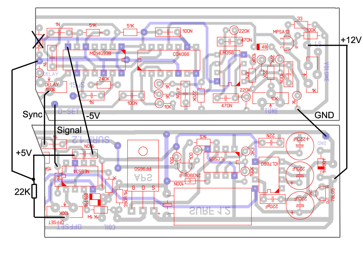

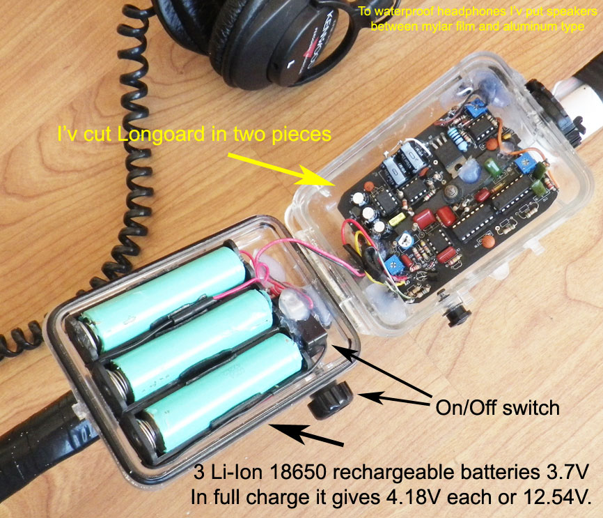

              I HAVE ONLY ONE PROBLEM: LONGBOARD DOES NOT FIT TO SUCH BOXES.
              So I have to cut it then connect pieces you can see how on the diagram.
              !!! PLEASE REFER TO YOUR VERSION OF LONGBOARD AND CHECK ALL CONNECTIONS !!!
              Because some Longboard versions are different and you may end up in smoke shorting power supply.
              BETTER SOLUTION IS ask our BEST FRIEND Silverdog to make "rectangular" version
              of longboard to let it fit such magnificent waterproof boxes.
              Good Luck!

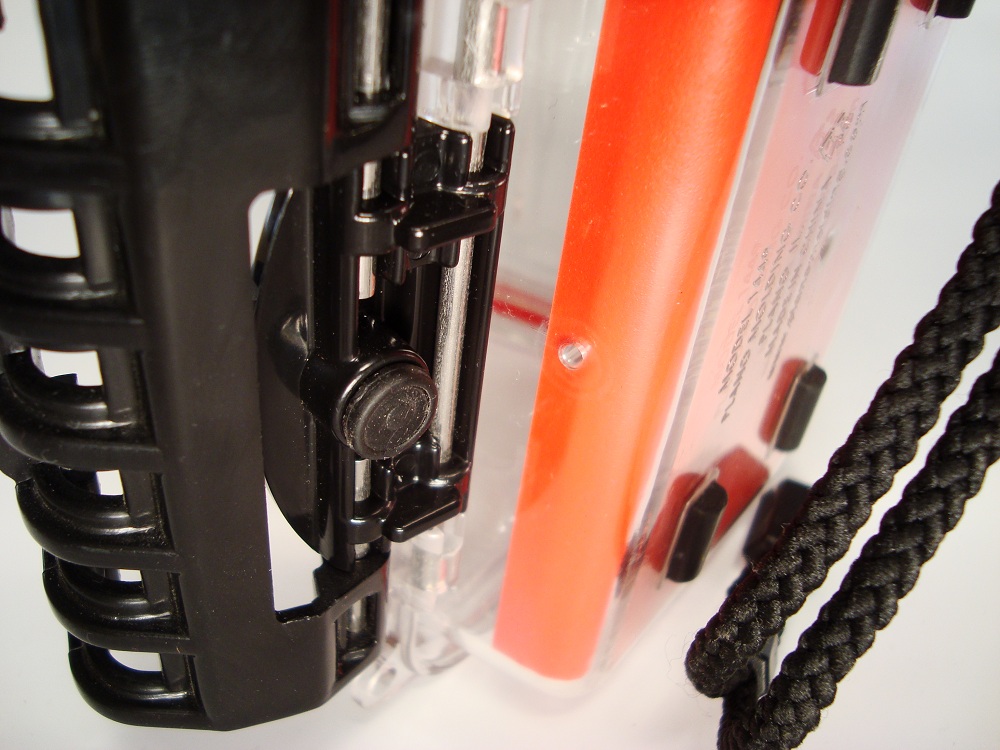

                I picked up one of these waterproof boxes from Walmart that I plan on using for a MD project. The inside dimensions are approx 130mm x 80mm.
                If you look in the second picture you will see there is a small vent to release the pressure when you open it. I prefer that it was not there but I guess it's not the end of the world, just make sure it's clean when you snap it shut. It even came with a spare rubber plug which I might have misplaced already. (I put it in a spot where I would not lose it.)
                They also have larger sizes.
                This one weighs approx 230 grams, without the red liners.

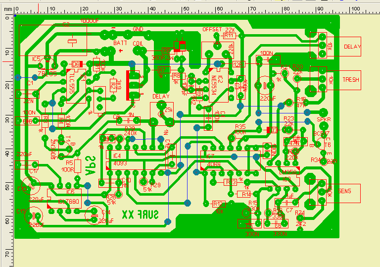

                • UFO:
                  Actually the longboard is cool for putting into tubes etc, but I was surprised that there was not the regular shaped board as well.
                  ... made some 'normal' board in Sprint Layout ...the last after Carl gave the Whites Surf Pro schematic on this board.
                  Have not made it for real, only as pcb Sprint file, so there can be errors in it !! The potentiometers can work inverse.. there is a extra potentiometer near the 555 and a extra preset delay
                  If somebody can check it.. ?
                  Best regards
                  Ap

                      Thank you so much ApBerg for Layout update!
                      I will try to check this layout. I hope to see it "in production" some day.
                      Did you named this version yet? :-) Longboard is a famous brand this one will be too.
                      Also I can see Sensitivity pot in this layout.
                      It looks important and makes it superior to Longboard.

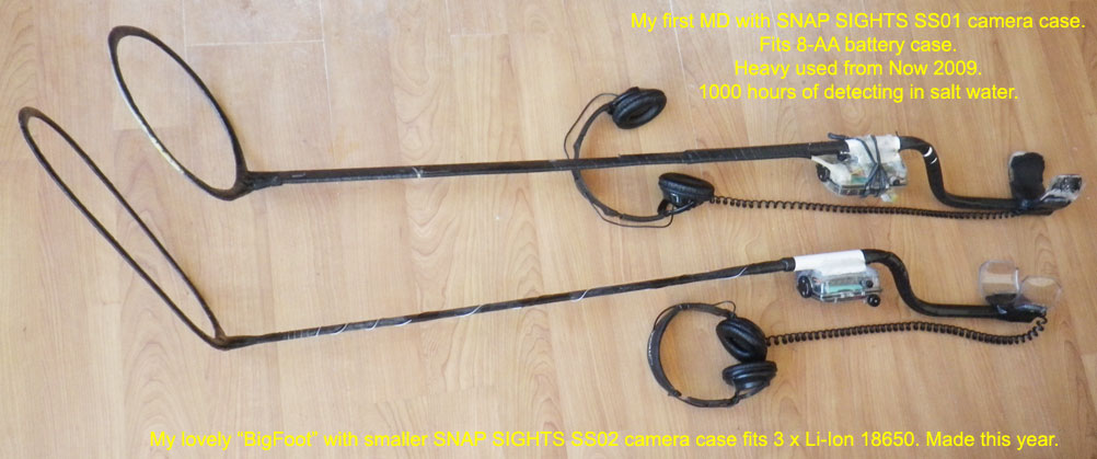

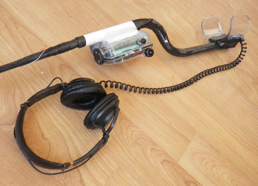

                      Below I am glad to present my MD's in SNAP SIGHTS UNDERWATER film camera cases I am using from 2009.
                      First MD has been assembled even without PCB. I have used Radioshak Prototyping board.
                      I second MD I'v cut Longboard in two pieces.

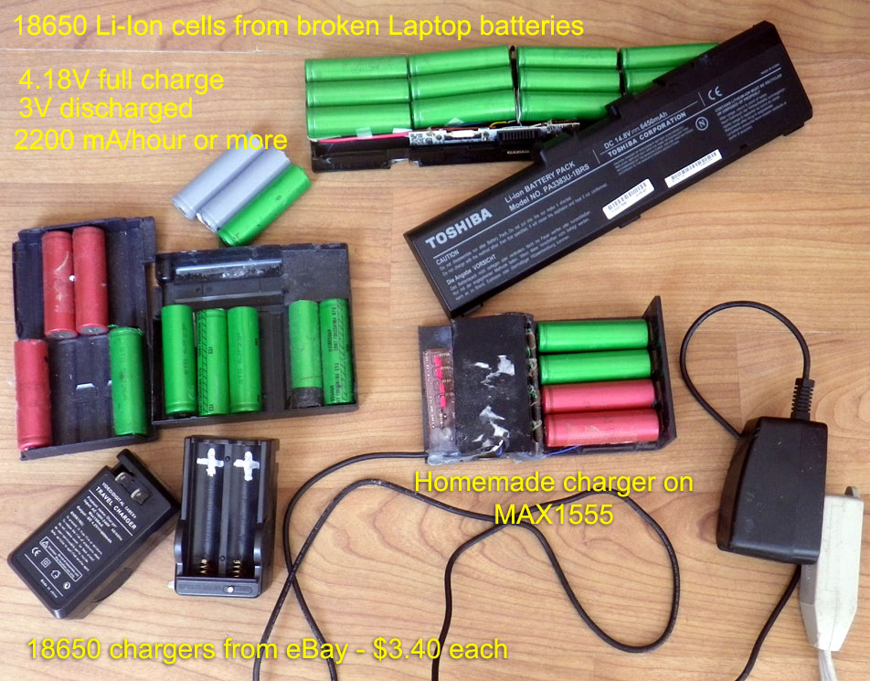

                      • Laptop batteries
                        I noticed you used Lithion laptop batterys. I was thinking of doing this exact thing. How much time do you get with your detector with these fully charged?
                        • Li-Ion 18650 rechargeable batteries 3.7V should be a STANDART for 12V power supply for MD
                          3 cells of 18650 3.7V rechargeable batteries In full charge will give 4.18V each or 12.54V.
                          Also it has approx 2200 mA/h capacity that is close to regular alkaline AA.
                          Some new 18650 advertised to have 3800 mA/h or more.
                          3 cells of 18650 takes much less space and weight much less then 8 AA pack.
                          Also it costs you nothing because you can charge it 500 times and have LIMITLESS
                          source of it from broken laptop computers. Or you can just buy such cells for $2-3
                          on eBay.
                          Chargers are cheap too: http://www.ebay.com/sch/i.html?_nkw=18650
                          I have purchased two for $3.40 each. Last year I have assembled my own charger
                          with using MAX1555 IC. But chargers from China looks cheaper and easier to buy.

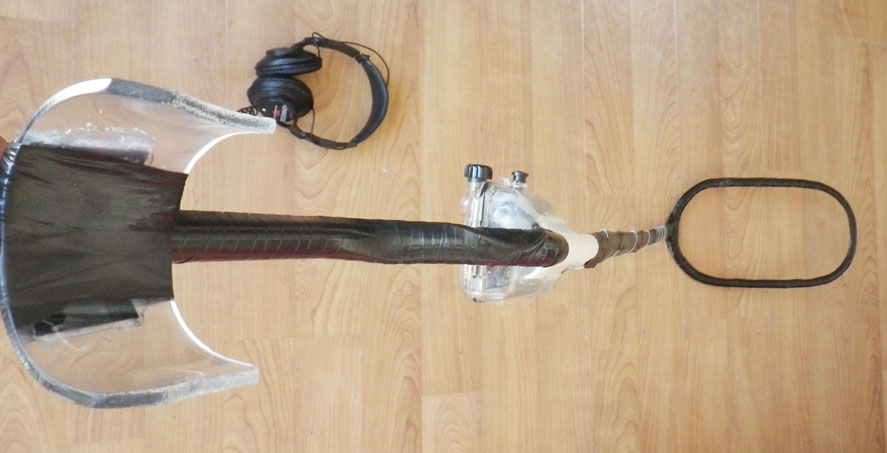

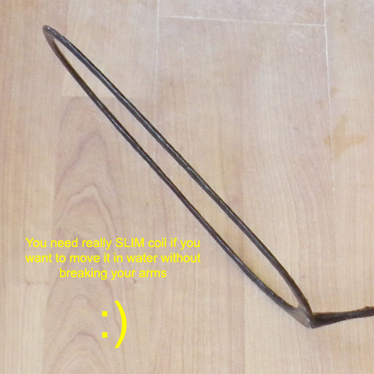

                              Wire: AWG 24 or AWG 26, Teflon or PVC insulated, stranded.
                              Turns: 18 or 20 or 22 (18 for bigger coils, 22 for smaller coils) Everything will work
                              from 240 mH to 350 mH inductance, just need proper dumping resistor.
                              Coil assembly: coil covered by several layers of fiberglass, just like surfboard but no air or foam inside.
                              Headphones waterproofing: I have purchased mylar blanket from WalMart and Aluminum Foil Tape for waterproofing appliances. Aluminum Foil Tape looks like scotch roll, it is sticky and smells like gasoline or patches for bicycle tires.
                              I put speaker on mylar film face down then cover it with piece of Aluminum Foil Tape (put a few drops of sealant on wires to stop water going along speaker wires) Aluminum Foil Tape will stick to mylar to seal the speaker. You will have an envelope with one side mylar (front of speaker) and another side - Aluminum Foil Tape (back of speaker). May be it is good idea to paint Aluminum Foil Tape side to prevent corrosion. Keep mylar metalized side inside or water will corrode aluminum from mylar film. Use ohmmeter to check what side of mylar is metalized. Insulate connection points on the speaker from Aluminum Foil Tape or it will short the speaker. I am using Hot Glue to seal wires where two speakers connected together and spiral phone extension cord.
                              Waterproof cables: I am using big amount of Hot Glue to seal cables coming to the box inside and outside.
                              To make a stem I have bend PVC plastic pipe by heating it on gas burner.
                              I have checked that Surf PI is very stable if properly assembled so you do not need any pots outside just Turn ON/OFF switch and adjusted once it will work for years with the same settings.
